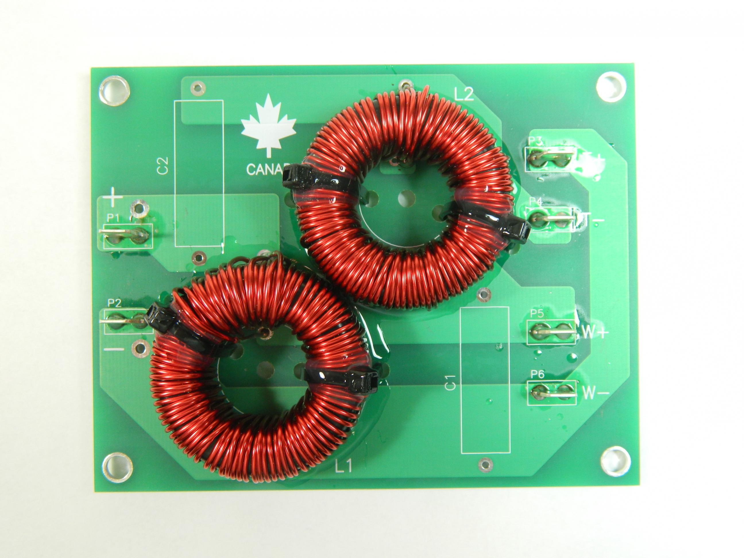

I try to use toroid inductors for speaker crossover because I can make them by myself here in Canada. I would like to know your opinions when using toroid inductors for speaker crossover. The board and toroid inductors are made by me here in Canada.

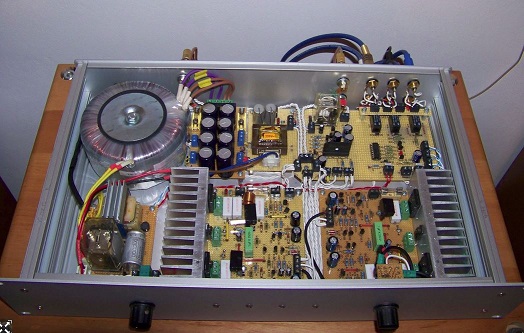

Toroidal Coils actually have a very illustrious history:
637641d1506556783-dynaudio-identification-help-required-randy-slone-amplifier-jpg
Here used in a power supply. The thing top left.
This is what we call a transformer, or more accurately, an impedance converter. 250V AC being converted down to about 50V by what we know as a turns ratio, then rectified into DC by a diode bridge.

What's the core material? In my limited experience of creating inductors for XOs, I needed an air gap when using ferrite to get the target inductance with manageable diameter wire. I know that toroids exist which have air gaps but haven't any experience with them.

Not to be snarky, but an air core toroid is probably a nonsequitur, or at least wildly inefficient. The magnetically permeable core is the only thing that allows you to bend the coil into a circle (and also concentrates the magnetic field in that loop so as to not interact much with nearby objects)
Air gap and air core are certainly two very different things 😉
Avoiding saturation would be my greatest concern, and I too have no experience with air-gapped toroids. Are such things even widely available?
That's a really pretty board. Is that about the same inductance for both crossover sections, though? Usually it doesn't work out that way, with the difference in input and output impedance.
Hi Rick,

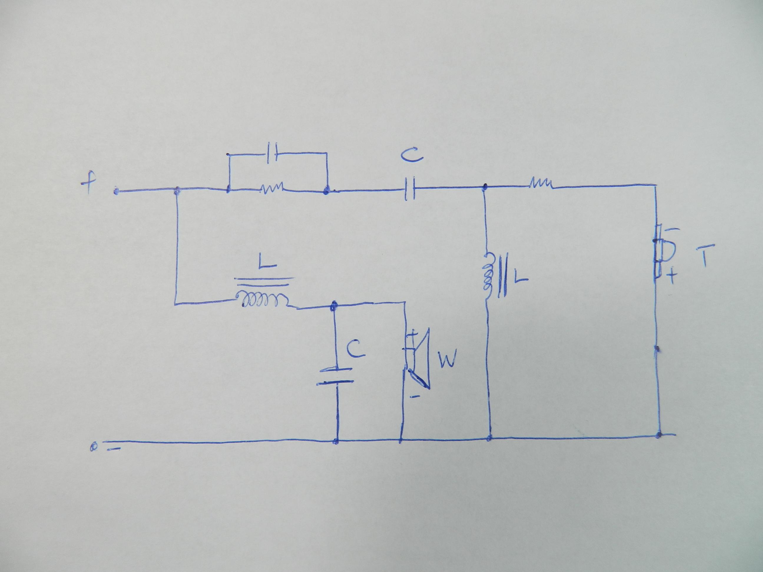

I use exactly same inductors (inductance and DC resistance) and same capacitors for both crossover sections. I would like to know if it works when woofer and tweeter have the same impedance (8 Ohm). I recently have replaced a crossover network of one two way speaker with this crossover network. I like the sound of speaker with new crossover network. That is the sound i am looking for (for more than 30 years). I have the idea because i don't like the sound of the speaker with original crossover network.

Hi tuantran,
Theory certainly matters a lot more to some of us than others!😉 (And yes, I'm too often guilty of diving in where its too deep for my own good.)
But hey -- if you got the sound you want, finally(!) after chasing it for 30 years (!!) -- you might just save studying the theory for another project ...:cheers:
The one bit of it that deserves mention, though: A few too many of the formula are calculated for matching impedance in and out. They ignore the component value changes necessary when the music is coming from a very stiff voltage source.
Still, glad you're happy with it,
Rick
