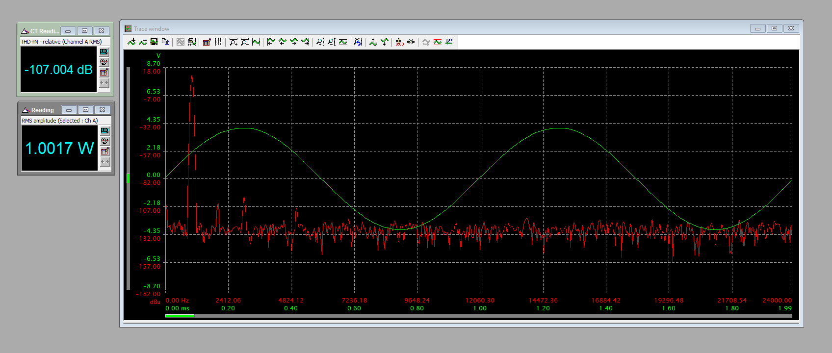

I made my own system with DAC/DSP and amps for active speakers. But sounds amazing if connected to passive speakers as well. But much better connected driver direct and doing a DSP crossover.
Here’s the 1w/1khz/4R THD+N of the entire system with DAC and DSP in the signal path.
Haha - you posted that, what, 7 times in this short thread :-D
I completely agree on your system view btw.

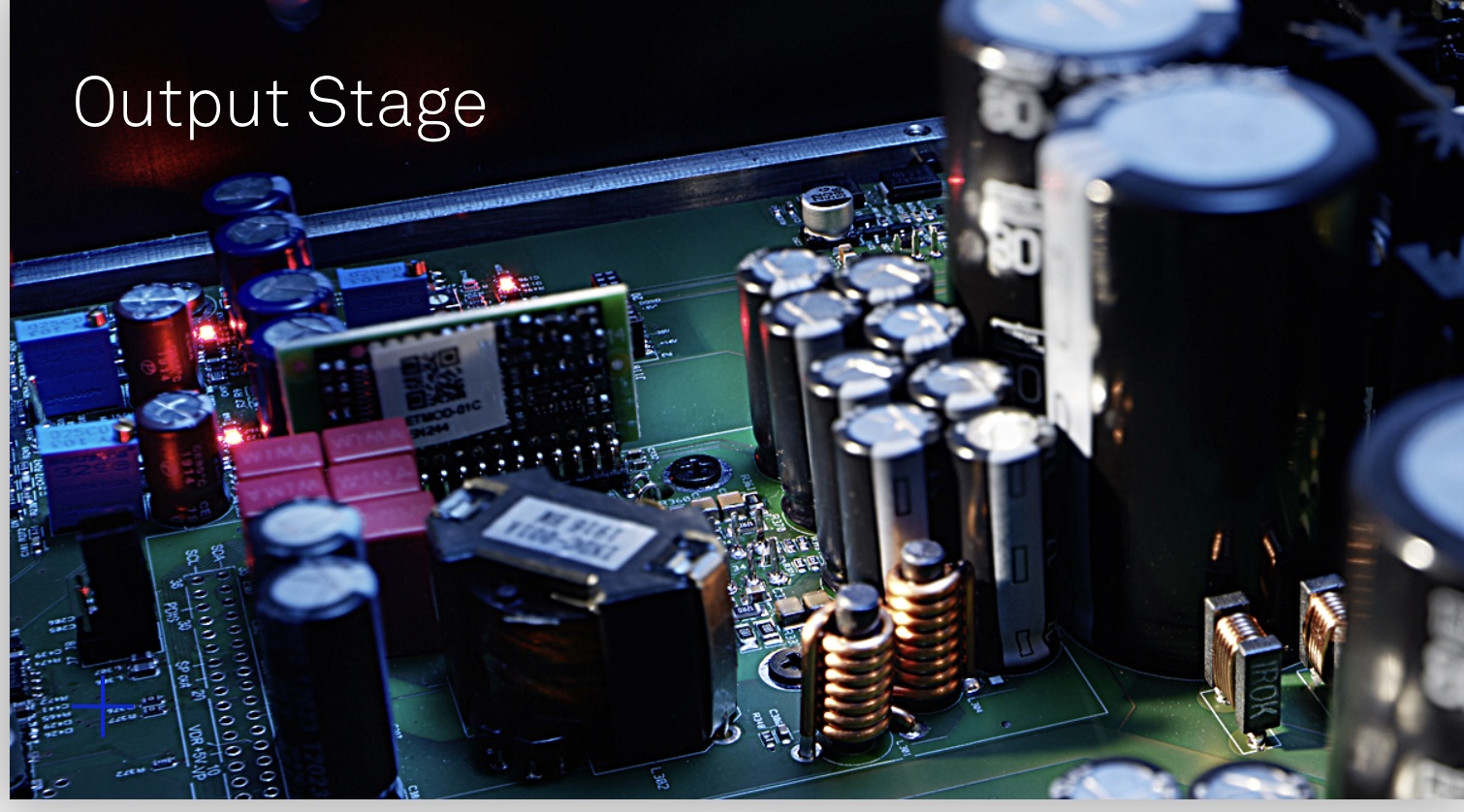

The DAC is amazing. And when the signal from the DAC output only needs to travel a few cm over PCB traces you get to hear what the Purifi amps can do. I also have separate extreme low noise supplies for the Modulator board on the Purifi amp, as well as the 5v digital.
Once I’m ready for huge volume orders I’m going to licence the Purifi IP and build the modules right into the same PCB like T&A has done.
