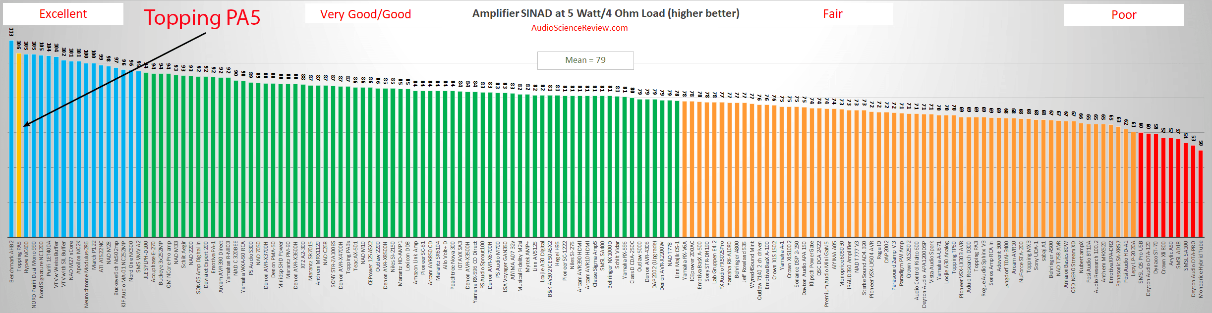

Of course which is why that list is a total sham. Certainly not an educational forum. Over there they’re taught that you just need to know 1 number to know what’s best. Keep it simple, this way you attract simple minded people.
You re correct... take a look at the Amplifier Sinad list from ASR :
Amplifier SINAD list ASR + 3rd parties - Google Sheets
We only consider the THD+N 5W / 4R as a point of reference ...
This puts the Orchard Starkrimson Ultra for example @ the 34st rank ! While the manufacturer's measurements have never been considered on ASR strangely ....
Yes but 95% of the readers only look at the 5W/1khz SINAD number. They don’t look beyond that when making their purchase decision. It’s clear by the comments after all the reviews. By doing this companies like Topping only need to tune their amps to have a great number at this specific spec. And they take the lead on the list.

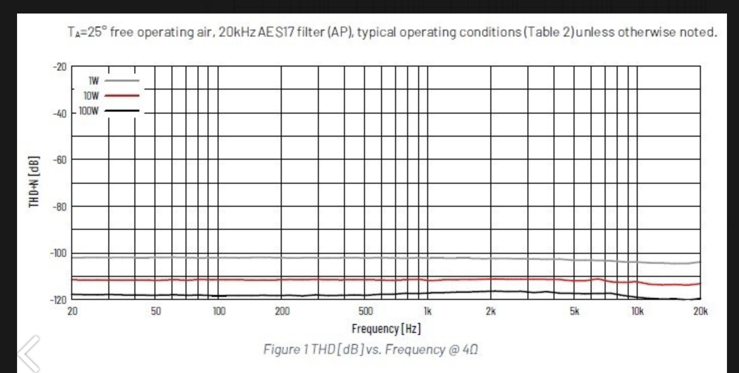

Only crappy class D. Here’s the Purifi THD+N vs power vs frequency
That's not apples-apples though. Says right there on the chart that it's using a 20kHz measurement bandwidth, whereas the ASR tests are at either 45 or 90kHz. The ASR test of the Purifi at 90kHz bandwidth shows rising THD+N above 5kHz as well.
https://www.audiosciencereview.com/...quency-vs-power-audio-measurements-png.28865/
The Purifi does do significantly better - particularly considering that the Topping was measured at 45kHz - but your position seems to be "if it isn't as good as the Purifi it's a worthless piece of crap" which is ridiculous.
Rising THD+N with a wide bandwidth out of the range of human hearing gives a flawed result when measuring class D amps. Because the harmonics that cause the rise in distortion are out of the band of human hearing.
I’m not saying it’s total crap, but certainly not the 2nd best amp in the world. Like I said earlier, slightly better than the $35 Icepower 100AS2 amp based on the same class D chip.
It really is too bad that "1kHz SINAD" seems to have been adopted as a singular figure of merit. I think ASRs tests are good, but are definitely undermined by resorting to that ranking.
IMHO any 'figure of merit' is an oversimplification, but of all the ASR tests I think the multi-tone IMD is the best 'single chart' test. It hasn't been done for all devices though, and given that it's a chart over frequency it doesn't lend itself to distilling down to a single 'figure of merit' for ranking purposes. He didn't run that test for the Purifi, which is too bad - I'd expect it would have aced it.
Well, you can't really have it both ways - criticize the amp for a measurement showing rising THD+N over 5kHz and then turn around and claim it's a meaningless test.Rising THD+N with a wide bandwidth out of the range of human hearing gives a flawed result when measuring class D amps. Because the harmonics that cause the rise in distortion are out of the band of human hearing.
Well. First, the PA5 is ~10dB better in THD+N which would seem to be a bit better than 'slightly' - the Purifi doesn't beat the Topping by much more than that in 1kHz THD (ignoring N). Second, the 100AS2 is $70+ each qty 20, or $155 for a single piece, and you still have to add a case and associated hardware. https://icepower.dk/buy/as-series/100as2/ . Maybe the price plummets in production quantities, but that's not particularly relevant to this audience - You'd be in the same price ballpark for a finished unit.
I get your main point - the Topping isn't the 2nd best amp in the world, and I don't disagree. It does seem to be a real step forward for budget amps though.
Lars explained the test to use earlier in this thread. 2 tone at 18/19khz. One I do myself is a THD+N 2 tone with 1 tone @ 1khz, and 1 @ 15khz. Then compare with a single tone at kHz. The difference in the results shows the contribution to in band noise and distortion caused by the 15khz tone.
