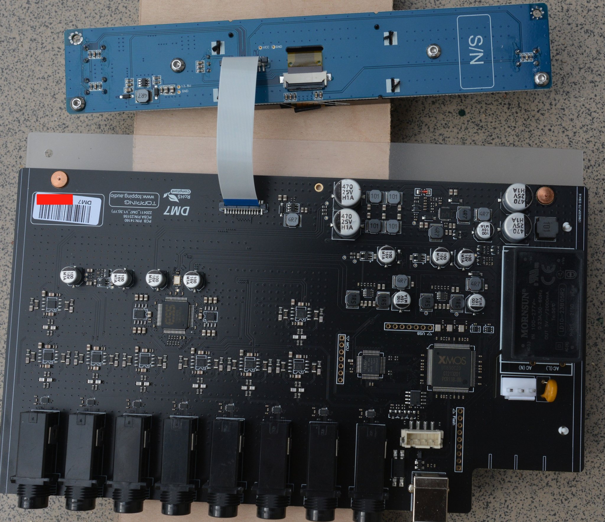

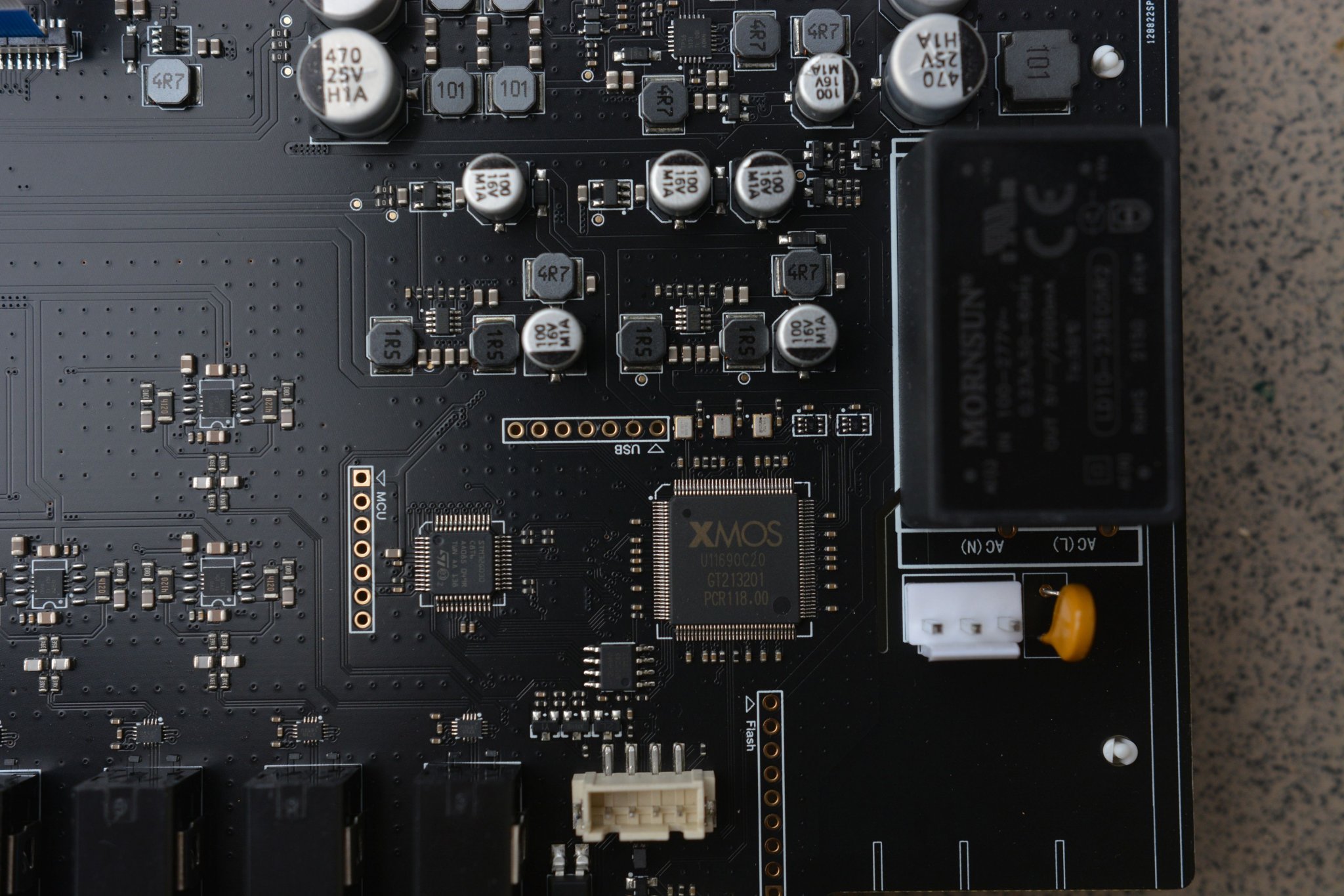

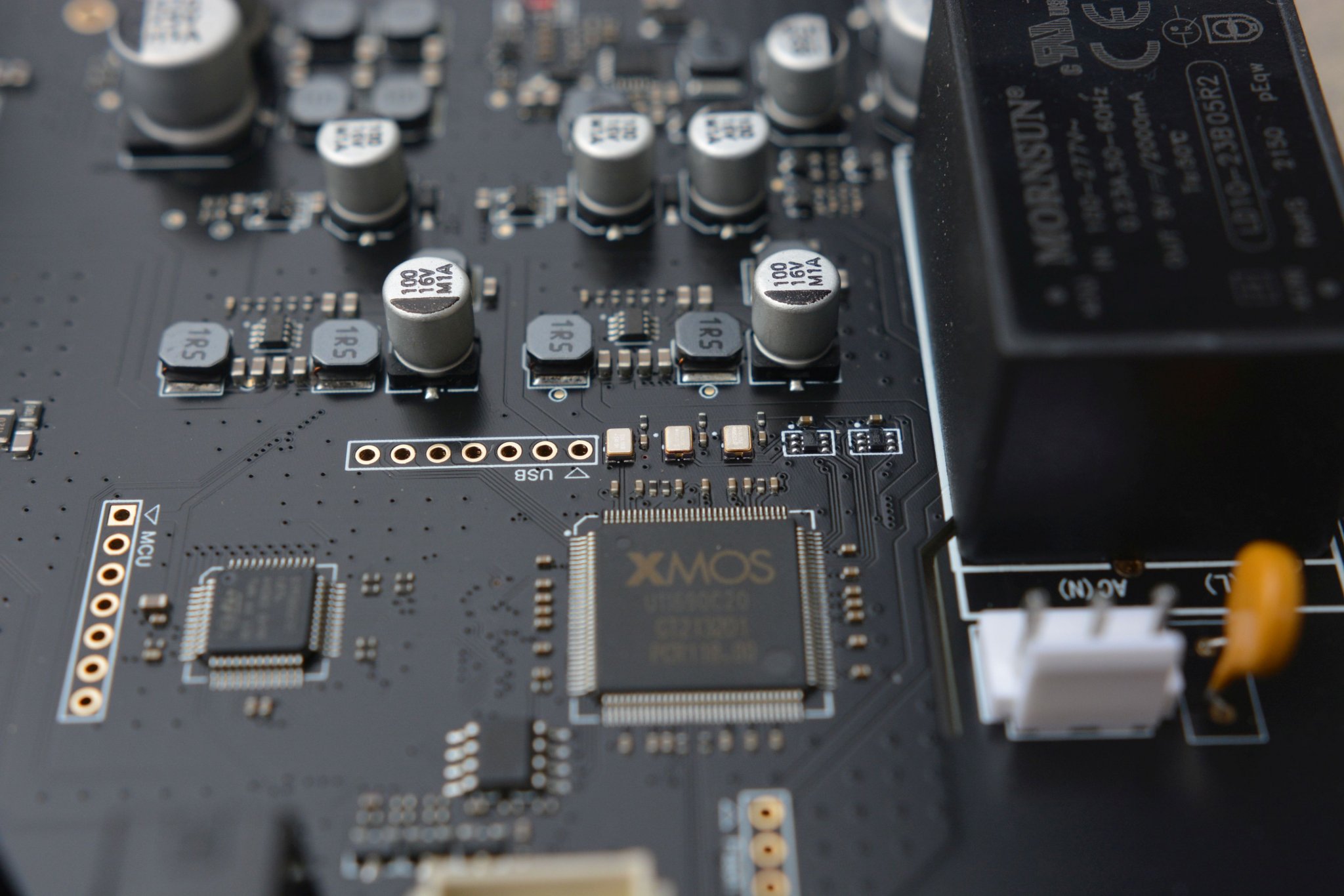

Hi, photos of pcb attached ... if any one interested 🙂
my plan is to use it as car audio DSP (together with RPI/CamillaDSP).
good thing is that it's powered from 5V DC (MORNSUN AC/DC converter) so it might be easy to implement it;
but i need more channels. what do you think about sourcing external mclk (to chain two or more boards together with common MCLK)? but those crystals are so small - wayyy over my soldering skills 🙂

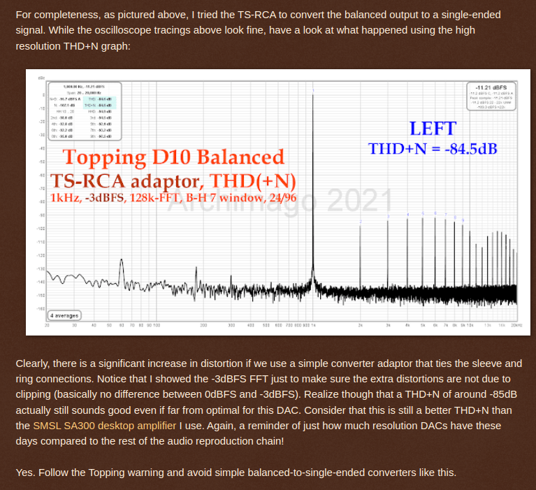

kazap's result represents a ~50dB degradation against specified THD for the D10B's ES9038Q2M chip. Would that be normal expectation? Nearest I could find is an ASR forum contribution of a Genelec internal DAC measurement using the same chip in voltage mode showing roughly the same low harmonic levels without all the higher harmonics.
https://www.audiosciencereview.com/...urements-of-generic-es9038q2m-dac-board.2408/
FWIW, archimago did the measurements with an incorrect tip-ring shorting adapter below, which look much closer to kazap's.
http://archimago.blogspot.com/2021/08/measurements-topping-d10-balanced-d10b.html
