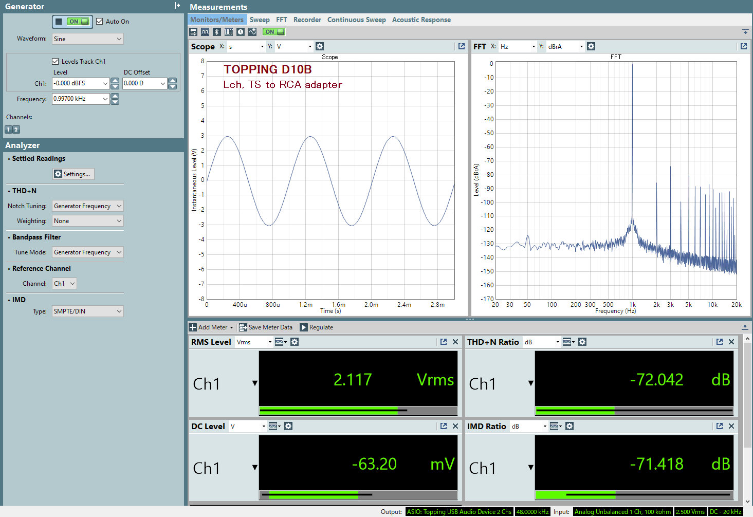

How can someone write a piece of analysis software like that - and not put its name on any of the panels it puts up? Now I have to go through a whole ask and hope for a response cycle to find out what it is, instead of just looking it up myself .and doesn't do well
Nope. Dont bother. The analysis and problem was with an earlier Topping balanced DAC. Its just a potential warning for early buyers who have RCA only amps and dont have a multi channel preamp with balance in to unbalanced out. Its possible the topology has been improved with this new model. Wait and see.Now I have to go through a whole .....

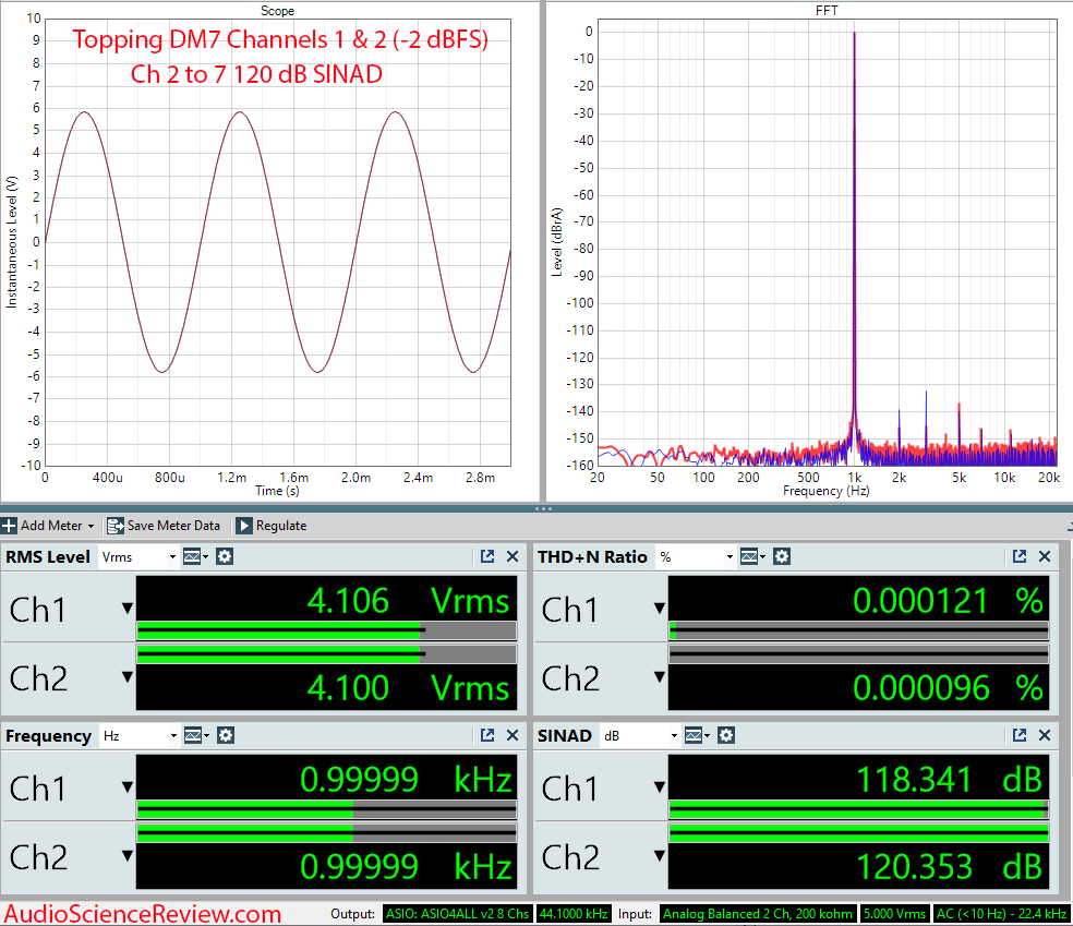

Herę it is ...Audiosciencereview...Nope. Dont bother. The analysis and problem was with an earlier Topping balanced DAC. Its just a potential warning for early buyers who have RCA only amps and dont have a multi channel preamp with balance in to unbalanced out. Its possible the topology has been improved with this new model. Wait and see.
Audio Precision - not a DIY affordable product.the software used to show all those harmonics!
Thats not useful - its the known balanced in performance. The link was with the OP. The query is about single ended output. Many of us have single ended amps. Anyway this is likely to be not a problem with this new DAC. Topping should have moved on and SNR on RCA output will likely be shown to be OK before too long. It needs to be if going direct from DAC to power amp and using digital volume control.Herę it is
Topping DM7 only has balanced outputs. Topping balanced out in other DACs is a minimal parts design and doesn't do well single ended. If DM7 has the same compromised output stage Okto will still be laughing.

I have the Topping D10 balanced and can confirm that the analog output looks pretty much like the schematics shown in the AD1955 datasheet.Topping DM7 only has balanced outputs. Topping balanced out in other DACs is a minimal parts design and doesn't do well single ended. If DM7 has the same compromised output stage Okto will still be laughing.
Sure this is a minimalistic design, but in my opinion it can also be used single ended by just disregarding the inverting output. You may have ground loops then if you are unlucky.
The FFT plot you are showing looks terrible and I have never experienced anything like that with my Topping D10 balanced in single ended application. Probably the adaptor shorts the inverting output to ground forcing the op-amp into current limit or dissipation limit or some other issue. Topping advises to not use any adaptors, but get a DAC with single ended output instead. I guess this is just why.
The primitive balanced output gives you the option to do a proper low noise conversion to single ended on your own. The way Topping does it likely is like shown in the AD1955 datasheet and I‘m sure we all agree that this is not a high end solution.
