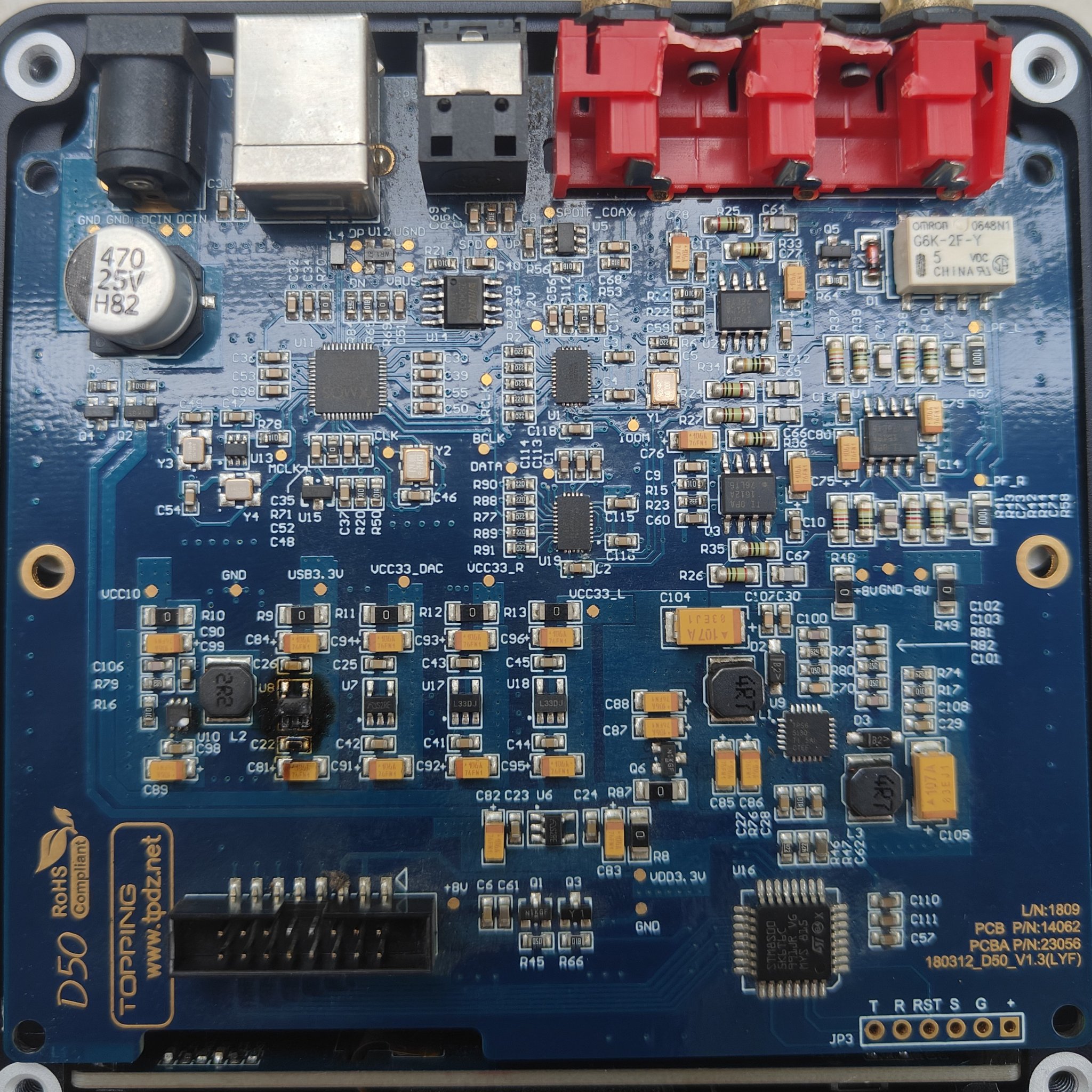

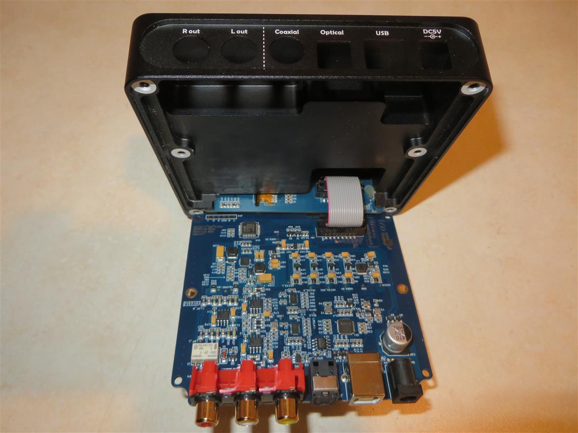

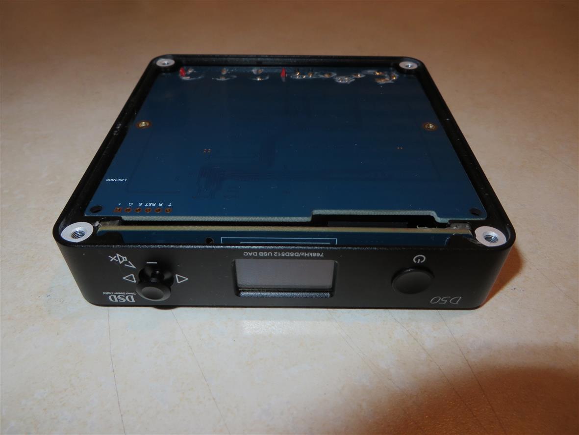

Topping D50 DAC does not power on
My Topping DAC D50 does not power on. I tried different USB charger 5V-1.0A and 2.0A.
Did anyone experience the same problem?
I hear it "click" on, but indicator light (display) does not light up. Has anyone any ideas how to get it working?
Thanks.

Guess its faulty then and there is nothing you can do to fix it by yourself

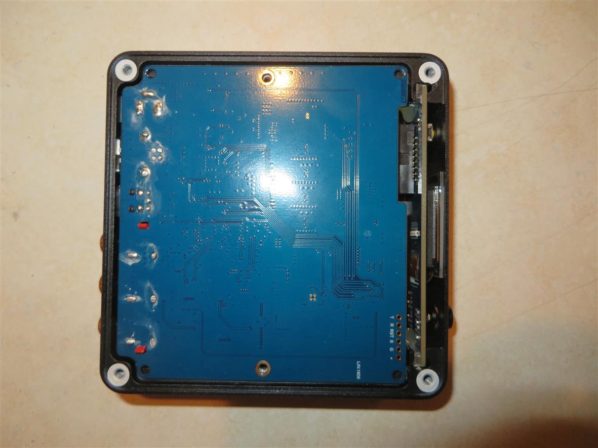

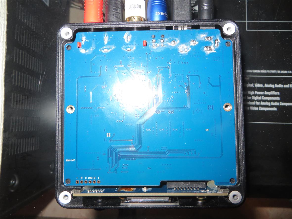

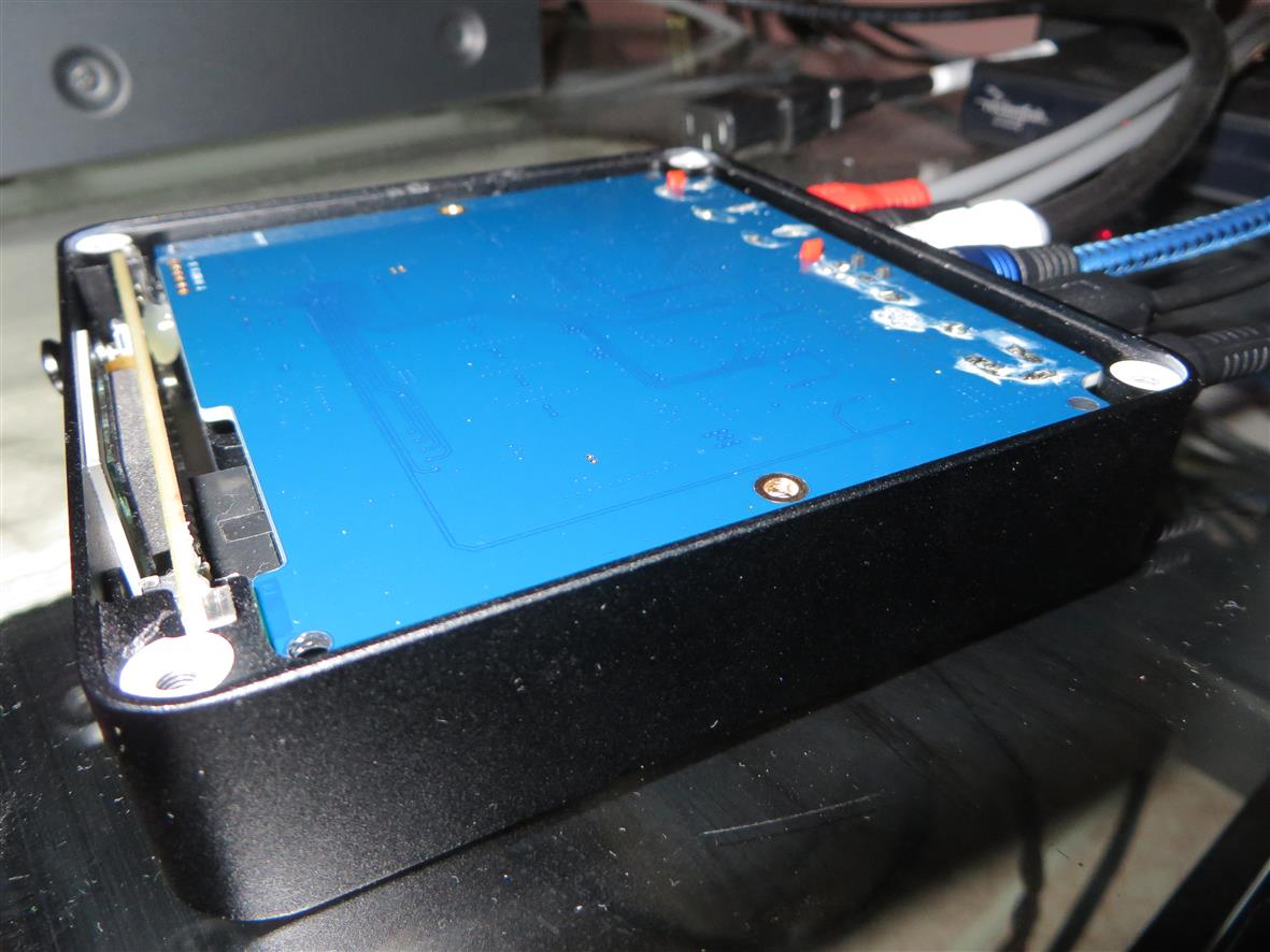

I was successful to get out sound of it however, the sound coming out is distort. Coaxial and optical both work. Display not working. I am not able to install the driver and doing a firmware update.
When I connect it to a PC via USB, it says: "USB Device Not Recognized". I believe it is a software problem. Maybe it can be fixed as long as I have access to the device via USB.
What do you think?

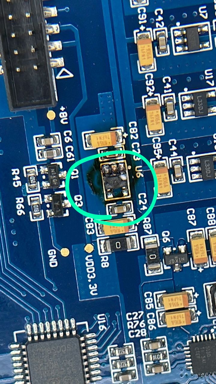

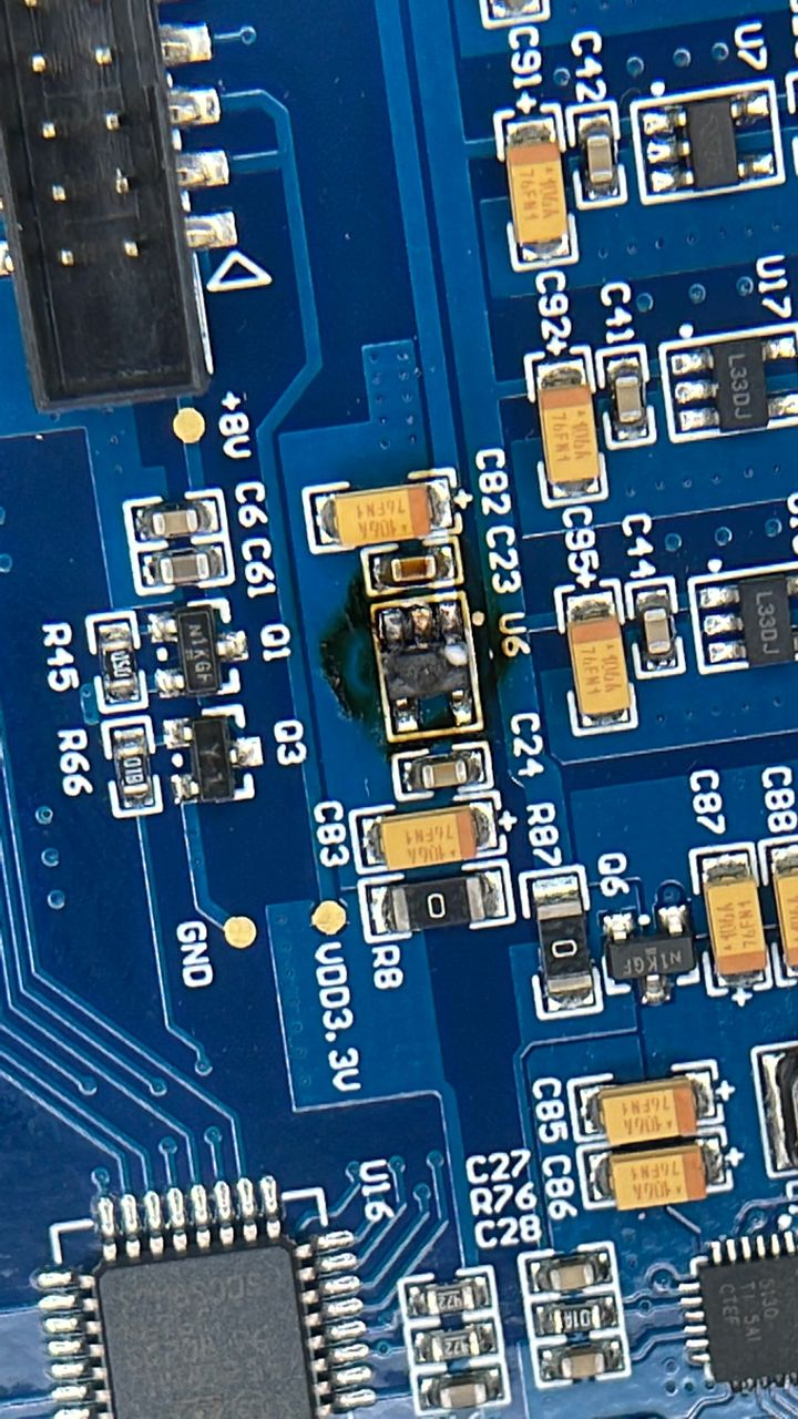

Hi all,
my topping d50 can’t power up and I open it , I saw an IC was burnt , doesn’t anyone know the IC number ? As I need to do the IC replacement.
MIC5205-3.3YM5 will work OK. Question is why it burnt. That R8 looks a short to GND but I may be wrong. I think you should measure output current to see what is happening. Also the input voltage is of importance. I also recommend to check tantalum cap C83. If that one is shorted inside you have the explanation.
When you remove the defective regulator (carefully and fast as the PCB has overheated) please clean the board ands check the PCB traces with the datasheet of MIC5205. That one typically has the 470 pF cap. These are known to die with too high input voltages but normally they just stop working. I suspect the tantalum cap to be of unknown/fake/cheap quality and an internal short.
Measure input voltage before you replace the regulator.
Hello everyone,
New here and new to the HiFi world. First disaster - I accidentally plugged in a 9V adaptor instead of a 5V and the D50 came up with Left: ERR and Right: ERR message on the screen. I opened to find a burnt IC. Grateful if some could please point me to the right part (number / ic) that i Would need to replace and if anything else needs to be noted to the shop doing the replacement. Many thanks!
