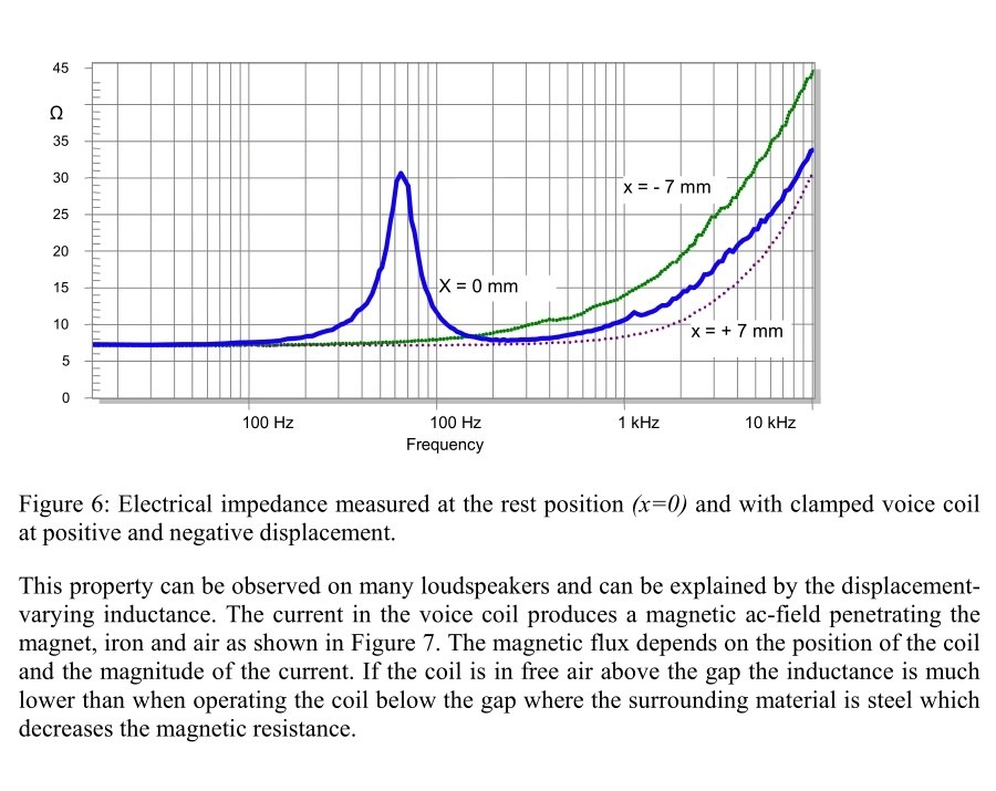

So am I generally, but my thinking here is to minimise this sort of thing (excerpt from a Klippel doc.) :I'm more inclined towards doing equivalent things with active dsp and eq;
So, at a few kHz the inductor presents several ohms of impedance in series -- the more the better -- and the variation becomes less significant because it's a smaller fraction of the total impedance.
So that would improve IMD in complex music signals where multiple frequencies are playing at the same time. But even if excessive displacement is prevented by box tuning, the bass can still pump high current, so that would be another source of impedance modulation and messy hysteresis effects.
You could take things further, and use a larger inductance together with an active filter to boost the treble back. A project that I've been psyching myself up to do (when not busy with life) is to build a current amplifier, or "mixed mode" (not 100% sure what topology yet and even just doing sims takes ages), so the impedance is emulated by the circuit.
But a 100W class D with 47 ohm in series may be quite hard to beat, especially if you already have EQ to fix the lumpy response.

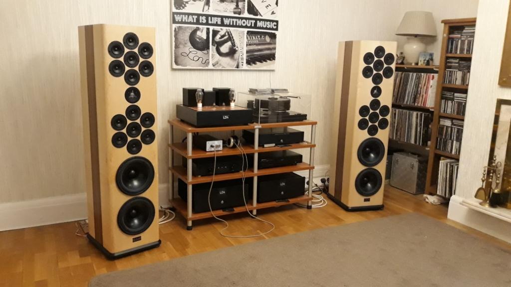

Of course, you could always do something like this. 😉
Pair of 10in Scan bass units, 14 x CHN-50 in twin hexagonal clusters forming an MTM with a beryllium dome tweeter.
Granted -it's not peanuts. And these aren't mine -they're a 'final' build by a friend who asked me to help him think of something interesting that would beat his Edingdale GTs (and after he & his good lady wife decided on the general approach from a dozen or so ideas kicked around, guess which mug then had a dinosaur's share of the design work 😉 ). They're not half bad though.
Ideally I'd have gone with the original intent of over-under woofers for a WMTMW configuration, but to put the tweeter at ear level the height would have started to completely dominate Colin's room, so he (rightly IMO) shifted to the MTMWW configuration to keep size manageable for his space. No point in building a speaker that you can't live with.

Scott, those look fairly unique! Though when I make my next big speakers, I want to try Geddes-like compression drivers in waveguides.
That crude, Tekton inpired way-to-big-spacing.
It did inspire this which could be interesting and workable:
http://wodendesign.com/downloads/CHN-40-array.pdf
dave
In my own defence, it depends on where the design priorities lie. The spacing to each cluster centre from the central tweeter is 1 wavelength, which assuming the theoretical ideal of 1/4 wavelength at the transition frequency is impractical for other performance reasons is one of the better compromises available in terms of response and polars. That's assuming the object is a pure point-source of course -in this case, the MTM with its small limit (and it's small in this design) on the vertical polars was desirable.

Indeed, although the considerable help of a 'certain person' who optimised the active bass section LP filter & EQ also has something to do with that. 😉 I can't imagine who it might have been, but he did a rather good job. You might even say Wilson Benesch could learn a bit from them.
It's an interesting aspect of the multi-driver midrange though, just as with arrays. With 14 x CHN-50 per channel, you've got a radiating surface roughly equivalent to an 11in driver through their BW, but with a greater number of coils to dissipate heat (on top of the other aspects).
