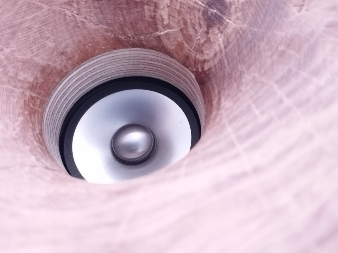

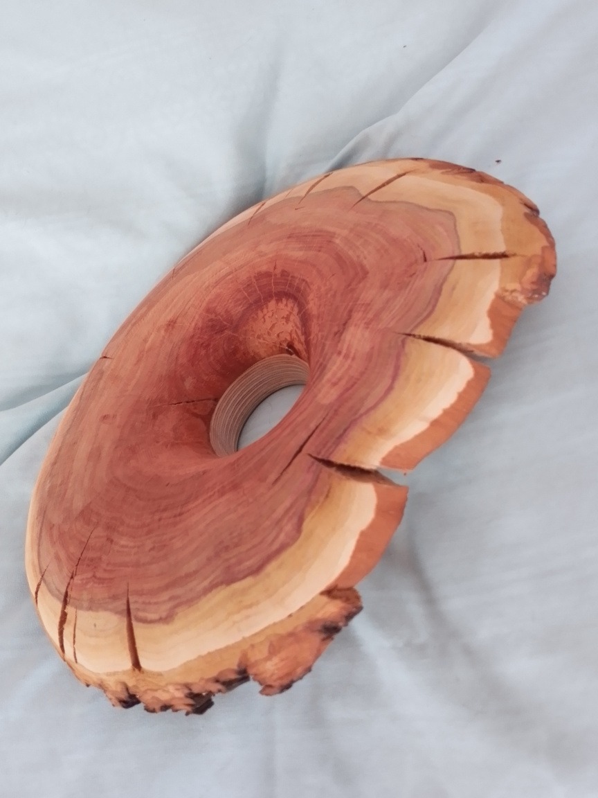

Beaming and your head casting shadows with the bigger drivers? My 5.3s are slightly boosted in "live edge" wave guides and have a gorgeous tone, but I still need to get round to equalizing them. The w.g. starts off conservatively with a steep, almost 90° throat angle, with a view to being able to widen the horn if necessary. But it'll be a nice day when that finally reaches the top of my list of things to do. The 12" woofers for bass support should be done by about Christmas. (We'll see if the Lavoce's can keep up at the estimated 1 kHz XO.)

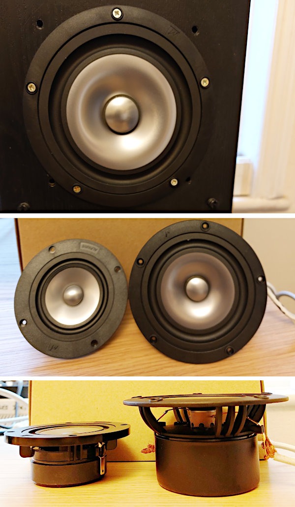

The 5ms (that I already like) have a hard cone diameter that is a smidge over 2", but the 7ms isn't exactly massive by comparison either, at slightly less than 3". Yet has a much bigger magnet, a more profiled cone (and the lower-profile bezzel, if that matters), and noticeably bigger displacement. So it is at least possible the 7ms will be the sweet spot that I'm personally looking for.
It also looks really quite small compared to the (slightly-over) 4" hard cone of the 11ms, and the response curve looks smoother too. So for use in a WAW of lowish crossover and modest SPL, at first glance the 7ms seems quite encouraging.
Whether I want to also tweeter-assist it (TAW+WAW?) remains to be found. But essentially I'm interested in a good uninterrupted and wide main frequency band, and already consider that to be a stretch, so I'm happy to supplement at either low or high end if required.
Just beginning to fiddle with this. But for interest thought I'd take a photo or two of the alpair's relative sizes. Top is the 11ms cone, at the same distance pictured below it are the 5.3ms and 7ms cones:
(click to enlarge)
The cone of the 7MS doesn't seem as much bigger (compared to the 5.3MS) as I was expecting, which is probably good in my case. Though the bottom picture shows that it has a substantially bigger body and magnet, so I can well believe it'll still dig a bit deeper and louder thsn the 5.3ms, which is my main reason for trying it.

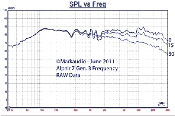

Ah, now we're getting somewhere. The issues seem to be somewhere between 7khz and 15khz, perhaps closer to the latter. There could be things going on higher as well, but beyond my hearing. If I attenuate the 12khz slider on my equaliser quite significantly (by several dB), and then apply a gently falling slope across the whole frequency range, things are much improved. The jingly sparkle thing doesn't annoy me any more. Toeing them in a bit also seems to help with smoothness.
That is obviously just a crude attempt; in time (when the drivers were in their final cabinet) I'd want to do proper measurements and much more targeted frequency tweaking. But it is enough to show that these will indeed work for me, which is all I needed to know at the moment.
So that is good news. I suspect things might still be improved with a tweeter, maybe above 8khz, which I shall likely also test at some point. But I wouldn't be unhappy without one, and might not think it worth the compromise and extra cost/complexity for some designs. If going there, probably I'd want a waveguide for it (to match directivity) and another amplifier in active systems, etc. so it would take a bit of effort to get right. The lack of a tweeter needing to be close to the mid-range also gives a few more options for the baffle around the 7MS - to more thoroughly counter edge diffraction etc.
Anyway, for now I'm liking how clear things like vocals, strings and pianos sound through the 7MS without any top end assistance. Looking forward to seeing how they sound when crossed to a woofer at around two or three hundred herts, but that might be quite some time away.
