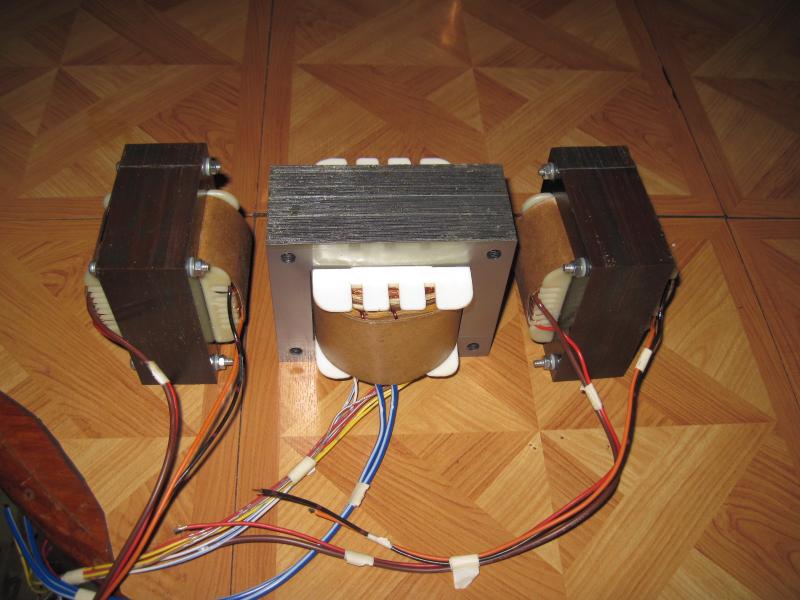

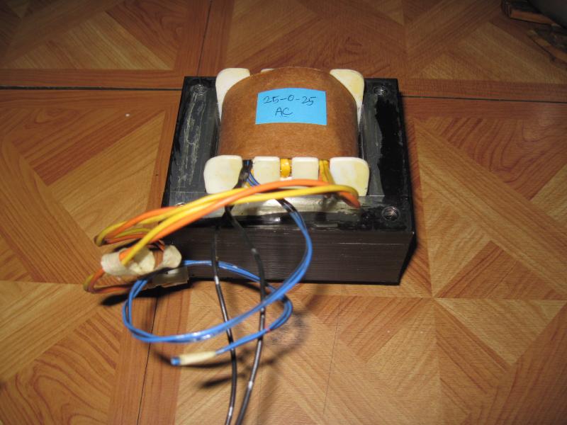

freshly baked traffos...
finished this in just a week....the hot Manila sun cures the varnish very quick...'D
left to right, traffos set for an upcoming 829b SET amp,
2 x 25 volts 270 va traffo for gainclone amp,

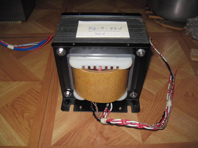

2 x 38 volts 500 va traffo for my 2nd honey badger build,
2 x 52 volts 750 va traffo for a 6 pair Leach Lo-TiM amp...

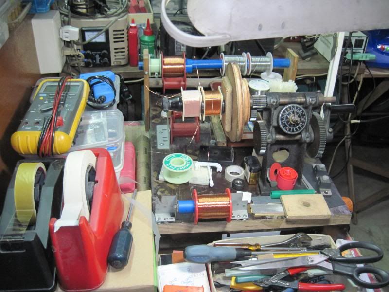

What is the largest wire diameter you have had to use winding trannies for audio purposes ?
Reason I ask is I am trying to pick up a secondhand winder from Germany and the guy selling the machines has asked me that question. As I haven't actually wound one yet I am not too sure. Some of the stuff you have wound for heater trannies uses quite thick wire ?
Tony
AWG #8 magnet wire....
yes for heater wires, sometimes 2 strands of #14 wire for filaments....

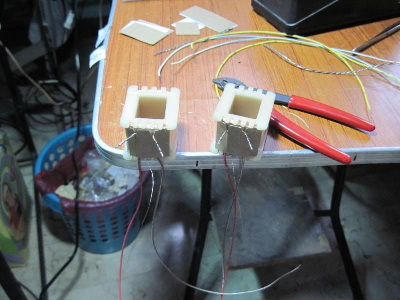

output transformer for a 6J5 preamp ala Jack Elliano...
turns ratio is 5:1, 5k primary to 200 ohm secondary...
on Z11 3/4 inch cores.....

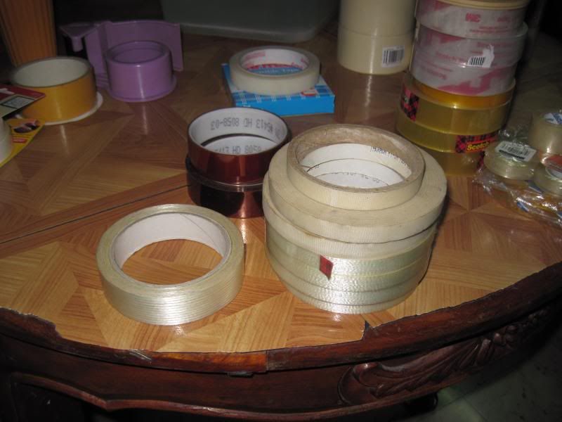

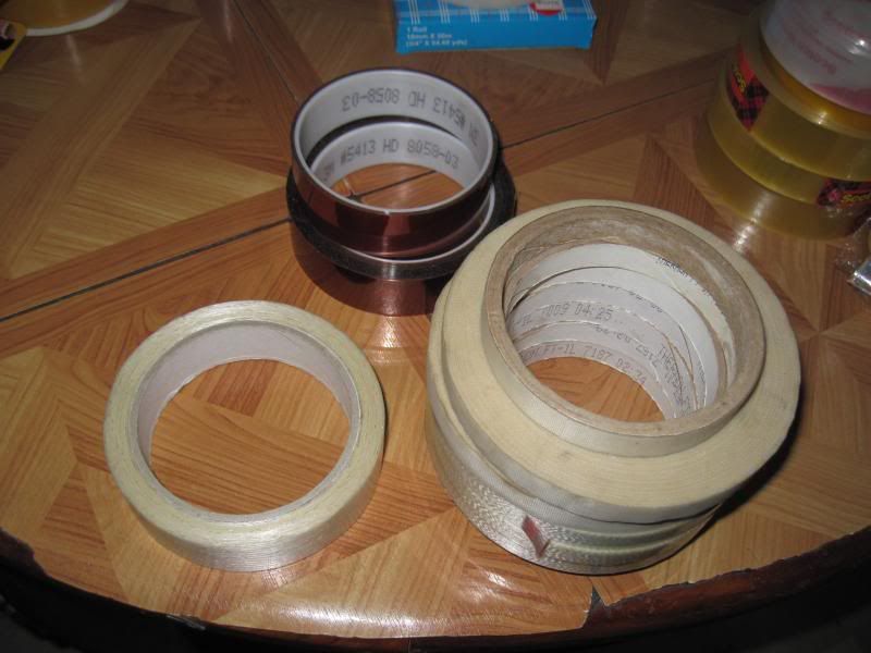

3M double sided tapes come in handy...

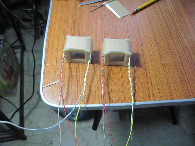

terminating primary leads...
primary leads terminated....

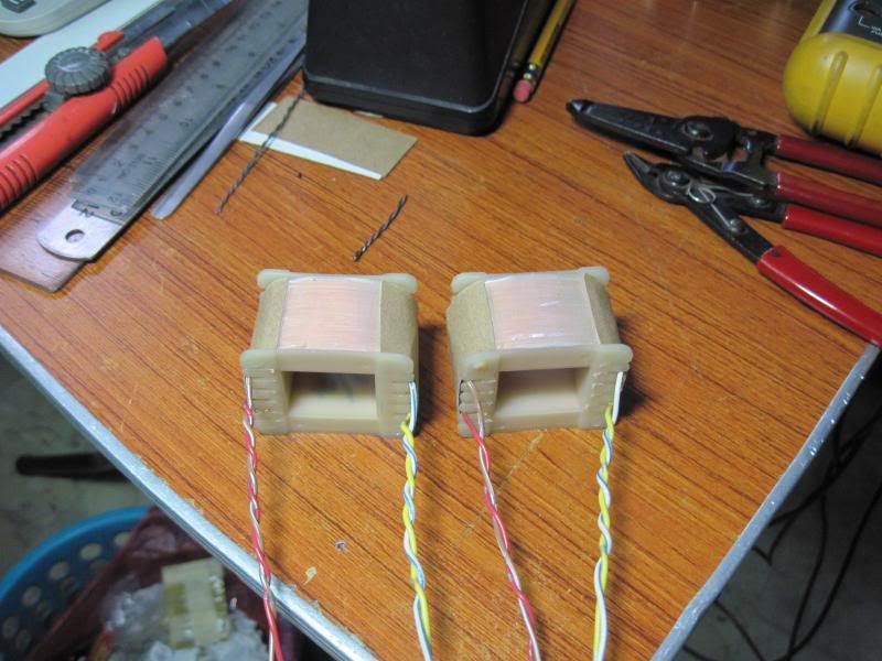

secondary leads terminated...
both primary and secondary leads secured...

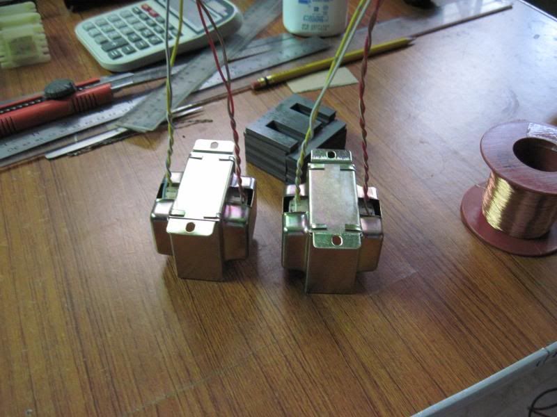

coil outer wrap completed, cores come in next..

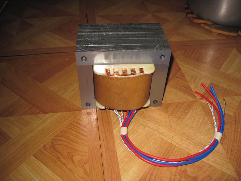

some left-over cores to be used on next build....

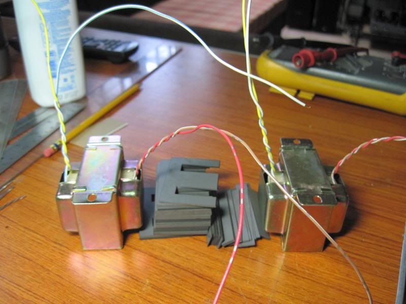

a pair of output trafffos finished and ready for a dip in varnish...
i took me about 3 to 4 hours from start to finish.....😀
in case you are wondering, that talcum powder is for my sweaty hands...
