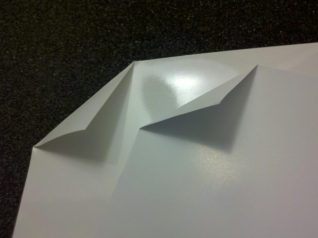

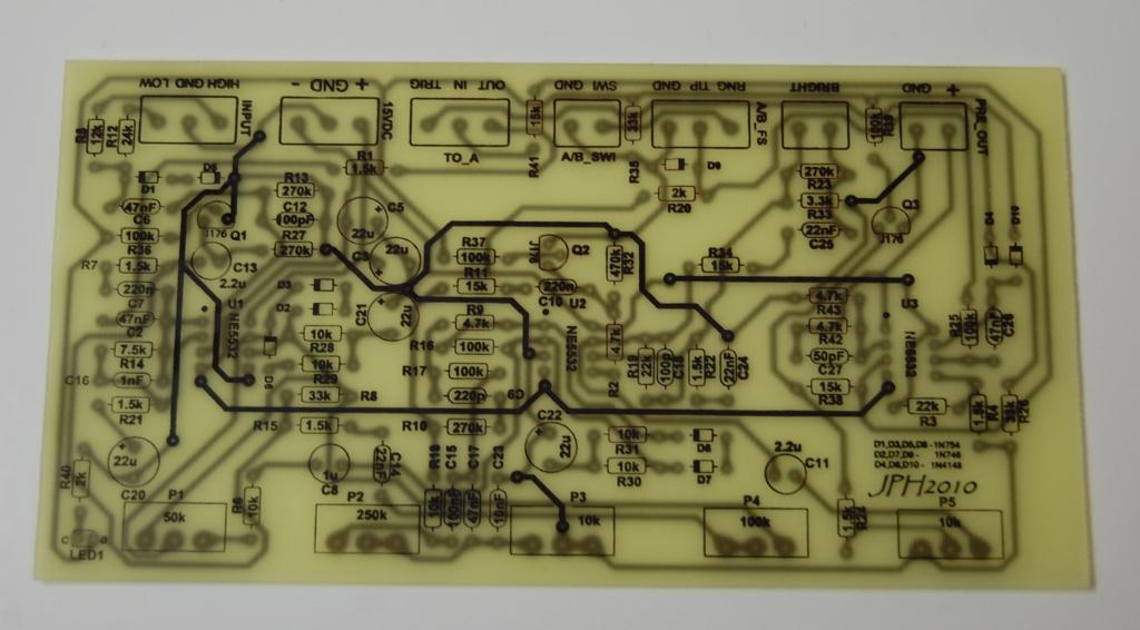

Up until yesterday, I had been using a nearly empty pack of Staples photo paper (as recommended on Tom Gottee's site). It was the 100 sheet package. For those who haven't seen some of my PCBs, this is an example:
a board that just came out of the etchant. Sharp quality - perfect results always.

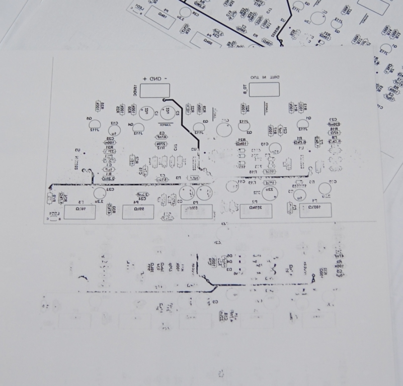

So, about a year ago, I bought another 100 sheet package of the same paper - same name, same item number - 471865. I didn't need it until yesterday and I opened it up and did a print. The results:
I tried another sheet, same thing. I compare this paper to the older stuff (I had 1/2 a sheet left) and there is a difference. The new one has less gloss and stays flatter, where the older one would curl slightly at the sides. The new one has a Staples watermark on the back, the old one doesn't.
I'm totally pizzed off - 100 sheets of useless paper and no (cheap) way of finding a good replacement. If Staples needs to 'improve' a product, why not re-itemize it. Don't claim it's the same product.
I went to Staples this morning and attempted to explain the situation to the nearest 17 year girl (that and 17 year old boys work there) but she was totally vacant - not a clue about what I was doing or what paper to suggest. I took a couple of their gloss sheets (from the print department) and bought a pack of HP photo paper ($18 for 30 sheets). Neither of these is usable. The HP I will return.
So, anyone out there have a suggestion for a replacement?

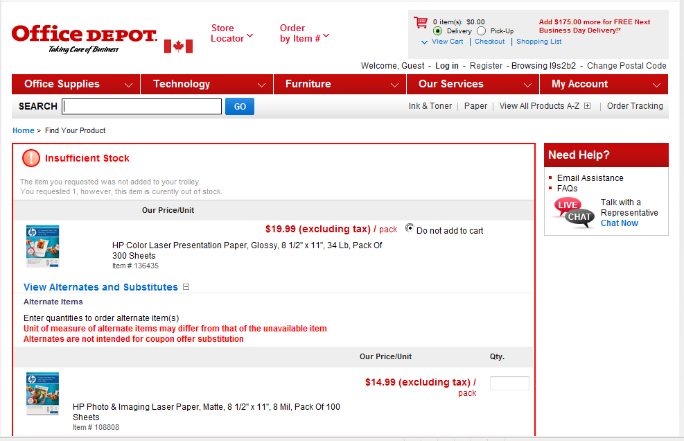

Here is the first Canadian source I could find.....
Office Supplies: Office Products and Office Furniture: Office Depot
