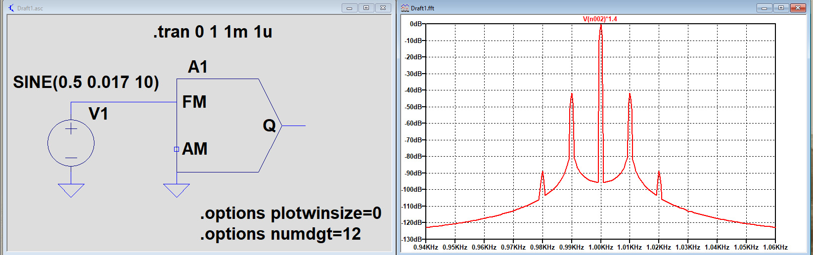

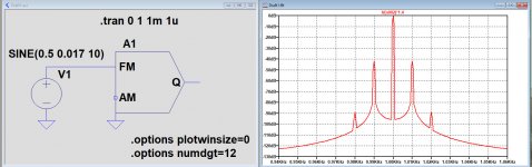

Yup interesting. Theoretical FM modulation from srcubbing should have a series of sidebands at integer multiples of the modulating frequency ie 10Hz 20Hz 30Hz....and looks like there's part of that series.
But I think one should anticipate the same FM on any vector, vertical. or lateral. This is because stylus is only free to scrub along along the line of the groove. Even if there wont be much test tone level on L-R vector (vertical) it must still show the same FM....?

Hi Diyrayk,
I fully agree, exactly the scrubbing is causing FM modulation giving these sidebands.
Maybe the term IM that I used was the misleading.
Hans

The problem I'm struggling with is how to map -42dB sideband amplitude onto an index for how deep the FM modulation is?
When I've done it right, the FM modulation index is +/- the frequency deviation divided by the modulation frequency.
Modulator was set as Space=995 and Mark=1005.
In this case with ca -42dB for the first sideband:
m=0.017*5Hz/10Hz=0.0085
Hans

LD,
The modulator was set with Space=995 and Mark=1005.
The FM input was driven by a 10Hz signal with an offset of 0,5 volt.
When giving the input signal an amplitude of +/- 0,5V, it goes from zero to 1Volt and the modulator goes from 995Hz to 1005Hz.
Pitch variation in that case is 5Hz/1Khz is 0.5%.
However I needed only +/-0,017V instead of +/-0.5V as you can see in the simulation to get the first sideband at -42dB.
(0,017V/0,5V)*0,5%= 0,017%, which is safely below 0.1%.
Hans

Thanks Hans, yup all looks good I get that.
A swift check on the famous B&K paper shows 1st sidebands typ -20dB to -30dB or so though the graphs are noisy to read so really looks like you have in those conditions an unusually stable rig!

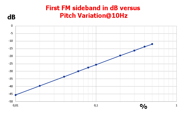

I think it might be good to do a swift table or graph that maps 1st sideband level onto % pitch variation, then the method would be quantative something that even B&K didnt manage?
LD
LD, here you are.
Hans
Thx Hans. I'm not sure yet this can quite be right...understand it obtains from the spice component model but....shall check out the maths and theory, plus I think if yer look at it from energy perspective all modulation should end up in the sidebands? And for small modulations that means 1st and maybe 2nd mostly, ie mostly a simple ratio...so maybe its time for me to understand it properly (groan :-; )
