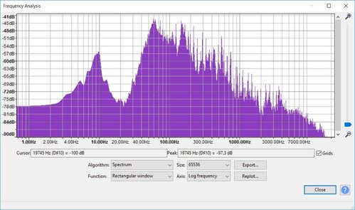

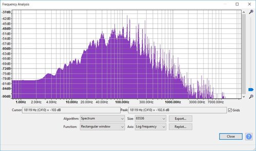

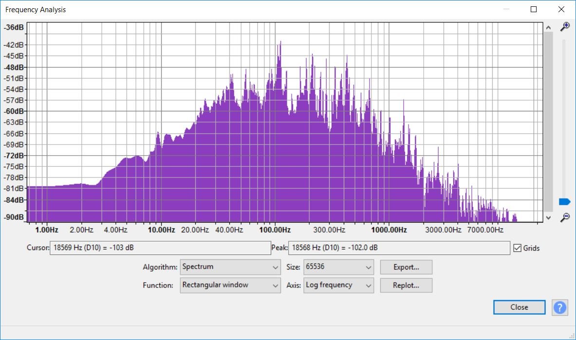

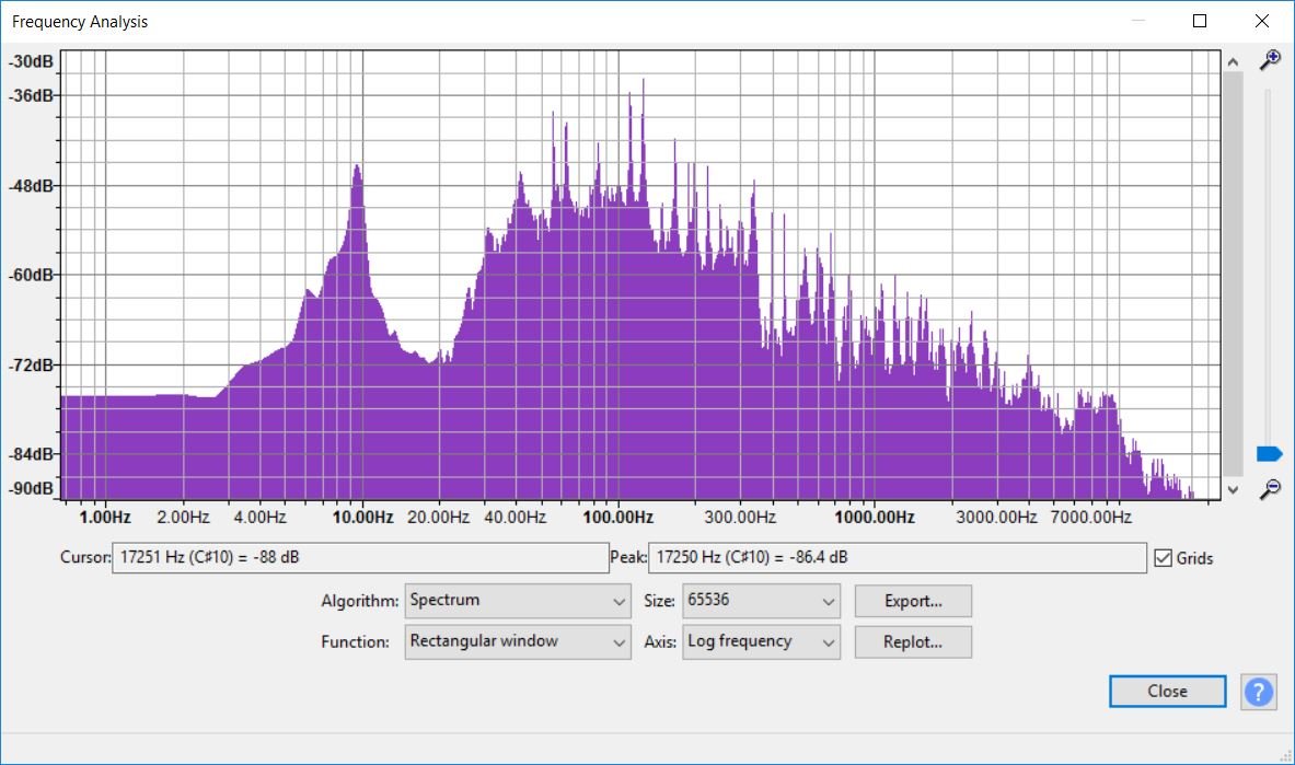

Couldn't find the ones I was looking for yet, but here is a starter for 10 on the effect of a silicone damping trough on an SME 3009 S111 with a MM cart on it. These were actually playing music so hitting the same point on the same track each time for analysis is nigh on impossible and audacity is a slighly blunt tool for this sort of analysis. However gives you an idea.
On first eyeball you seem to lose as much as you gain, so 10Hz and below the resonance is damped, but 20-50Hz looks worse. I have not sat an pondered this so just throwing it out there. I am sure I can get the raw files for anyone who has an idea how to analyse.

Seems like a pink noise track would give you much better repeatability. I'm not really able to deduce anything about the damping trough vs undamped from these captures.
Some are a bit too small and I can't see them.
It does make me want to focus more on digital and tape which is pretty much what I am doing these days.

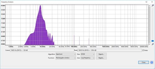

And an example of a silent track.
Bill, when you say silent track, is that just the inner (lead off) track or are you using a test record?
Does arm resonance vary with the position of the stylus on the record ie outer tracks vs inner tracks?
My bad. I should have attached larger pictures. But I should note these were mainly to get a feeling for what happens to inform what measurements would be useful and how to analyse them.
That is silence between tracks. Just to show the resonance can always be seen.
