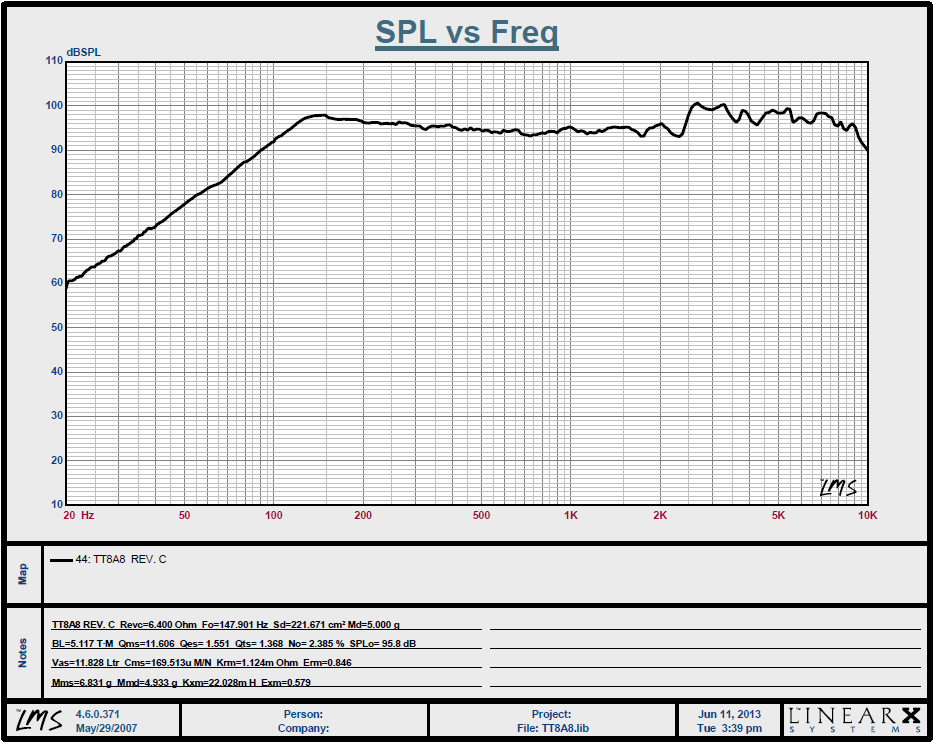

Know it needs sub, and the red one u used played well from about 70Hz.
But looking at the blue it has lower fs and higher Qts (probably to high..4,6..)
qes is awfully high on the "Blue" - kinda like adding a sizable series resistor to a hotter speaker
graphs fwiw:
Chicago Blue https://tonetubby.com/wp-content/uploads/2015/07/chicago_blue_12_8_specs-e1437003295366.jpg
CannabisRex http://musicgearforless.com/image/cache/data/232656-1024x600.jpg
lil' Buddy http://www.tube-town.net/ttstore/images/product_images/popup_images/606_1.jpg
graphs fwiw:
