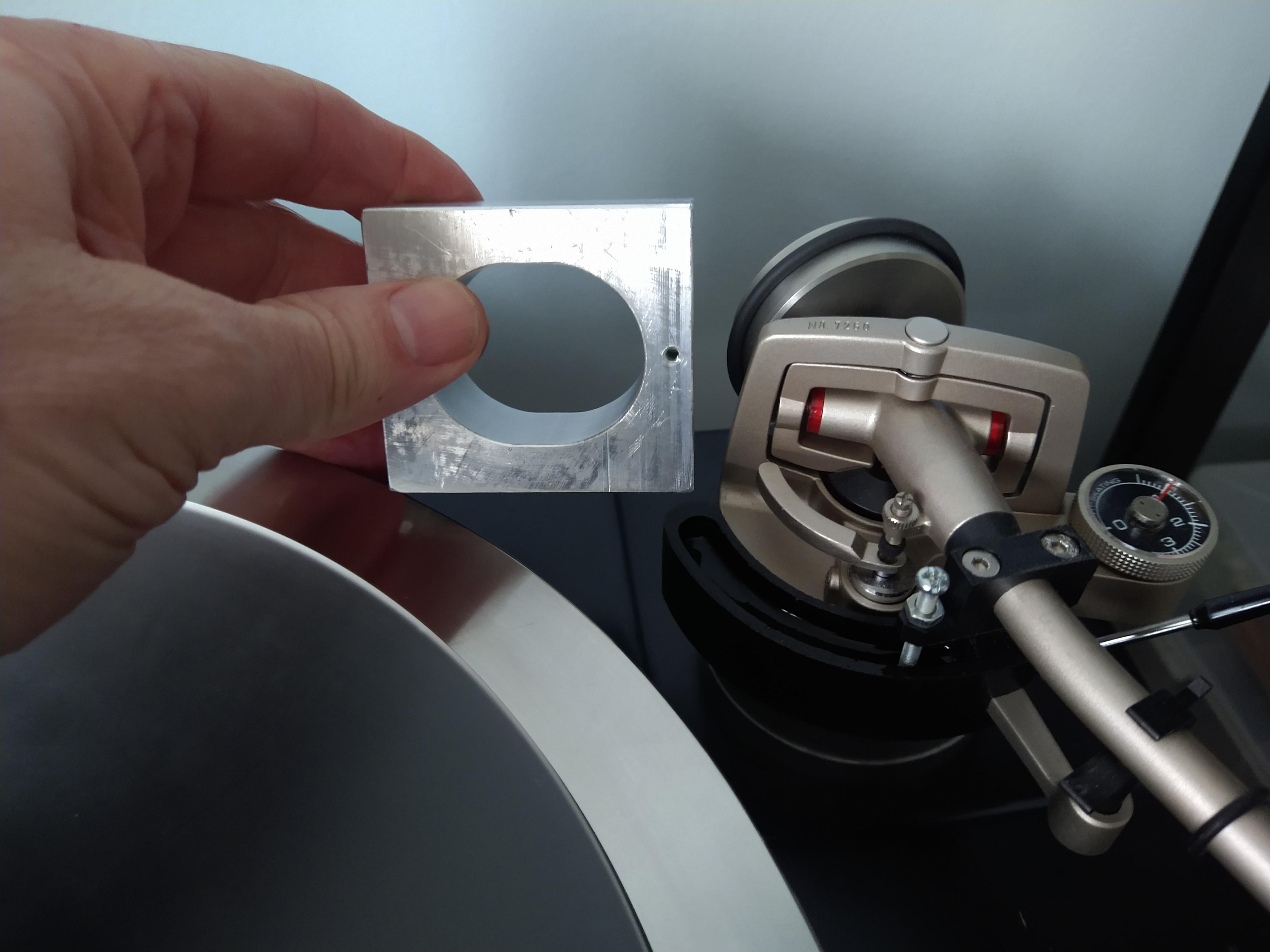

I completed the horizontal bearing housing today, pictured next to the Technics arm. This will be a very large arm. Built for rigidity.
I have 4 x sapphire Vee jewels for the pivot cups. These are designed to accept carbide pins, but I'm using tool steel ground at 55deg and polished to 1micron.

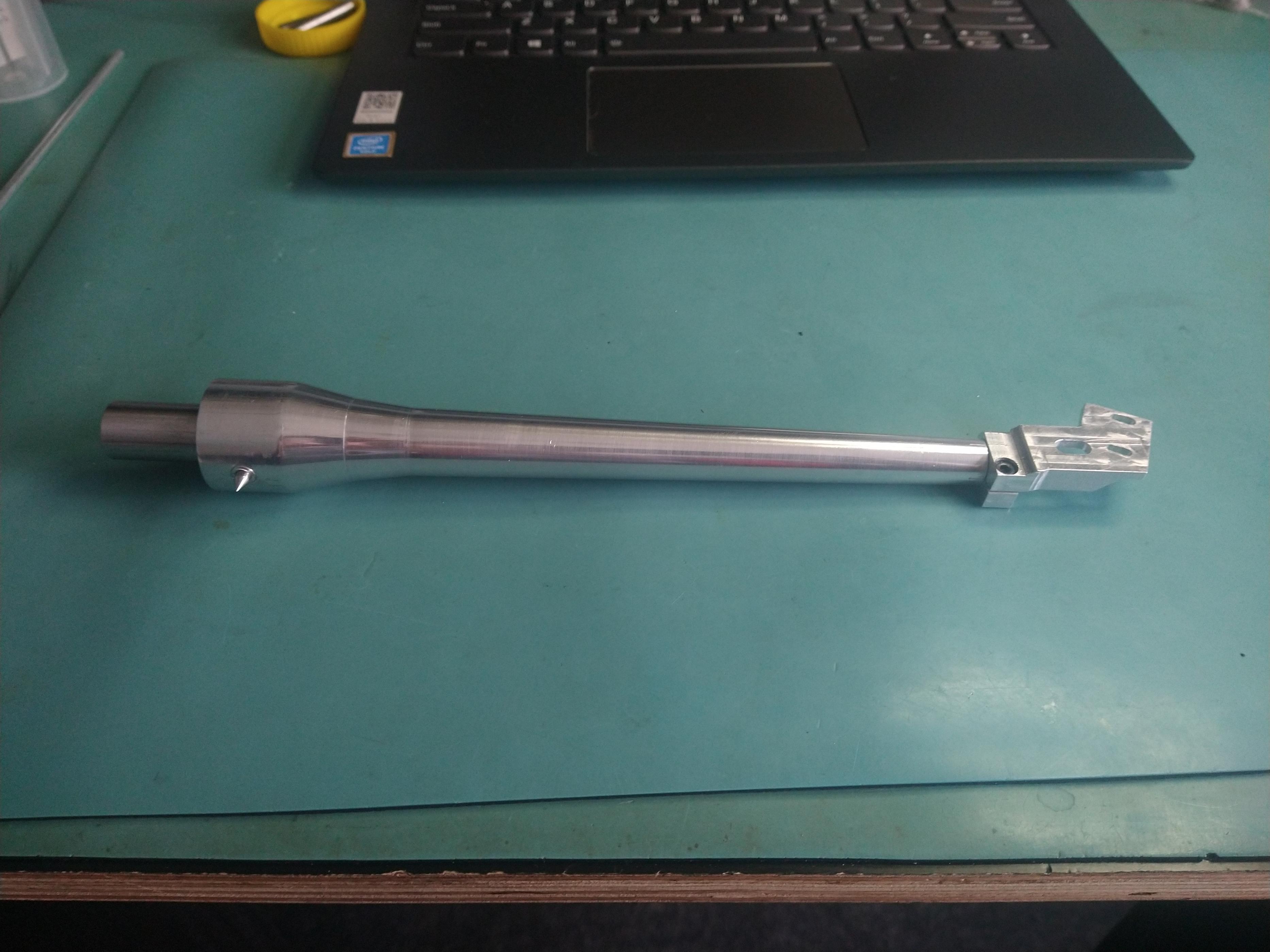

You are make an assumption I have not addressed tonearm energy. The most I mportant thing is the amount of energy reflected back to the cartridge.
This arm wand has variable wall thickness and taper to reduce refected energy. The removable headshell is made from the same section of aluminium and grain orientation as the wand.
It's made from 6061 T6. The plan is to make another from AZ31B magnesium.

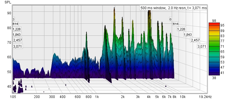

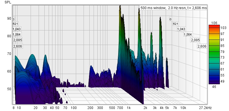

Here are waterfall plots of the arm I'm building. This is with the arm wand hung and hit with a hammer (impulse testing)
1st plot is the bare arm wand, 2nd plot is with the headshell and CW stub attached. You can see the resonance drops in frequency a bad thing as lower frequencies have greater energy and are more difficult to damp.
Removing the CW will effect arm wand vibration/resonance. At this point it's unclear to me as to the magnitude of this change. It might improve the damping in the wand or it could make it worse, I need to measure the arm I am currently building with both regular CW and mag-lev.
DIY 4 point pivoting arm

In these waterfall plots the arm was hung by the bearing and the HS end was hit for the wand only all other plots the HS was hit.
Everything that was subsequently attached to the arm wand altered the vibration characteristic of the wand.
All the impulse test tells us is the natural vibration resonance of the arm wand and attached ancillaries, ie what frequencies will be excited in the wand by the cartridge. Attaching a CW to the arm is going to alter this vibration characteristic again.
These were preliminary tests to see what effect different damping materials had on the natural vibration of the arm. I am a great believer in testing in situ so once I have the arm complete I will revisit these tests using the cartridge as the transducer.
