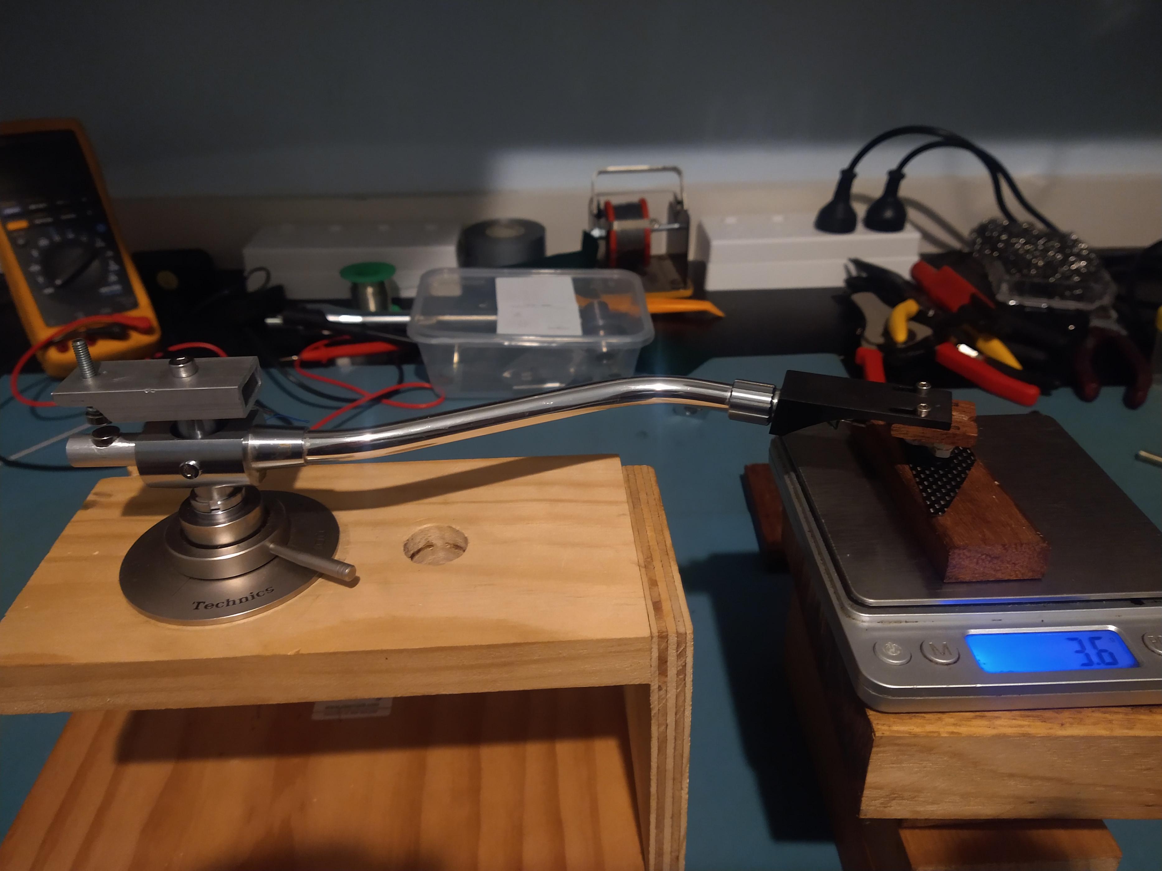

I built a mockup today VTF increases exponentially as the arm lift
Checked at 1,2 and 3g.
0.6g with 0.5mm rise
1.0g with 0.7mm rise
The other finding is the arm oscillates in vertical axis when touched.
VTF increases as the stylus lifts because the magnets are further apart.
The implication is, riding warps even small ones will produce an increase in VTF. Also setting VTF MUST be done with the stylus at LP height if the scale is 0.5mm high or low VTF will off by 0.6g.

Thanks for your video, fantastic efforts building a 'Mag-Lev' prototype, which you compare to a standard counterweighted arm set to near zero VTF and both arms are tested WITHOUT a cartridge suspension / stylus in contact with a record or other surface.
You bounce them both gently with your finger. The 'Mag-Lev' prototype bounces at circa 3hz with a very rapid decay – in under 1 second you can see a very rapid decrease in amplitude, and you can see the offset sinusoidal behaviour too, the beginning of the up stroke being faster than the beginning of the down stroke. Compared to the counterweighted arm which first bounces off hits the arm lift mechanism with nearly double the starting amplitude and still going at 50% after 5 second or longer all at a bit less than 1Hz all with relatively clean sinusoidal movements.
This is NOT the same as the resonance frequency behaviours of these arms playing a record damped by a cartridge suspension!
Upon what basis do you conclude a 3hz bounce in mid air is “pretty crap” compared to sub 1Hz mid air bounce in your “current setup” adjusted for no VTA?
To me your experiment shows the opposite of what you suggest, the mag-lev is very stable and your current arm oscillates wildly when tapped!
These two experiments highlight how different their geometry and mechanics are, and should be a warning not to jump to hasty conclusions. At least play a record with a 'Mag-Lev' before judgment day ;-)
Some suggestions (these are in some detail to also help new readers / experimenters get up to speed asap):-
1. Ensure the magnets are truly centred AND both are parallel (to the arm 'up-down' pivot). In the photo you uploaded it looks like you have epoxy bonded the magnets to the arm rear spigot and a bolt head in the mounting (bolted to the side to side pivot) you have constructed. I cannot see a lock nut on the bolt holding the top magnet? Any magnet mounting offsets a) torque / twist the bearings, and lower the magnetic repelling force. This link has lots of practical suggestion playing with repelling magnets.
Repelling Magnet Forces
2. Try different magnet strengths. As you can see from the graphs in this link, the closer the magnet surface are to each other, the more rapid magnetic repelling strength changes.
Such mid-air oscillation experiments allow us to tune a) the mid-air oscillation frequency and b) the range of change of VTF over distance from (a flat) record surface.
3. We can also tune this mid-air oscillation frequency by placing the magnet closer to the 'up-down' pivot. This will increase the lever ratio (spigot : arm wand) and for a given arm wand mass, the magnets will be physically closer, where magnetic repelling strength changes with distance are much more rapid. This is because magnetic attraction square law force falls off exponentially with linear increases in distance. With two magnets in opposition, a 2015 paper reports at very close distances "The magnetic dipole moment is determined from the slope of the magnetic force as a function of the inverse fourth power of the distance."

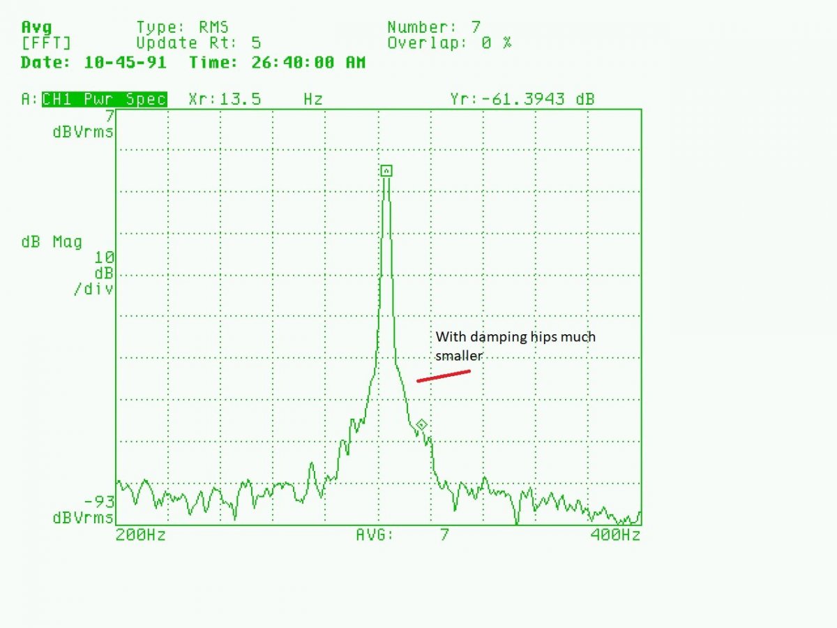

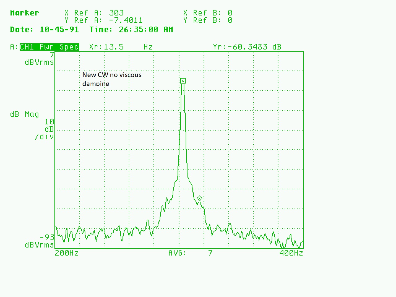

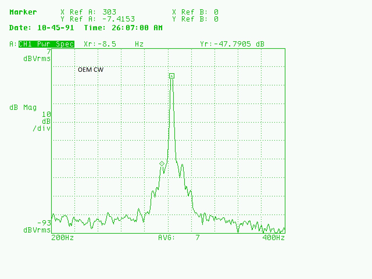

The plots are a Technics EPA100 tonearm. This tests the cartridge / tonearm, the 8.5Hz is an artifact caused by resonance/vibration in the arm/cartridge system.
The Technics CW with has a spring loaded magnet in a viscous bath inside the CW that is adjusted to the compliance of the cartridge to damp resonance. The plot shows how this does not work all that effectively.
The second plot is the arm with a new threaded brass stub and SS CW locked rigidly to the stub closer to the pivot.
Just this modification dropped the sidebands on the 1kHz tone. These sidebands are caused by amplitude modulation of the 1kHz by 8.5Hz.
The audibility of this was an increase in detail retrieval and spacial information.

So the measured -48db drop to 60 Db at 8.5Hz in cartridge / tone arm artefact caused by resonance/vibration in the arm/cartridge system, ought to be audible as you report.

The EPA100 test was with two cartridges a Stanton 881s compliance 30 x 10-6 dyne at 10Hz and Technics EPC205 12 x 10-6 @ 100Hz. The Stanton in theory should not be a good match for this arm.

When I added the viscous damping to the EPA100 I tested it with a signal analyseer and 315Hz and 1kHz tones, too much damping and the sidebands increased.
I know it's off subject a little but here are the plots for my EPA100 with and without damping. If you switch betrween the plots you can clearly see the difference, these plots are with the EPC205
