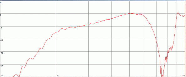

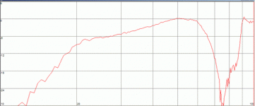

G'day Freddi
The 18Hz horn does work very well in room. Here is the near field response. In room it's pretty much flat. The rolloff above 60Hz requires a low crossover. I'll put some details on my webpage soon. It's BIG. It has the nick name "The Coffin" I think it's a bit big for that!
Cheers
William Cowan
