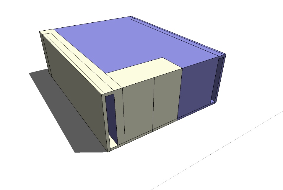

Here is the same basic design (not ISO loaded), but with 6" x 42" ports -- still tuned to 10hz - 40 hz +/- 3db
The chambers have been increased to account for the larger ports.
Rear chamber 48" x 30.5" x 15" (12.7 cu ft) inner dims
Front chamber 48" x 6.5" x 15" (2.7 cu ft) inner dims
Box size 49.5" x 39.25" x 16.5" outer dims

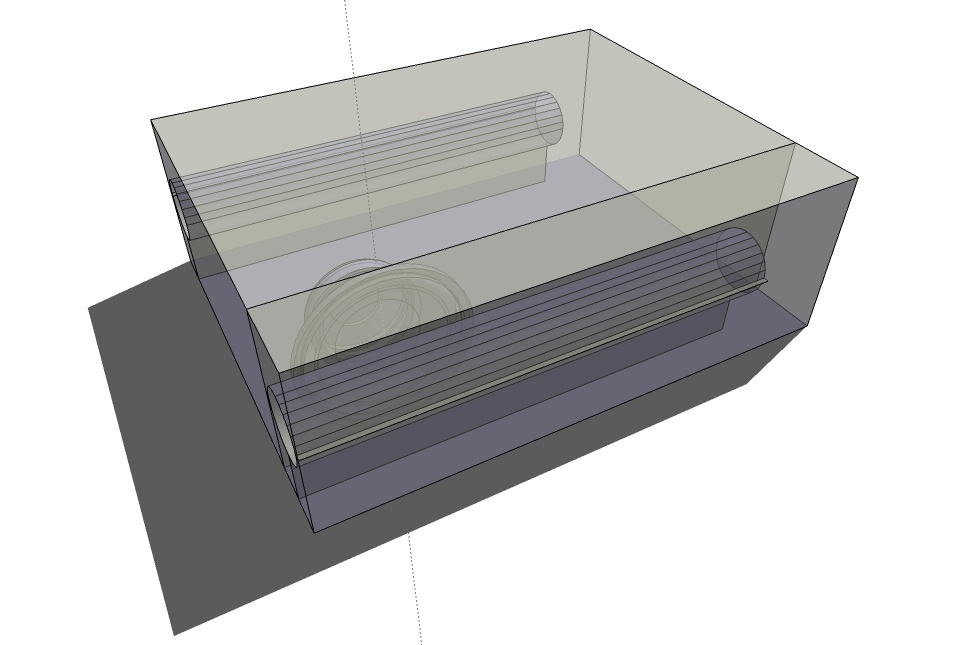

Here's a see-thru of what I am proposing...
I used MJK's worksheets and modelled this stuff as normal TQWP's. It showed there's nothing to be gained going longer than 1/4 of Fs. Bigger volumes on the other hand got more extension. The best for what I need (10-30hz) was about 900L and 2.83V + one Tempest nets a quite flat 83db in that range, but excursion limits me to less than 100watts at 10hz.

Here's Dan Wiggins isobaric 6th order bandpass tuned to 10-40hz +/-3db, 105db (the two chambers still 2 cu ft, 12 cu ft)
It is 17" x 38" x 50".
I replaced the 42" x 6" pvc pipe ports wth rectangular ports (same CSA)
