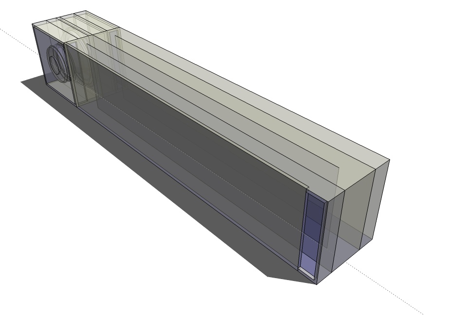

Hi Relax
Here is an idea for you.
The driver in a standard enclosure on the same end as the port gives you a traditional t-line.
A modified enclosure and on the opposite end gives the "experimental" design.
The end opposite the driver /enclosure would then be capped off.
The unit is 60" x 12" x 12" and is tuned to 17-18hz.
You will need a 50hz 4th order xover for such a low tuning...
Traditional...
The same 16' tuned pipe with the driver / enclosure on the other end.
The front of the driver fires into the tuned pipe 4' from the sealed end.
The rear of the driver fires into the tuned pipe 4' from the open end.
The end opposite the driver /enclosure is capped off...

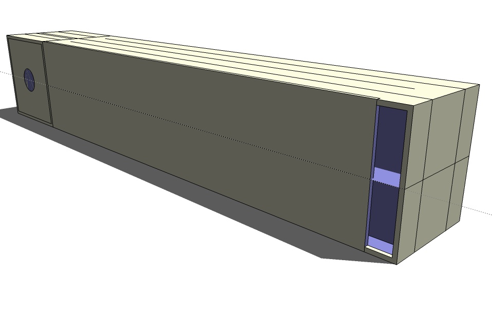

Thank you for your feedback.
Yes, I too have looked at all the the posts / pics regarding this subject.
My SKETCHUP is based on all of that information and actual pictures of the unit.
Also, an email specifically mentions that it is tapered.
In fact early renderings showed the port to 'wrap' around 3 sides of the cabinet. Now reduced to a single port, probably to allow for flush mounting in a wall
AFAIK, the port exits from the side, or optionally exits from the bottom
Walt's design is "close" (as I am sure you have seen).
Walt mentions he is not "down 3db at 16hz", however (the TOP published specs).
I believe Walt needs to go to a longer pipe and / or smaller port.
Regards...

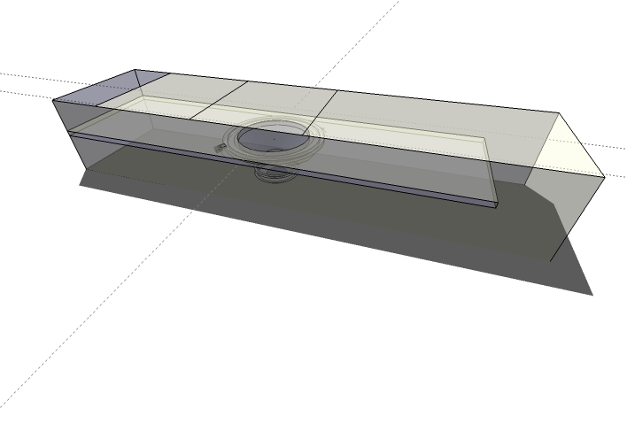

What lead you guys to the conclusion that the pathway is tapered at all. The pic I saw which is no longer available looked to me like a constant size pathway, and that Danley's design is just an offshoot of the 1950's Jensen Transflew. The driver is just in a different location. Wouldn't this make it some type MLTL ?
Sorry qi, been a bit busy to reply. Certainly your model feels aesthetically correct with the sloped line, rather than stepped, and I'm sure to improve on the Transflex it has to be significantly different, unless the patent purely applies to the method of calculation. I think it's safe to assume that the driver is in the middle of the enclosure, otherwise why go to the effort of cutting an access hole half way down. Unfortunately, my PC measurement system is inoperative at the moment, otherwise I might build a test cab to experiment with.
johninCR said:What lead you guys to the conclusion that the pathway is tapered at all. The pic I saw which is no longer available looked to me like a constant size pathway, and that Danley's design is just an offshoot of the 1950's Jensen Transflew. The driver is just in a different location. Wouldn't this make it some type MLTL ?
That's exactly what I thought, but an email I read specifically mentions that it is tapered.
My original SKETCHUP...

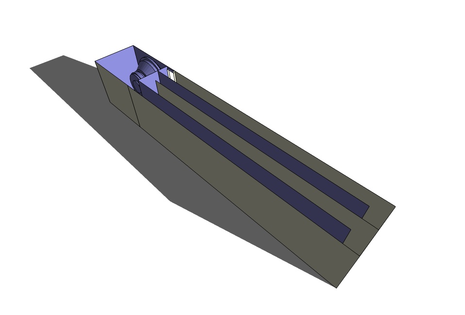

We're only talking semantics here.
I am still referring to the designs I have rendered / posted.
Since I have no clue about your driver, this is just a WAG
15" driver tuned to 10hz...
339" pipe, or four 85" x 7" x 15" lines (inner dimensions)
CSA (and port size) is 7" x 15"
Box size 16.5" x 32" x 102"
Here is a rough SKETCHUP for your 15" driver...

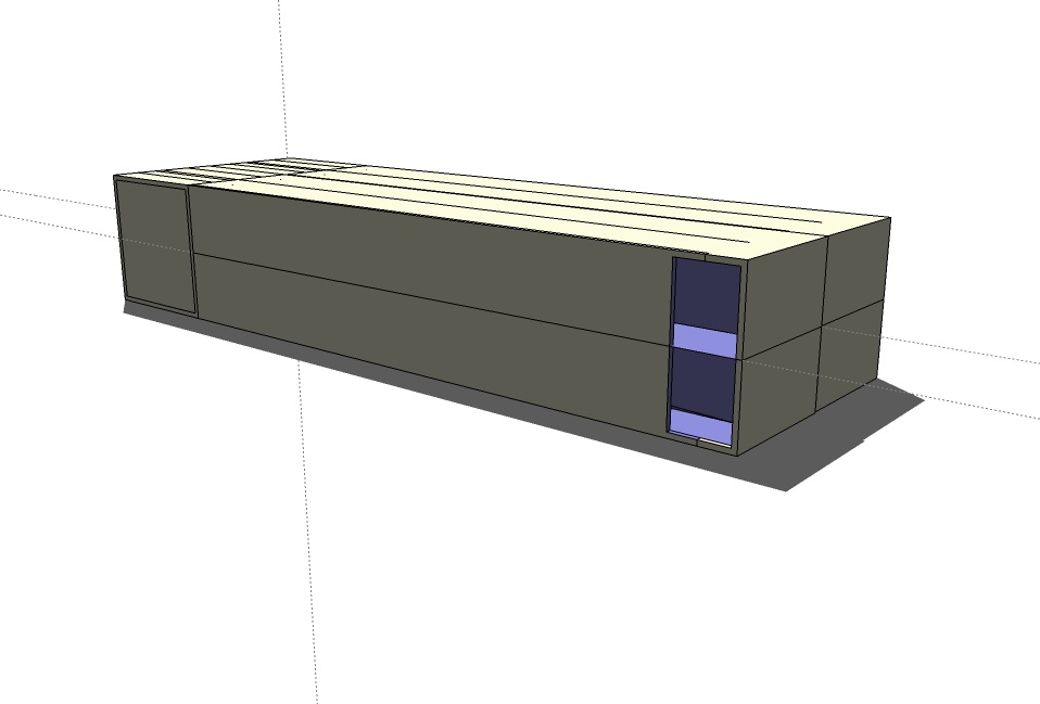

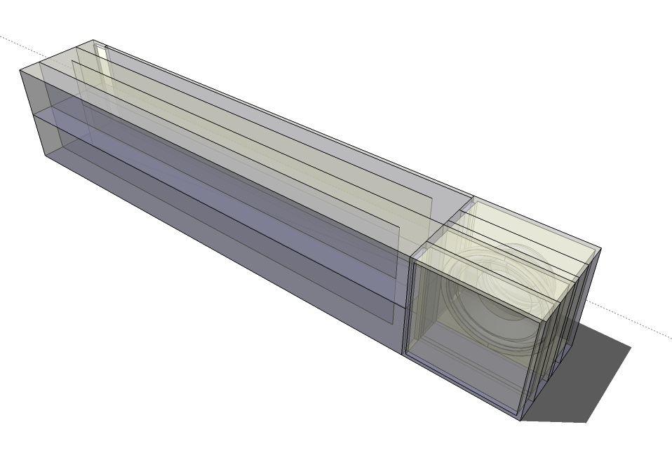

johninCR
Actually he uses a beefed 12" driver
I assume from other posts of yours, that you are using your Tempest 15
Using Tempest 15 T/S specs...
Fs 18.8hz
Qts .39
Vas 11.2 cu ft
Tuned to 10hz (using 3/4" void-free plywood)...
CSA 4.5" x 19.5" (88 sq in)
Each of the four t-line segments 85" x 4.5" x 19.5 (inner dims)
Port size 4.5" x 19.5" (inner dims)
Two ports joining driver / enclosure to pipe 4.5" x 19.5" (each -- inner dims)
Outer box dimensions 22" x 22" x 102"
With these dimensions it will look much more like this SKETCHUP...

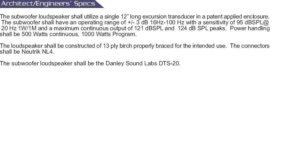

Tehrasha
Actually, if you go to the bottom of that same PDF, this is what you will find.
What I was referencing...
Totally agree that Walt needs to go longer to reach the magic 16Hz, but even the TOP doesnt go quite that far. The PDF reads -5dB @18Hz -10dB@15Hz.
That makes much more sense. +/-3dB across the passband and -3dB @ 16Hz are VERY different things. 🙂
