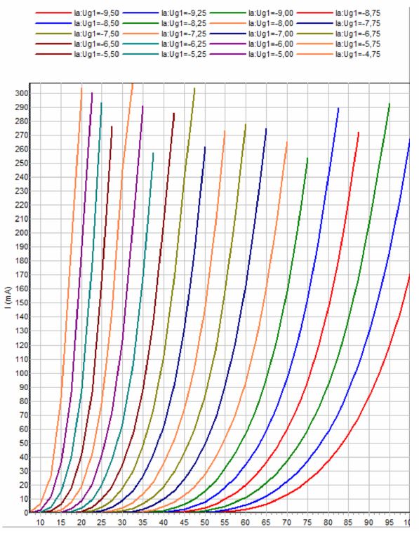

@Soundhappy,
WOW 😱
It appears I need to consider much higher voltages and lower current.
Thanks!
WOW 😱
Thanks!

@Soundhappy
That is why I have so many grey hairs; I never tried to build a HV tube amp, and have lived long enough to dream.
I was thinking 60V would be good but those charts make me think at least 100V would be significantly more linear.

@Soundhappy
I was thinking 60V would be good but those charts make me think at least 100V would be significantly more linear..
OK 😀 Psu filtering higher voltages capacitors prices increase exponentially + 100V cost big

Can I think of this as being like a 'Remote Cut-Off' tube, similar to the 6386?
https://proxy.imagearchive.com/7ec/7ecb67dedc9519e0c92c522f1ee6af77.jpg
- Tokin SIT low voltage high current curves
