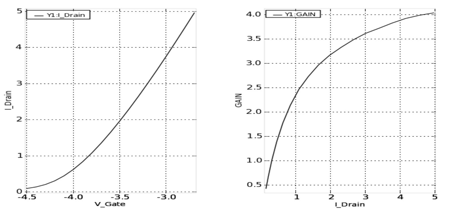

TOKIN SIT Gain Curve
This is something that modern (digital data) curve tracers can do. The data is in a spreadsheet. Exact values of Vgs and gain at any particular Ids can be interpolated from the data.
I wanted to know the gain at of this Tokin SIT at 24V Vds at 1.5A Ids to start matching to P channel MOSFETs for a DEF output stage. Vgs at 1.5A Ids is ~ -3.7V and Gain is ~ 2.8.
Gain means transconductance ?
Yes. I should probably re-name the formula result as transcunductance to eliminate confusion.

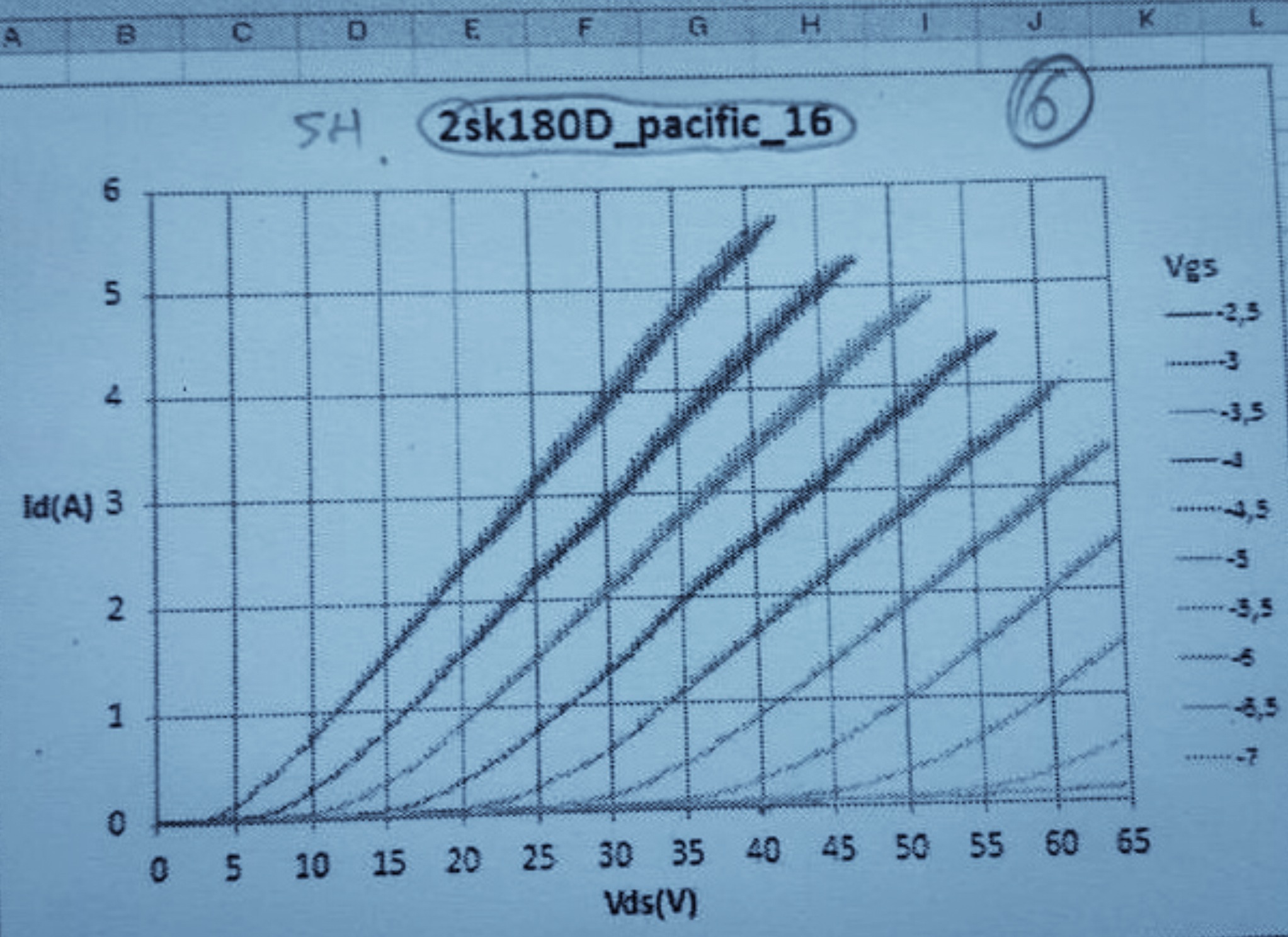

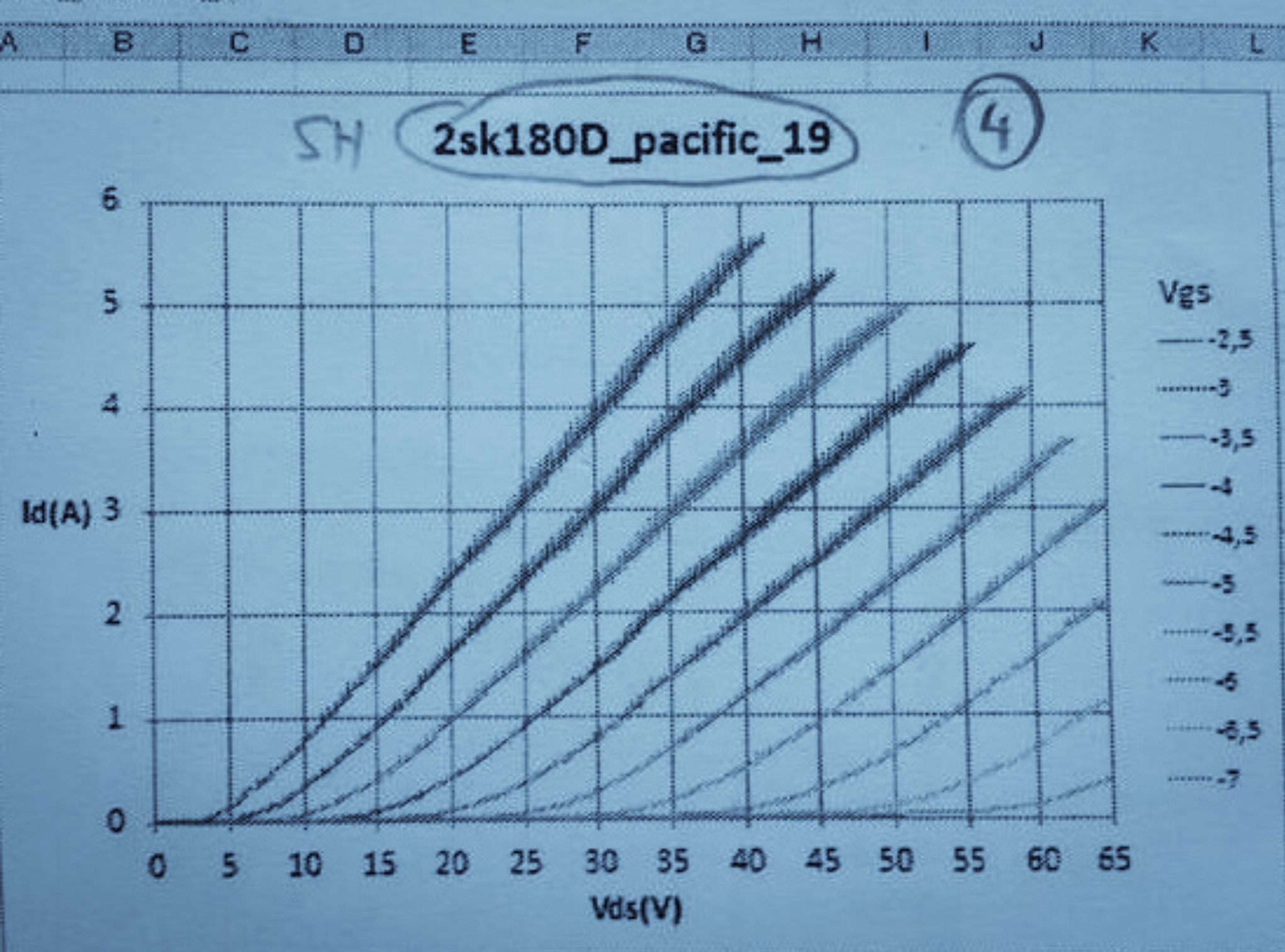

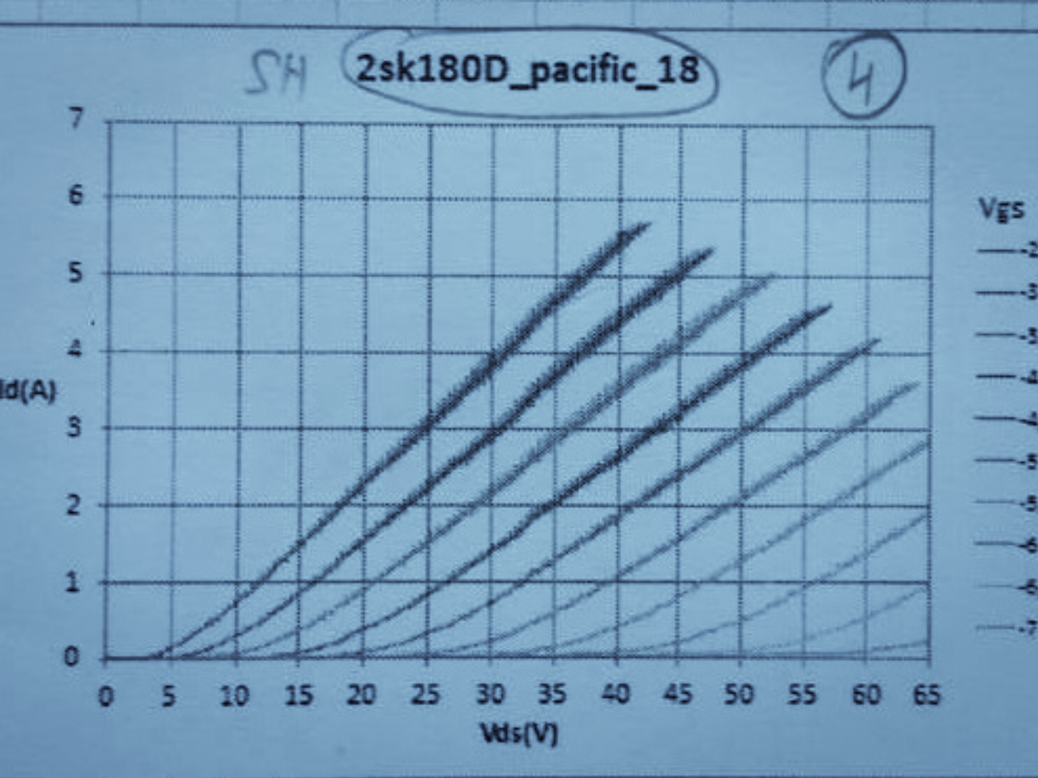

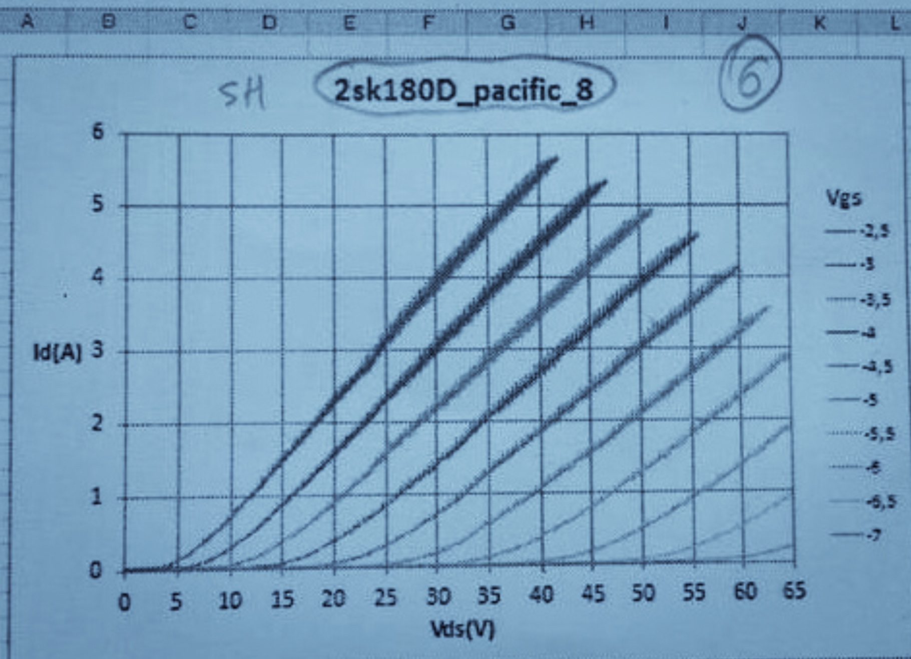

.. a pair of Tokin SITs to curve trace.
My 2SK180 Tokin curves was made by member Jama.
He used Frankentracer with software

Curve tracer software by Mr. Rothacher download link Frankentracer Excel Capture | AudioMaker

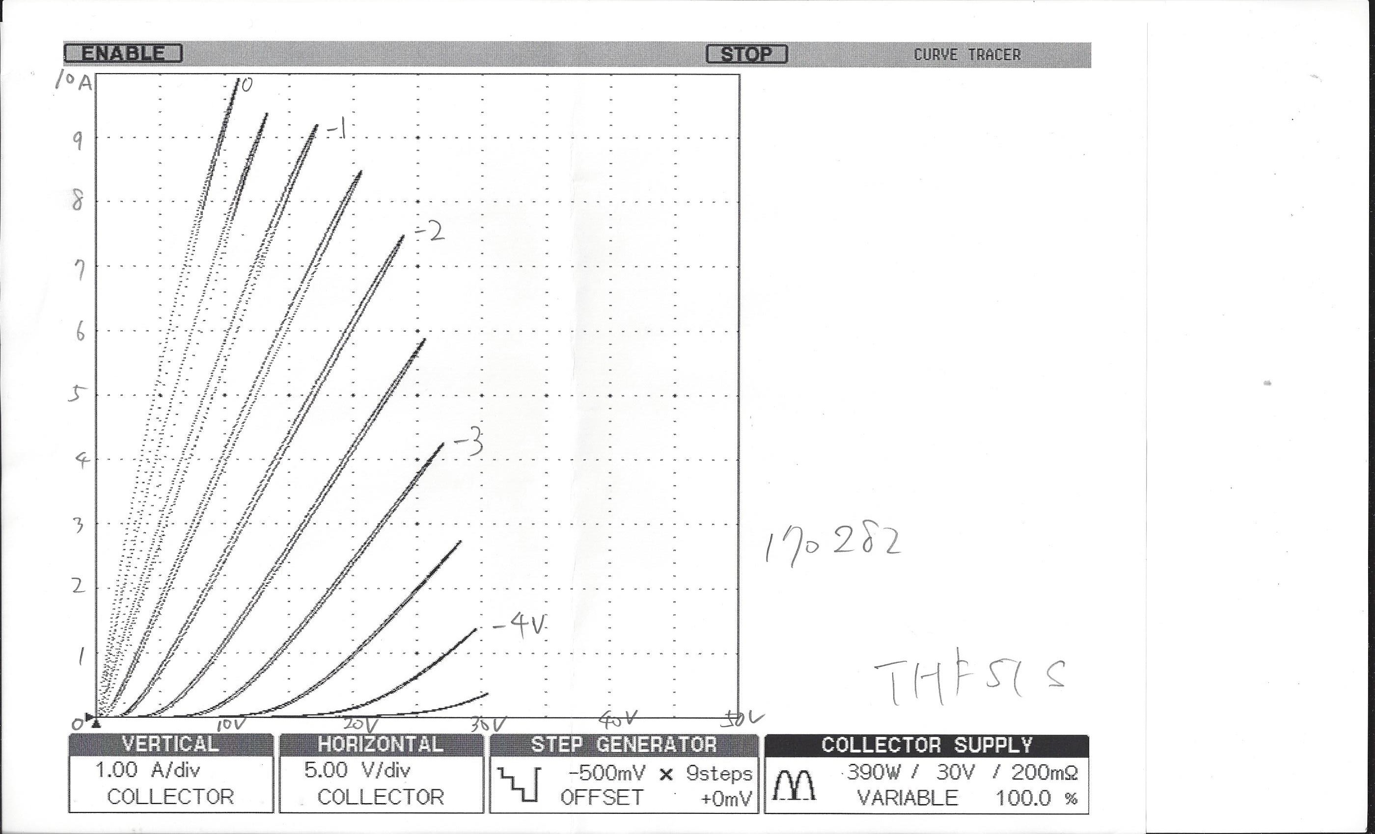

This lash-up is very clever and very cool. If I needed to brew one, I would use this. The curve tracers from the 1960s - 1970s used this technique and cost upwards of $40,000 back then. Many are still in use. I have seen them in my travels for my day job.

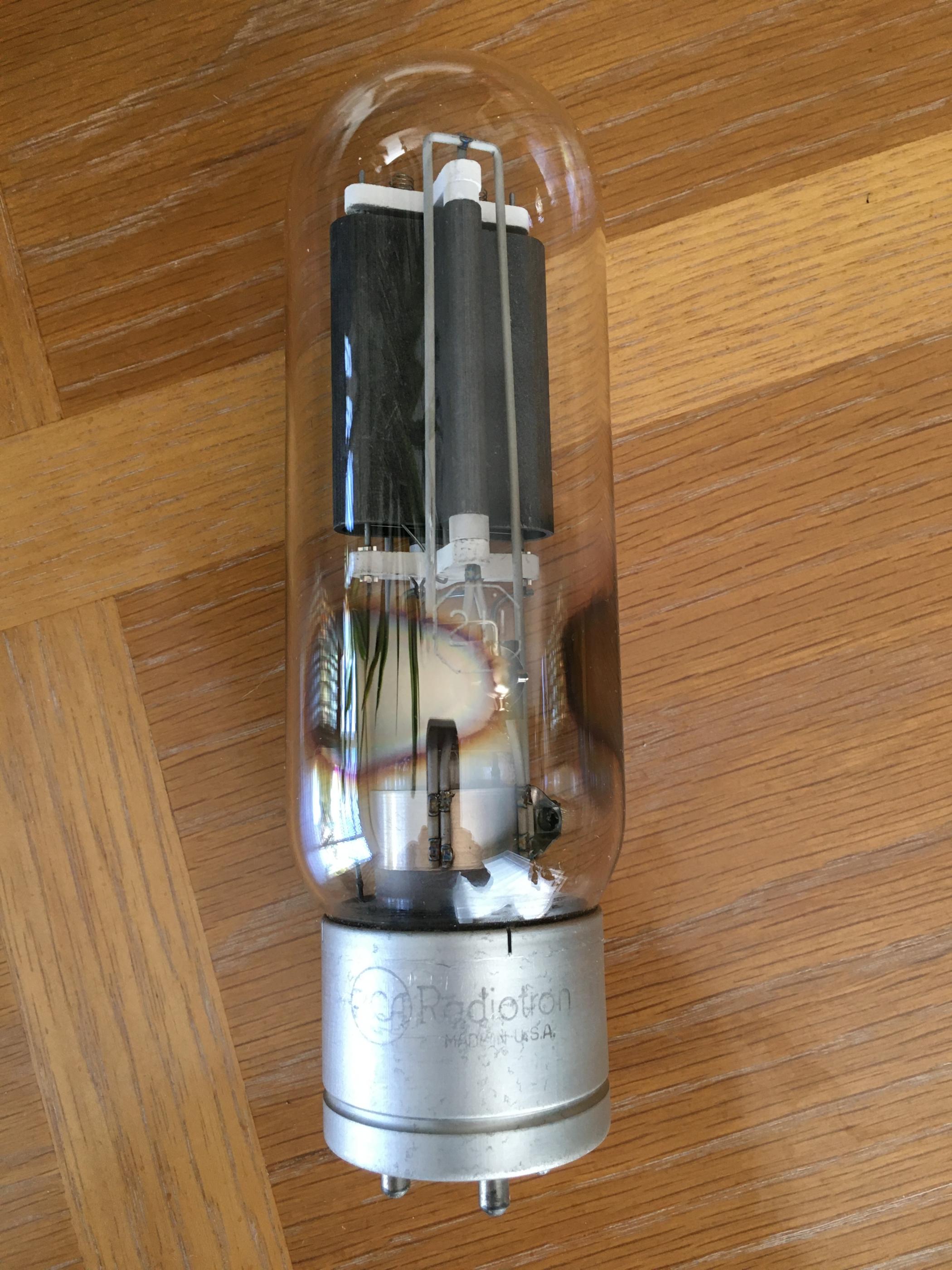

Great triode curves
Something like big 845, 211 tubes but transistor version equivalent 🙂
