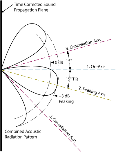

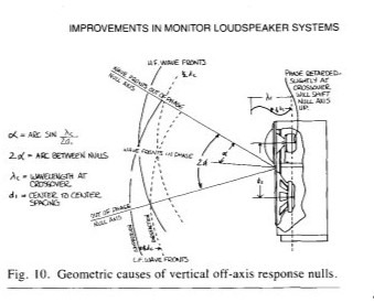

This may also be about the orientation of the primary directivity lobe in the crossover region. That can be designed into the crossover.
But how do i make this crossover?
3 order acoustical i think
And then make an overlap / sum with an error who move the main peaking axis sideways?
Yes.. except don't call it an error because it isn't wrong to tilt the lobe away from the listening position. The answer is not something we can guess, you'll have to measure and work it out.nd then make an overlap / sum with an error who move the main peaking axis sideways?
