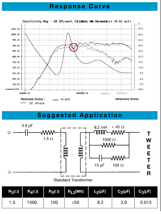

They're bot outdated so much as typically used for different applications. One of the most highly regarded super tweeters was the long-defunct Audax HD3P -a [fairly extreme] piezo variation. Not cheap either. Philosophically different from the pistonic mantra that largely dominates thinking around MC drivers (widebanders apart), but they are technically capable of good hi-fi performance if so designed.
I looked up the factory datasheet ( http://www.audax.com/archives/hd3p.pdf ). There is a fairly unpleasant notch in the frequency response at 8 kHz (see red circle in attached image). Off-axis response droops significantly above 10 kHz, meaning that the tweeter size is really too large to be a proper super-tweeter. Sensitivity is not exceptional at 90 dB@1W@1m - and even that requires a step-up transformer (!!) to increase the voltage to the tweeter, and a rather complex, bulky, and expensive crossover network (see attached image).
Perhaps this tweeter gained a good reputation a long time aggo because the on-axis frequency response extends well above 20 kHz, and that was a rare thing if you go back a few decades.
But the reality is that a tweeter sounds good or bad long before you get to 20 kHz. Really, it's the frequency response in the range from around 2 kHz to around 15 kHz that makes or breaks a tweeter.
These days it looks as though a $32 Tang Band ceramic dome tweeter outdoes the old Audax in every way: https://www.parts-express.com/pedocs/specs/264-865-tang-band-25-1719s-specifications-45762.pdf
There also seem to be several $15 dome tweeters sold by Parts Express that have smoother, wider frequency responses, and equal sensitivity without the need for bizarre, heavy, and expensive things like coupling transformers in the crossover network.

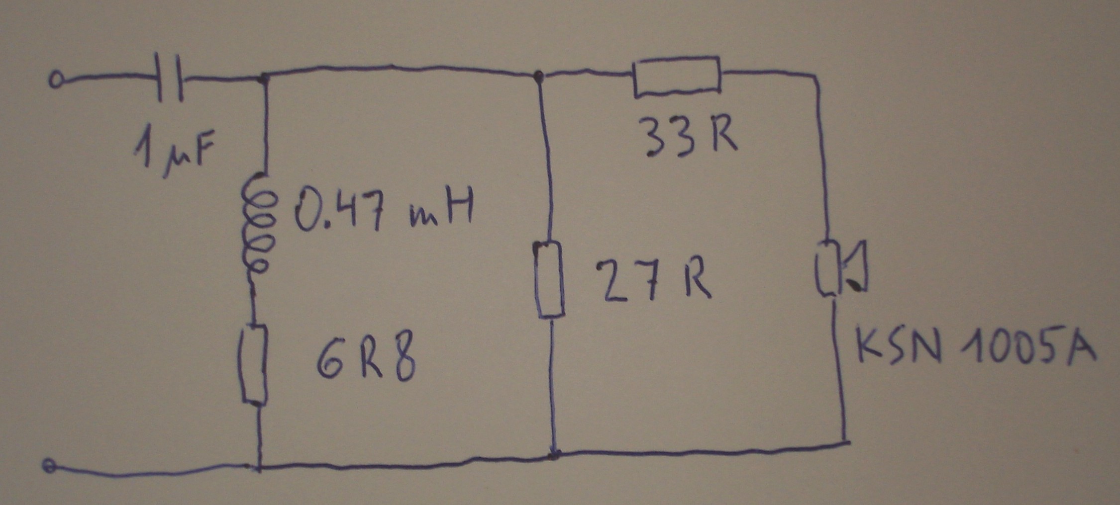

Here`s a X-over schematic that's supposed to work fine with standard lemon squeeze piezos:

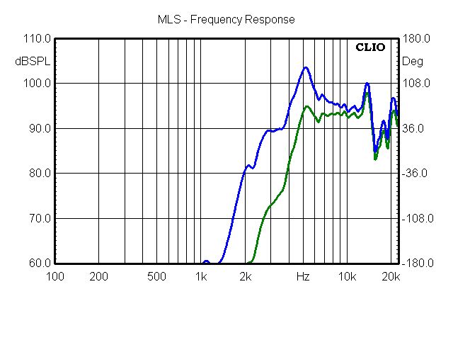

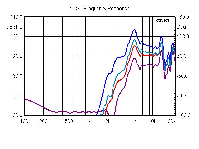

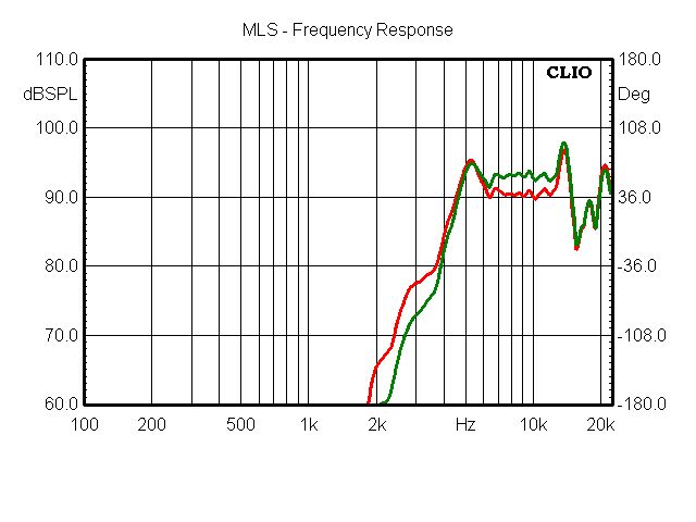

Measurements:
Dark blue: KSN-1005A
Light blue: high-pass with C=1.4 uF
Red: C=0.68 uF (maximum flat)
Purple: C=0.27 uF
This often-cited first-order high pass filter has rather limited use and mediocre performance. Better than without filter, of course.
