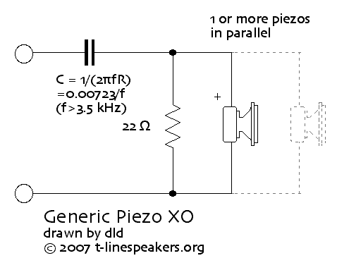

I use piezos, which were purchased in about 1980 as "PHM 8.19". They are probably quite similar to KSN1025.
At that time, I built the horns into separate housings and fill these with sand, so that the thin plastic of the horns cannot resonate. I installed acoustic lenses in front of the piezo horns.
The horns are working in three way bass reflex combinations, from about 3500 Hz on (see circuit).
The loudspeakers were used every day since then.
Listeners who do not know that they hear piezos do not recognize them as such in this loudspeaker combination.

With a 3.5 kHz fundamental, second harmonic distortion is already at 7 kHz, and 3rd harmonic distortion at 10.5 kHz. The Fletcher-Munson curves show that our ears are a lot less sensitive (15 - 20 dB less sensitive!) at 10 kHz compared to 3.5 kHz. We are less able to hear sonic nastiness at these high frequencies.from about 3500 Hz...Listeners who do not know that they hear piezos do not recognize them as such in this loudspeaker combination.
Most music also has little energy up at 10 kHz, and a lot more energy at lower frequencies, which will help to mask any nastiness up at 7.5 or 10 kHz.
So, because of the way our ears work, if a speaker has a cross over to a piezo tweeter sufficiently high up in frequency, it is less likely that the listener will be able to notice any nasty noises made by the piezo. I have a couple of thrift-store boombox speakers that use tweeters in this way. I think they are there mainly for looks, to convince the buyer that these are actually 3-way speakers. But you are right, they do not sound nasty, thanks to the high crossover frequency.
The various frequency response graphs we've been seeing in this thread do show that there are still huge peaks and dips even above 3.5 kHz, though. Even if they don't immediately stand out as obnoxious to our ears, they are there. These days, there are plenty of inexpensive soft-dome tweeters that do much better, so for DIY purposes, it's hard to find a good reason to use a piezo tweeter.
