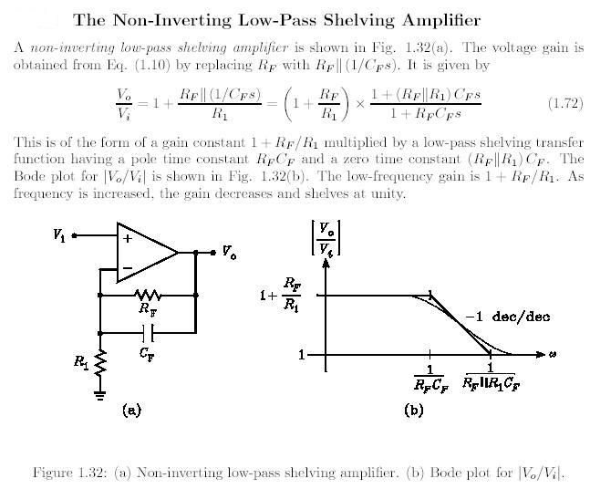

Oh...contrary to your statement, i think pole-spliting is a 'good thing'.......any tendency for the first non-dominant pole to, as you put it' 'bite', can be quelled by converting the system into a low pass shelving amplifier, (below), with the shelving zero used to nominaly cancell the first non-dominant pole.
Your recommended resistor in series with Cf is indeed 'good practice', but has a more pronounced effect on the location of the closed-loop pole, than on the shelving zero, as elementary calculation and simulation should reveal.
