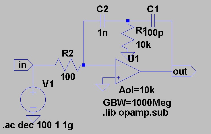

Sonnya,
you should swap the values of C1 and C2 (or swap the
components themselves). I know I caused a bit of confusion
on this previously, I am sorry for that.

It seems this discussion died out, so I take it that two-pole
compensation is not very common and nobody has any
experience with it, or...?
Sonnya, do I understand you correctly that you also came to
the conclusion that the method seems to work well if judging
from simulations? Unfortunately, I never saved any results of
my simulations.

Yes, if you are able to get a phasemargin of 50 degrees i can see a benefit from it. I do not like to get closer to 180 degrees phaseshift than that! 😉
By the way Douglas self writes in his book "The Audio Power Amplifier Design Handbook. Third edition" when i he applies two pole compensation to his Class B or G circuits. Crossover artifacts nearly dissapears!!!!
It is a good book by the way
