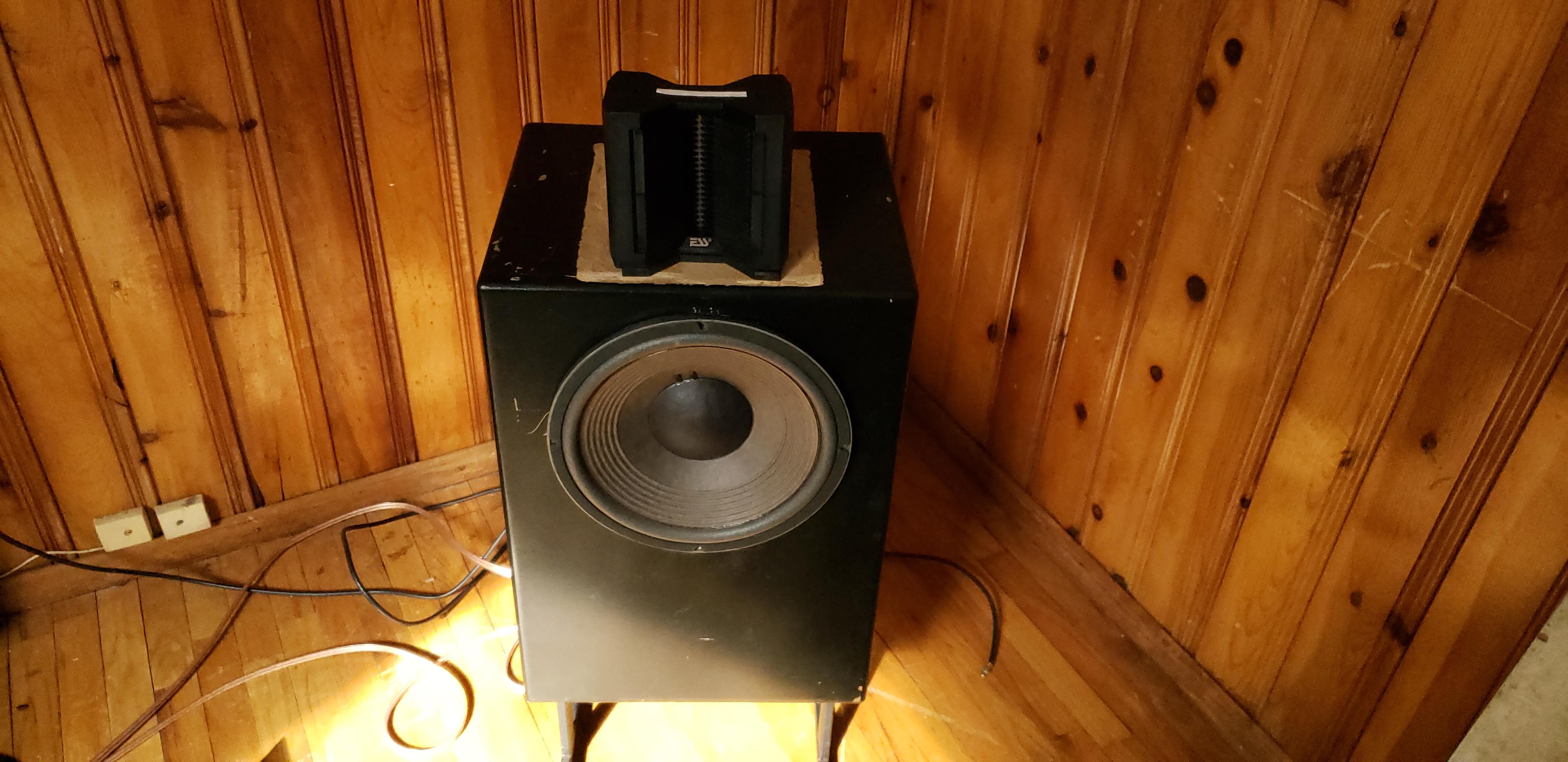

Got my pair up and running in a bi-amp set-up with a notch to tame the peak at 5K. Using a JBL M552 at 850/900 24db L/R into a pair Crown PS-200's Using JBL 121A's as woofers. Really nice combo. I can see why people like the Heils as much as they do. Well worth the money great bang for your buck!
They sound really nice and the overall balance in the room makes it so you can move around and enjoy them. Image just kinda floats big open sound and very dynamic as well.
Ended up getting the mounting kits they have angled pads to tilt the heils up a bit and all the mounting hardware.
Rob:)

I'm using mine over a RS225 crossed @ 1.2k bi-amped (Crown XLS) using miniDSP 4x10 with a high shelf setting @ 5k -5dB. I'm really happy how they sound. I also regret not getting a 2nd pair :D Still, at $170 the current price, a good deal.
I would think you are losing a lot of 'sparkle' with a shelf that low. I'm also using a MiniDSP .. I put in a narrow 3dB dip at 5KHz and then a slight high shelf starting around 12KHz.

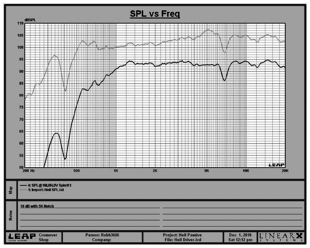

There seems to be quite a descepency amongst differing measurements of this driver ie: some show dips at 5k while other show up sloping with peaking at that frequency including even more a convoluted response shown by a project a Dennis Murphy did for Salk requiring quite a bit of component shaping. I’m holding up on trying these until there is a more unifying consensus.

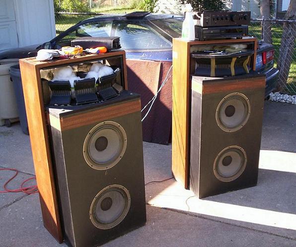

New guy here with questions. Have missed my ESS Heils since I gave them up in the 80s (young regretted stupidity stirs). You guys have lit my Heil fire so I'm looking for help and direction. I've been debating buying new ESS speakers but I've got it in my mind that I can get a better speaker with a custom build. I'm not a DIY'er and want to find out what will work best and have a cabinet/speaker builder do a custom build.
...or should I just buy new ESS speakers?
I want them for my home theater L/R. I'm thinking I want a taller low end box with a 12 inch front ported tall enough to get the Heil centered at about 42"high. I need them to behave and perform well in corner placement. I've heard mention that Altec 416s, JBL 123s or even some other high end full range drivers are the way to go with the great Heil.
Love what you guys are doing and appreciate your thoughts and direction. Thanks

Appreciated input, How would you execute that? A low end box partitioned for a midrange? What drivers would you recommend. And back to one of my original questions especially to folks with your ESS experience....is it worth my effort to do a high end build compared to just getting one of the new ESS speakers? I know that's subjective, but the input here is invaluable.

Well the original AMT 1 used an 18dB 800hZ crossover point. I am using 24dB L/R active at 850Hz. When I measured mine they had a rising response and issues well below that as far a lower crossover point.
650Hz? Based on what I measured it looks possible. Upper trace raw measurement.
Rob:)
