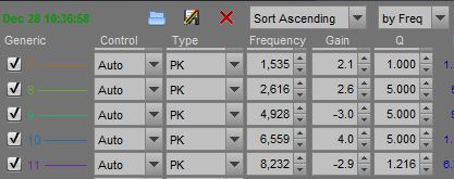

By the way, my AMT-1s actually have several response corrections:

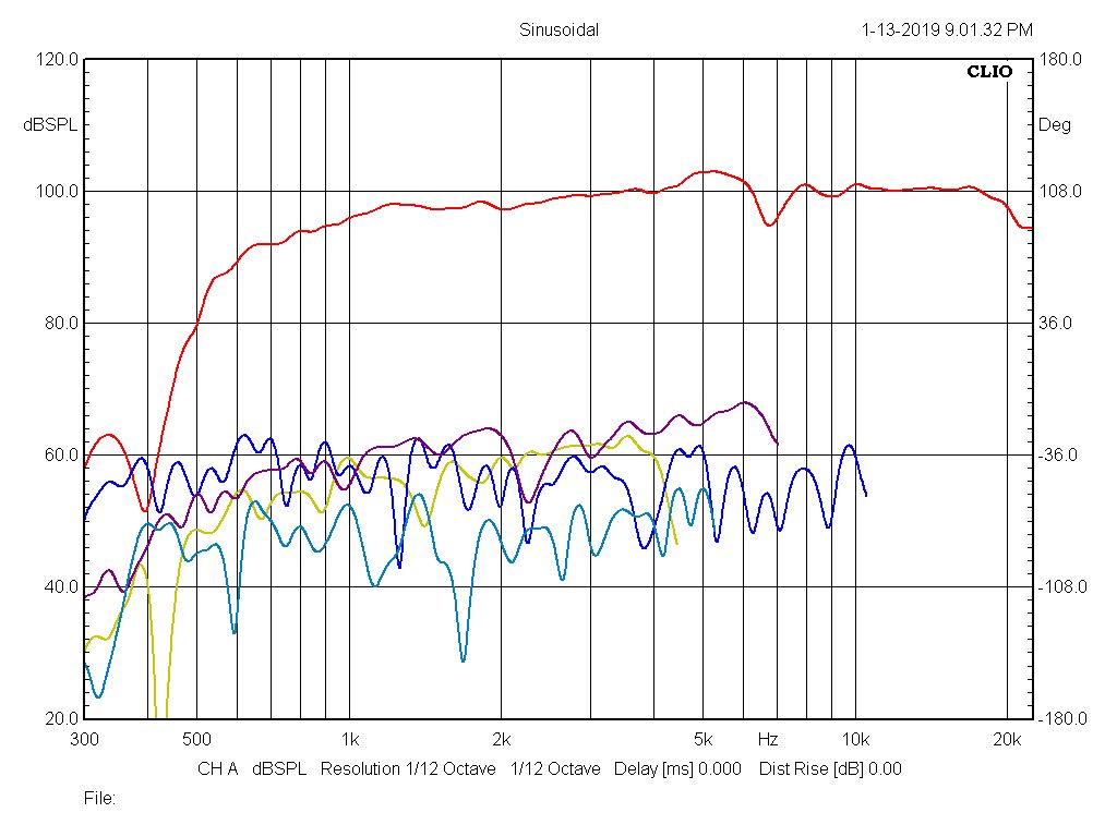

I just purchased my drivers and I just did a couple of sine measurements to see what my new drivers were doing distortion wise. This is them with the test signal going through my 24db L/R crossover set at about 850Hz. I can't see any rise in distortion in the measurements. They look fine the the distortion level seems constant without a LF rise. Don't let the 100Db throw you that is not a 1 meter measurement about a foot away so in close. One is THD the other has it from 2nd to 5th.

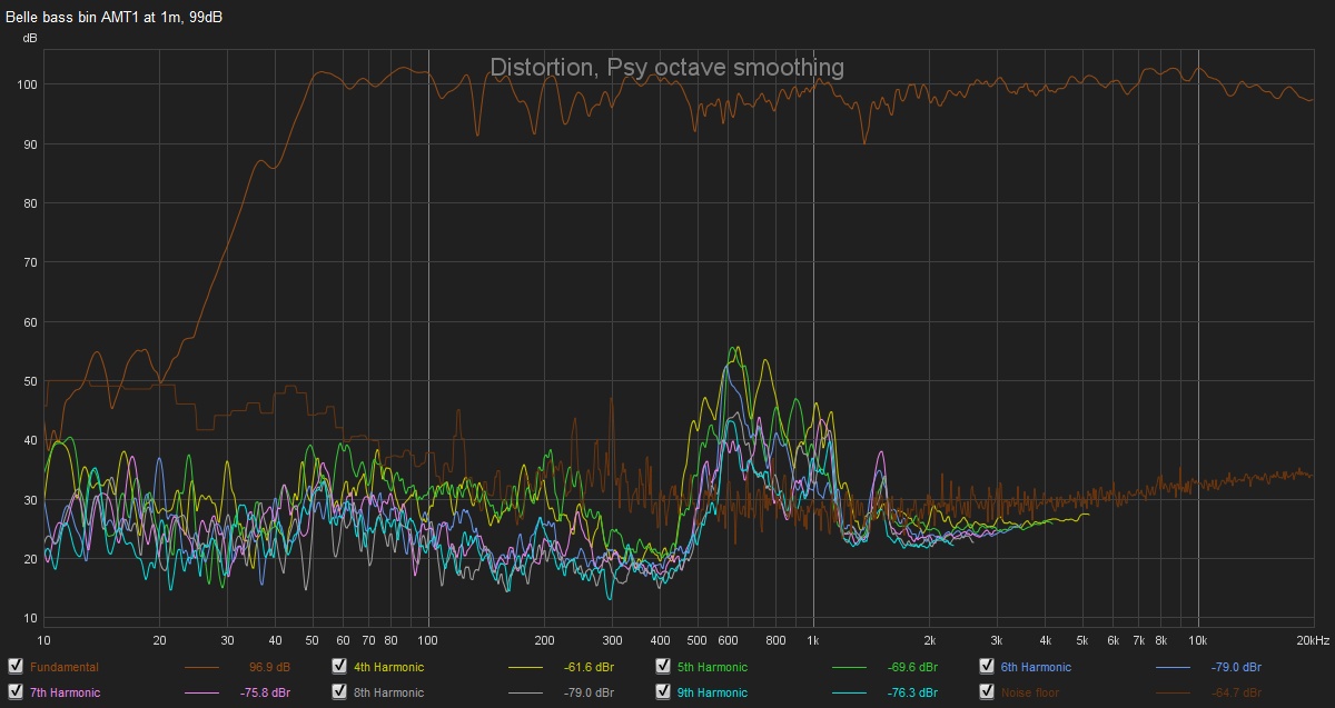

The first plot is at 99 dB at 1m (Belle bass bin + AMT-1, crossed 1st order at 650 Hz):

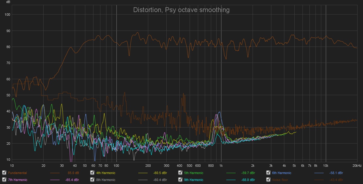

and the second plot at a more reasonable level of 84 dB for my application (the higher-order distortion harmonics are basically below the noise floor of the room):

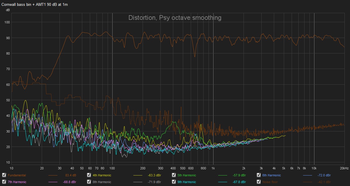

Here's a plot of another 2-way (Cornwall 15" woofer bass bin, AMT-1) crossed at 800 Hz using 1st order filters, 90dB at 1m on-axis, but having the additional issues of a direct-radiating bass reflex design (much higher modulation distortion and significant group delay growth at the port frequencies):

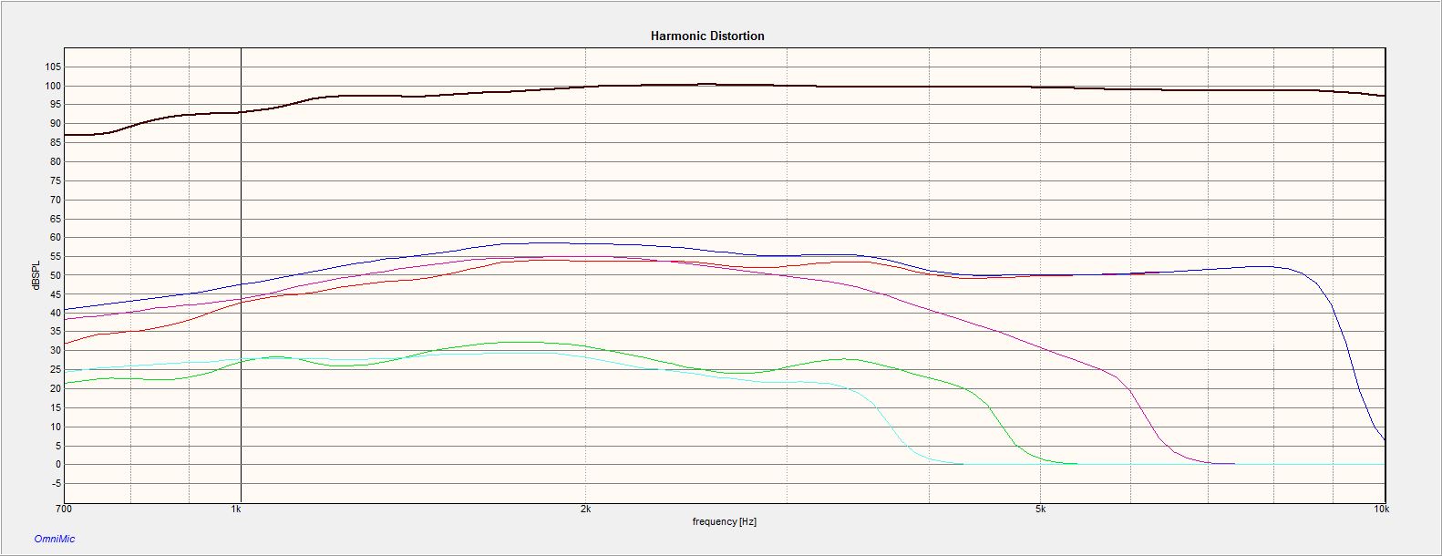

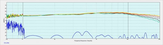

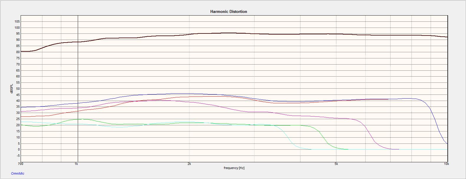

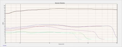

Distort at 95 and 100 db shown at 1/6 oct smooth at 1 meter . Blu 1st, red 2nd, purple 3rd, grn 4th, lite blu 5th
Horizontal dispersion out to 60 degres in 10 deg increments shown with no smoothing, 3ms gate, 18 inches mic distance

..that very impressive for such a small radiator. 😎
Yes it is. She can move without coming apart. Understandably I've been accused of fudging the data.

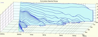

Heres the CSD at close mike of a unit from a few months ago. Newer units have things down to zero within about 1.5ms all the way down to 1 k. Not sure I can see the CSD of the Stage A. on their site and different measurements systems and conditions make it impossible to compare anyway.
