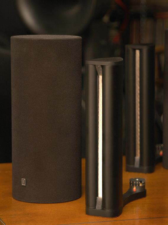

Hello Clavin,
Interesting , quick question , have you ever tested your ESl and if so what are you using to do so .

I agree with most of what was said, with a few exceptions. Corrugation of the ribbon element is mostly determined by size and use. Different methods of corrugation will help in controlling resonance in the audio bandwidth being used . Going flat on a thin High freq ribbon will work and work well , will not do so on a 1.5 inch width foil running a wide bandwidth. Corrugation can be extremely extremely rigid to a moderate fold but running flat on a large ribbon going below 800 hz will suffer from resonance issues, distorting the sound. Some corrugation will be required if for no more than to move the resonace frequency.

LineArray said:
I think it is all about controlled motion of an area of foil or film.
Whether driven by lorentz force or electrostatically does not
matter to our ears. Using electrostatic force it is maybe more
easy to apply that force to a larger area. Using lorentz force
this is more difficult and you have to introduce voice coil like
structures on the moving foil by glueing, printing or vaporizing.
In case of a magnetic transducer with large area the shape of
the magnetic field gets more complex, because you will need
more than one N-S pole and you cannot avoid to place magnets
in front or behind the diaphragm.
Thats why a "true" ribbbon tends to implement a line source.
This is the "natural" way of constuction, which is able to
keep the diaphragm free from disturbing magnet structures in
front or behind, thereby allowing dipole radiation
if you want.
But the normal way of doing this, using a long ribbon
fixed at its short ends and folded or rippled multiply along
the short side, leads to some disadvantages.
- the ribbon produces a bowing along the long side when moving,
with maximum excursion in the middle. This is commonly solved
by introducing some more fixing points along the ribbon, if its
a really long one.
- there is a long slot at both sides of the ribbon, it cannot
contact airtight to the magnet pieces. Both slots are bordered
by the diaphragm, which is thin and sharp.This causes noise and
distortion with higher excursions.
- because of the high excursion in the middle, the magnetic
gap has to be rather deep along the whole length of the
ribbon to obtain a homogenous field, even though you would
not need that depth of the gap along the whole length concerning
excursion only.The deep magnetric gap will cause protruding edges
in front and behind the ribbon, which spoils radiation pattern
and proper acoustic coupling with the surrounding air.
- it is impossible to adjust the diaphragm to a resonant frequency
high enough for practical efficiency unless using tension along
the ribbon - which in turn causes AGEING.
All of those problems can be solved by using a folding along the long
side of the "ribbon".
- The long sides can contact the pole pieces in an airtight manner.
- Excursion is - mutually - the same over the whole length of the ribbon.
Depth of the magnetic gap can be reduced, the diaphragm can be
mounted to change almost flat into the speakers cabinets baffle.
- Resonant frequency is tuned by appropriate folding (rippling)
concerning the mass of the diaphragm material used.
- The structure can be mounted into the frame without using tension,
which yields very good long term stability.
- Even this structure will bend when driven, but the bending mode will
improve the horizontal radiation angle, because it bends along the
short sides.
To be honest, by folding the long side, there arise some technical
problems. E.g. the electrical contacts at both ends have to be designed
not to disturb the bending motion or to introduce bending in unwanted
directions. But that can be done by proper design and experience.
IMO this kind of "ribbon" is in advantage over an electrostatic
device in at least three aspects:
- capability of large linear excursion
- far less diaphragm area needed, which leads to far less
problems with unwanted vibrational modes and beaming
- unobstructed area in front and behind the diaphragm
And by the way: This is exactly the way it sounds.
Regards

of course wayne, have the panels as well as the complete speakers been tested. 🙄
Starting from quickanddirty measurements with an DLSA (cheap mic) over DAAS32 (with MB550 mic) up to MonkeyForest (with 1/4" and 1/2" B&K mics).
Measurements we did ourselves and measurements in the big measuring room (low reflectivity) of the University Aachen (measured by Anselm Goertz, who undoubtly knows how to measure things correctly 😉 )
Both speakers exhibit extremely low distortion values. The big one measured lower than 0.2% in its complete frequency range (25Hz-20kHz) at a SPL of 95dB@4m. The small panel limits at 110dB@4m thereby measuring less than 0,3%THD over its working range (200Hz-20kHz). The THD values consist of nearly solely K2.
A typical measurement of SPL values is done at a distance of just 1m. For a 4m distance measurement 12dB should be added.
These are extremely low distortion values (You have to keep in mind that the measuring setup itself introduces a certain level of distortion. Distortion measurements with the DAAS32 and MB mic showed higher -still though comparably low- values, but prooved the MB mic to distort more than the B&K capsules and already more than the speaker itself.
The values found are much lower than You can reach with electrodynnamic drivers exempt maybe some big horns but those are very limited in bandwidth. The 110dB@4m of the smaller panel are very close to the maximum SPL that can be reached theoretically with a panel of this size anyway!
So I guess that my panel construction and the build quality are on a niveau that allows to draw conclusions about what a good panel might be able to 😉
Ohh, btw. to return to the question 😉 The speakers have been extensively tested by many ears too. And all of them have seemed to like the sound alot 😎 At least the one who declares that he/she dislikes the sound has not spoken to me yet.

Hi a.wayne ,
maybe a am somewhat blind but i cannot see any conflict with
what i said. I agree fully with your observations concerning
the need and the use of corrugation.
When used fairly above the resonant frequency and higher
excursion is not needed (due to diaphragm size), a
flat foil might perform very well.
In my own ribbon design i introduced that corrrugation mainly
because i wanted to get down to 800Hz with an 8mm wide
diaphragm thereby keeping a controlled motion.

LOL.
Calvin .2% THD ( 25-20K) forgive me for having a hard time in accepting that. I'm sure you and others enjoy the sound of your speakers, audio and subjectivity goes hand in hand , scratching for objectivity is the real nirvana in audio . TO say you have an ESL speaker that has .2% THD from 25-20K is unheard off on this planet or any other that i have visited in the last 10 eons, I guess you are being tongue in cheek. 😀 if not, then they are not an ESL , but more likely some Clingon verberator running on pulsewidth germainium.
High efficiency DIY ribbons use 0.5" to 1" wide NdFeB magnets to create 0.5T-1T flux in the gap. What is the best solution to minimize these magnet cavity effects on a true ribbon?
Any experience or measurements with "waveguide type" front bezel curves, or RAAL type "triangle cut" bezel plates?
www.transmissionaudio.com posts "extremely low" distortion measurements for ribbons
When using "conventional" ribbon shape the answer is
simple: The problem stays.
Both solutions you mention (sawtooth border of front bezel,
wave guide) seem applicable to deal with that.
Maybe covering the magnet/bezel using soft and porous
materials can help too.
I used a waveguide in my own design once and was not
statisfied with the result.
I heard the Crevasse at an audio fair some years ago.
To me it sounded rather warm and balanced in the
midrange but also dull in the highs.
There was a lack of resolution and "dircectness" which
made me wonder why to use a ribbon at all ... But i do not
think that the waveguide/horn was responsible for that.
Although it is a very impressive and aesthetical design
to me, but was one of the greatest disappointments
sonically.
With a different transducer design i think there would be
higher potential. Maybe they changed somewhat in the last
years, i don't know. The Crevasse transducer that i have seen
had more than one conducting lane on its diaphragm,
so we can discuss if it is still a "true ribbon".
I don't like the term "true ribbon" by myself, but if used i would
apply it to those constructions, which have only one conducting
lane, which is the made of the diaphragm material itself.
Personally i would not bind "truth" to the way the ribbon
is suspendend/folded/currugated.

RAAL's "raindrop" tweeter designed to be crossed over 3,000 Hz uses a "waveguide" type bezel for diffraction and directionality control instead of the sawtooth metal front bezel of their higher volume ribbons which are spec'ed for 1,500 Hz crossover.
Would the raindrop waveguide be a more expensive solution that can reduce distortion over the lower cost sawtooth bezel, or.....
The raindrop waveguide bezel might be used to increase SPL to match a compression horn efficiency.
The raindrop waveguide bezel might be used to better match the directionality of the horn tweeter.
A sawtooth bezel would be the easiest solution if it also produced the best sound with deep magnetic cavity ribbons.
Waveguide vs. sawtooth bezel is still the good-better-best question.
