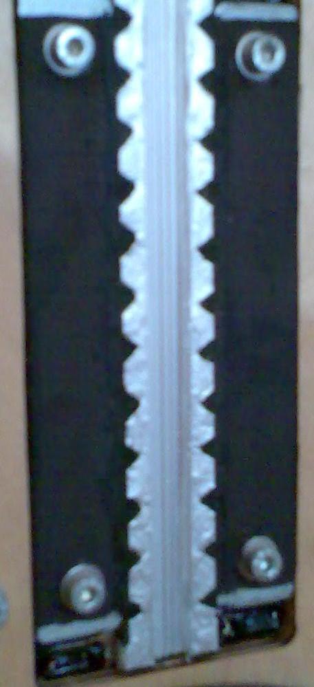

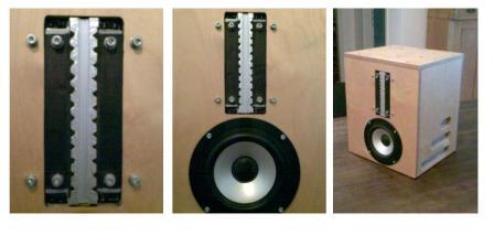

Re: ribbons vs electrostats
I think it is all about controlled motion of an area of foil or film.
Whether driven by lorentz force or electrostatically does not
matter to our ears. Using electrostatic force it is maybe more
easy to apply that force to a larger area. Using lorentz force
this is more difficult and you have to introduce voice coil like
structures on the moving foil by glueing, printing or vaporizing.
In case of a magnetic transducer with large area the shape of
the magnetic field gets more complex, because you will need
more than one N-S pole and you cannot avoid to place magnets
in front or behind the diaphragm.
Thats why a "true" ribbbon tends to implement a line source.
This is the "natural" way of constuction, which is able to
keep the diaphragm free from disturbing magnet structures in
front or behind, thereby allowing dipole radiation
if you want.
But the normal way of doing this, using a long ribbon
fixed at its short ends and folded or rippled multiply along
the short side, leads to some disadvantages.
- the ribbon produces a bowing along the long side when moving,
with maximum excursion in the middle. This is commonly solved
by introducing some more fixing points along the ribbon, if its
a really long one.
- there is a long slot at both sides of the ribbon, it cannot
contact airtight to the magnet pieces. Both slots are bordered
by the diaphragm, which is thin and sharp.This causes noise and
distortion with higher excursions.
- because of the high excursion in the middle, the magnetic
gap has to be rather deep along the whole length of the
ribbon to obtain a homogenous field, even though you would
not need that depth of the gap along the whole length concerning
excursion only.The deep magnetric gap will cause protruding edges
in front and behind the ribbon, which spoils radiation pattern
and proper acoustic coupling with the surrounding air.
- it is impossible to adjust the diaphragm to a resonant frequency
high enough for practical efficiency unless using tension along
the ribbon - which in turn causes AGEING.
All of those problems can be solved by using a folding along the long
side of the "ribbon".
- The long sides can contact the pole pieces in an airtight manner.
- Excursion is - mutually - the same over the whole length of the ribbon.
Depth of the magnetic gap can be reduced, the diaphragm can be
mounted to change almost flat into the speakers cabinets baffle.
- Resonant frequency is tuned by appropriate folding (rippling)
concerning the mass of the diaphragm material used.
- The structure can be mounted into the frame without using tension,
which yields very good long term stability.
- Even this structure will bend when driven, but the bending mode will
improve the horizontal radiation angle, because it bends along the
short sides.
To be honest, by folding the long side, there arise some technical
problems. E.g. the electrical contacts at both ends have to be designed
not to disturb the bending motion or to introduce bending in unwanted
directions. But that can be done by proper design and experience.
IMO this kind of "ribbon" is in advantage over an electrostatic
device in at least three aspects:
- capability of large linear excursion
- far less diaphragm area needed, which leads to far less
problems with unwanted vibrational modes and beaming
- unobstructed area in front and behind the diaphragm
And by the way: This is exactly the way it sounds.
Regards
a really long one.
short sides.
Regards

fivestring said:@LineArray,
Awhile back I was thinking of vertical corrugation too,
but was wondering if the air load in front and back of the
ribbon would put too much pressure on the foil and force
it to expand under higher excursion, which in turn could
cause a short circuit
(I hope I understood what you said, the photos have really
low resolution).
Hi fivestring, i think i understood the effect you feared.
Maybe unwanted expansion of folds when diaphragm is
loaded with over/underpressure at both sides respectively
could occur, when the folding is too deep and "edgy".
But that kind of folding is not desired anyway because the
compliance across the short side would be too high, giving
a fs which is too low. Such a folding would additionally increase
diaphragm mass to a higher extent, because more material is needed.
With the corrugation i used, this is really not an issue.
I tried to attach a better pic. The folding symply looks like
a miniature corrugated iron.
I thought of upsizing my tweeter before. To make it taller is no
problem. To make it wider (8mm wide now) is more tricky.
Using the same corrugation pattern, compliance will increase and
mass too. Which is your desired fs ? (100...200 Hz ?)
Maybe the corrugation has to be modified into flatter, maybe
at a certain point one has to think about a stiffer foil, i don't
know. But i feel probability is high, that one could make it wider
by changing nearly nothing.
I personally would not go to a completely flat diaphragm, because
i would fear uncontroled motion at the upper end of the frequency range
with a diaphragm 2cm wide. But i havent done it and maybe it is a way to go.
Would reinforcement of corrugated borders help at higher
frequencies, if the diaphragm is flat ? It seems rather complex,
but again maybe your idea is right.
I would like, if you kept me updated with your experimenting,
because someday i'd like to upsize my prototype and any
experience is valuable.
