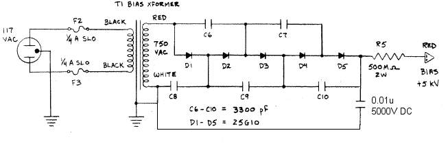

Both speakers ( ESL /Ribbon) has it's pros and con and for the original poster i would suggest to build a hybrid RIbbon , the electrostatic's would be more complex for a novice and more expensive to build. The heart of an ESL is the power supply and a good PS and AT makes it more expensive than the ribbon...

A.Wayne hopefully I have attached a schematic that as you will see is simple and not expensive to make. With some basic mods this supply will work very well. This is what Jim Strickland used in the Acoustat. I have seen simple converter HT blocks that are the size of your thumb that you run off of a small wall wart for $10.00 that would probably work as well. The supply does not have to cost a lot. I would say that you will end up spending the bulk of your budget on the step up transformers though used deals are out there.
If my attachment does not connect you can see theis supply at this page. http://www.izzy-wizzy.com/audio/spkrif.html
