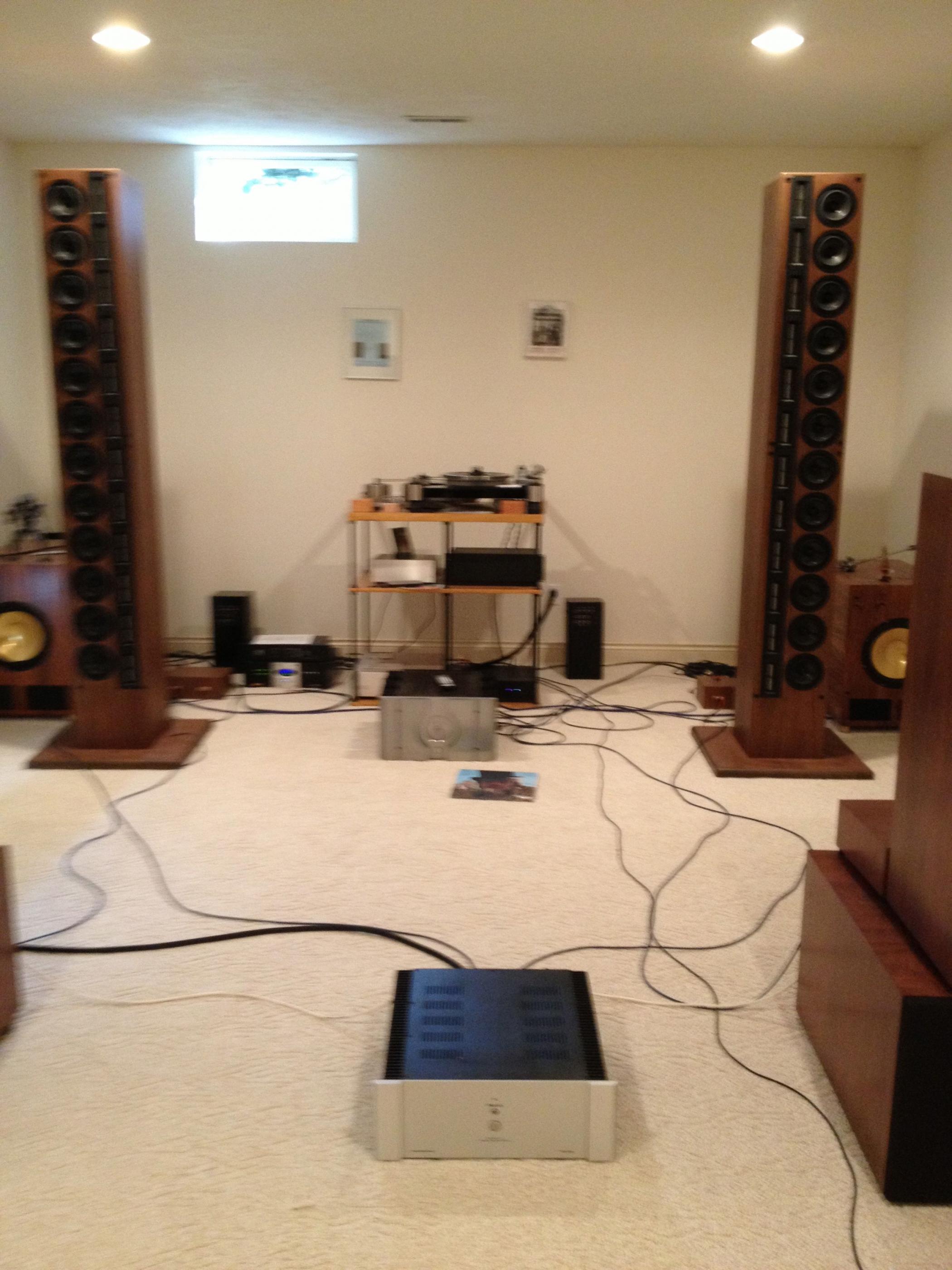

Well I don't know if I have to apologize or not but I fell off the DIY wagon and bought a used pair of XA100.5 power amps. Yes I know that I built a pair of x amps from this thread which were actually a converted pair of Aleph 200's I had built in 2001. I also have built the Pass/Thoroguard A75 which I am retiring after 23 years of faith full service-it is starting to hum and I suspect the poor caps.
The question I have is that I have bi amped line arrays. I also bought about 6 years ago a Pass X350.5. The idea is to have an all class A driven loudspeaker.
I am now beset with do I use the 350.5 to drive the tweeters as for sure it will never leave class A or use it on the mid/woofs where it just might happen? Crossover is at 2700hz.

not really enough info
wee need you to cover other possibilities , same as more info about spks and amps - are you using just these two amps , is there subwoofer (needing an amp or two ) etc .
off course it looks as blasphemy using so potent amp just for tweets , when you can have smaller - more economical one , and in same time most probably sweeter sounding

Hm, U definitely have to apologize! 🙂
Kiddin; U cant focus on class A, B or whatever in that way. There are AB-amps that are totally usable in your setup. U could build a good AB-amp and compare to a bad A-amp untsoweiter. There are several ways to move distortion out of an amps window of operation.
Thanks guys, the speakers I designed and built, the turntable is a VPI TNT 5 plus that I put together over a 5 year stint. The phono pre amp is a Borbely all j-fet design with shunt regulators that I built from Audioxpress. The Pre amp/dac is the DEQX speaker correction and room correction unit used in an all balanced set up. I have also built the transcendent 160 watt OTL's which also sound very good. However after 30 years of experimenting I really like the class A sound that the Pass amps give. Yes it has taken me quite a while to obtain them but the Aleph 200's I built sold me on the sound. The trouble is now my ears are getting wore down. My wife says I can't follow verbal directions properly. I buy used records for 50 cents, clean them, coat them and listen.
I get the records at shows and from a dealer crazier than I am. Next step is internet downloading at 24bit-96hz

nice to see the entire set-up after all these years of looking at your line-array images.
Welcome back, btw.
