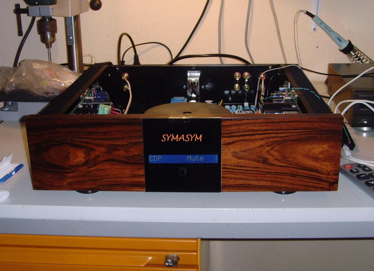

I have started and married the "Black-Beauty - SYMASYM" (which is in fact green in my prototype-case) with my auxiliary "DC-Mains-Filter, Soft-Power-On, Digital PSU - and RPre - PCB".
Everything works as designed so far, but I have to re-program the PIC-processor to be able to show all the information that it is able to show on a single 1x16 chars display.
"In my hunble opinion": I could not have this done better!
Best regards - Rudi_Ratlos
Great work! Do you have the analog volume control going to a volume pot on the front of the amp that cannot be seen in your photo? Why not move the motorized pot to the front panel so you can do both - remotely and manually? Am I missing something in your intended design? I haven't started my build, so maybe I haven't read far enough yet. :)

I can see in the picture the motorized pot laying somewhere down on chassis. I'm sure the pot will be installed on front panel.
@Rudi - you moved from Bourns to Alps ? They have a better resistence consinstency ?
Yeah, I saw the motorized one laying there, but just didn't want to assume too much. When I saw the connector labeled analog attenuation with a red and white wire, I couldn't find the other end, so wondered if there was another pot somewhere. Silly me. :)

Rick, Adrian: since all the functions (Power On/Off, attenuation, source selection, ...) can be controlled via a remote control unit, I do not need a switch, neither do I need a knob on the front panel.
This is the reason why I have installed the motorized dual potentiometer into the case.

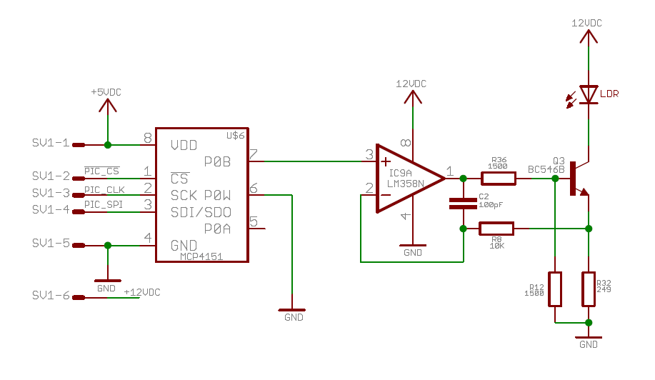

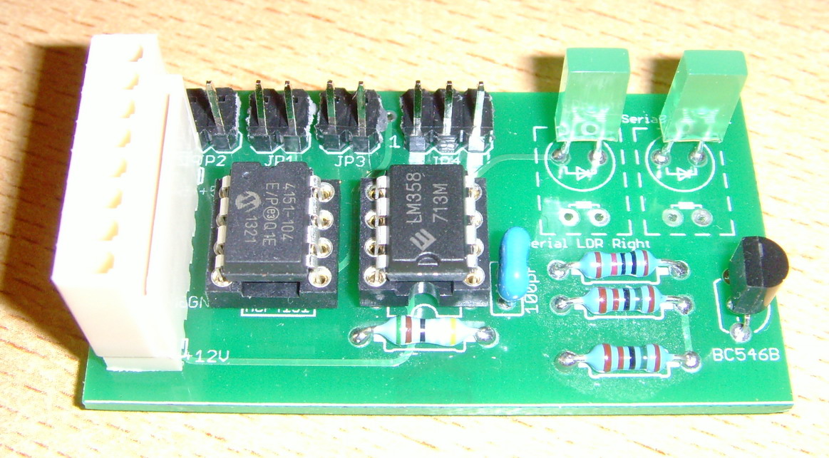

But this potentiometer looks like (is) a real anachronism, and I would like very much to replace it by a "digital potentiometer" (MCP4151, which has 128 wiper steps) followed by a VCCS (see attached image 1).
I have already done a layout for this schematic and have etched and populated two of the resulting PCBs (see attached image 2).
I am using simple LEDs instead of LDRs on this "evaluation-PCB".
My problem: I am no good at programming a PIC - µProcessor in "C".
I have been programming IBM-mainframes in Assembler for more than 35 years of my life, but now, when I program a PIC in "C", I get lost and desperate, if I forgot to insert a ";" or a "}" into the code.
I am of course able to change the existing VCPre's code (whose inital programming has been done by METAL), if required, but implementing a new function, ...?
If there is anybody among you (I am sorry that Paul does not have the time), who has the time to assist me, who knows the internals of the PIC16F887 and has a PIC-evaluation board and who knows,
how to program it in "C" (for example the SPI-interface): I will happily send him one of the two evaluation PCBs and will program together with him the digital potentiometer interface.

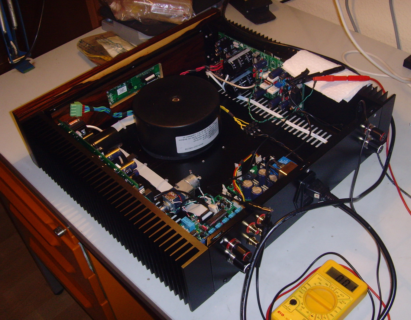

Dear SYMASYM-friends,
I have had some time yesterday and have adjusted the quiescent current of my current SYMASYM - build (the left channel - without using the light-bulk delimiter anymore).
I have measured the DC-offset on the output during the adjustment phase.
There is no DC-offset at all. Andrew_T will appreciate.
I will go on with the right channel today and do some thinking about the case's front panel.
P.S.: Before you ask me: I am using a Wall-Market speaker-cable (1 meter costs 3€) and RG59 - RCA - cable for internal wiring.

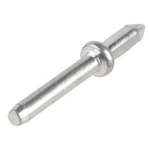

1.3mm Soldering Pins?
Could you post a picture of what a 1.3mm soldering-pin looks like that is used in your VCPre? I assume they are individual vertical pins, rather than some type of connector. What do they look like?
Thanks.
Similar to this?
