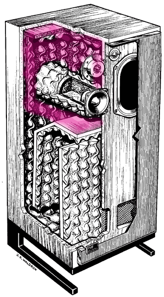

The Fried kits have the same roots as the older IMF. I was illustrating the Fried designs showing the enclosures design and damping material placement. I would just print the document. The most you can do is copy and paste it. A wide variety of 10" drivers work well in these enclosres. Adjusting damping density behind the driver the most critical area of the cabinet volume. Small changes in damping density shown in many of his kit plan designs using the same enclosure with different drivers. Examples are O1 ,O2 and O3 models until cabinet designred changed to O4 model.
Bailey used wool. IMF used foam. I wouldn't refer to the IMF lines as a prechamber.
Early IMF lines used wool, but for ease & consistency of production switched to foam.
In the attachment, the prechamber, which takes up ~ 1/3 of the box, is hi-lited.
dave
