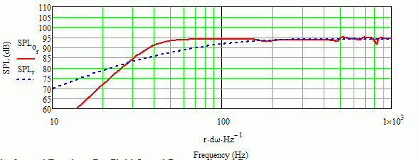

Your driver in my MLTL:
40"x9.5"x10.5"
Driver 10" down
Port 4"x6" 35" down.
F3~40Hz, F10~30Hz
