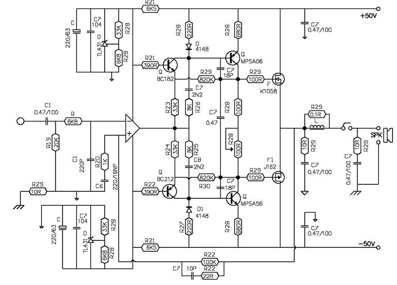

Sorry guys, in the earlier post I've asked for suitable replacement for LM339 but after obtaining the schematic of my amplifier a few days ago, I've found that it is used in the protection circuit. Anyhow, I have made some modifications to my amplifier.
1. Bypass the selector switch by connecting directly the RCA socket to the volume control and to the amplifier circuit using silver wire.
2. Changing the aged capacitors in the circuit with those from WIMA & Panasonic.
3. Changing NE5534 with OPA2134/NJM2114 with BG caps across its supply.
After comparing both chips, 2134 gives solid image but I find that the bass a bit too much. Whereas the 2114 gives more balance sound but not solid. Anymore chips that I could use? As my CD63 is upgraded before with AD8065 & BG caps, I was thinking of using the same chip as well.
Somewhere in the forum, I have read that there is some low noise transistors. Is it true?? I have attached the schematic and maybe you guys can give some comments. Thanks.

Use a TLE-2074
TI has come out with an enhanced replacement to the TLO-84.
It is the TLE-2074. This opamp part of their Excalibur series, possessing lower noise and distortion and higher gain bandwidth product and slew rate. They are VERY good sounding opamps.
They also make singles (TLE2071) and duals (TLE2072).
Also, National Semiconductor now has a quad high performance audio opamp-the LME49740. It is essentially a second generation quad version of the LM4562 dual. They also have singles (LME49710) and duals (LME49720). If you use these opamps, make sure that you have sufficient power supply bypass capacitors installed, as these units have the ability to become great oscillators without them.

Can you explain the power supply bypass capacitor? Mine have a 0.47uF NP across its supply and sitting on top of the op-amp.

Local bypass, very close to the power pins, with something like 47uF or so, with good quality caps, may be necessary too, besides the film type bypass. I must confess I am not too much a fan of ceramics, even if some types seem to work quite well in audio projects.
The 0.47uF BG cap is recommended by a local DIY shop that claims to improve the sound. My next problem if you look at the schematic is what type of cap to replace at the input of the op-amp.

Yes, a cap from each power supply pin (+ -) to ground. Make the leads as short as possible.
Cap preference in this order:
Polycarbonate, mylar, ceramic disk, tantalum, electrolytic.
The best value for a bypass is mylar. They work fine and are cheap. Even Radio Shack will sell you two .22 50 volt mylars for $1.49. These are completely suitable and I use them frequently.
