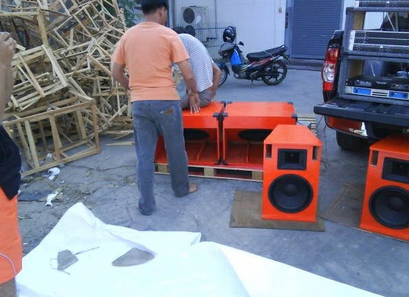

have the song kran pics last month. a friend got job in songkran day. 4 bins one eye staiple box played on truck. very enjoy guys.

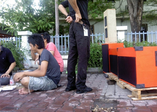

the follow pics about cyclops. we made the party to played because wanted to know these cabs are goog for out door live sound? only played a pair of them. they work great. all the sound can cover the place.
a hard time of cyclops in the stage. one pair of the cabs n with many people on the place. a pair of them can work the job.
I do not see any cyclops in this picture but only two eyed lovely creatures 🙂. Btw is this the university dress code ??????the pics played in the university. cyclops played with the other cabs in the night.

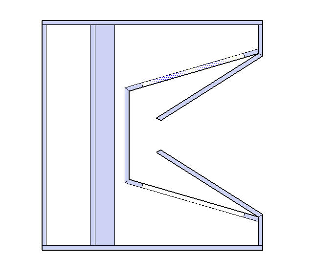

Was this calculated ? With what software?
Looks very promising.
Is there an extra benefit to firring both drivers towards each other?
wow! lol if u see on the pic n ull see two girls who stand behind. the cyclops place on the floor behind 2 girls. are u ok? Djim follow to imagine with me. suppose we go to the Restaurant in natherland. i order the food to eat(but u pay) wait a few minute, they serve the soup. yes i mean this pic like soup. u can eat delicious more than don't has the soup. or imagine with me suppose we see the sun goes down. its very beautiful with the red color in the sky. yes i mean the sky likes this pic. if no have the sky when we see that can't see it s beautiful. r u ok? guy the last Q the party in the night who will wear the cloth for study. in my country we study in the morning until evening . no have the course in the night.
the model i sent to a friend on freespeakerplan he still try to write the akabak script. the both drivers fire towards each other because i don't want the width baffle because i use 2 drvs.regards

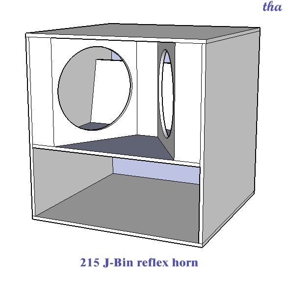

i suspect your 215 jbin responce wil be a bit like a (small)rear loaded horn.
verry efficient with a dip just above the passband.
btw i also like the second pic ,with the imagend cyclops behind😀
edit/you could try opening the bottem v-shape between the drivers for more output.
yes epa it can be more output at the upper freq. epa i change plan a little.
think that's good for kick.
