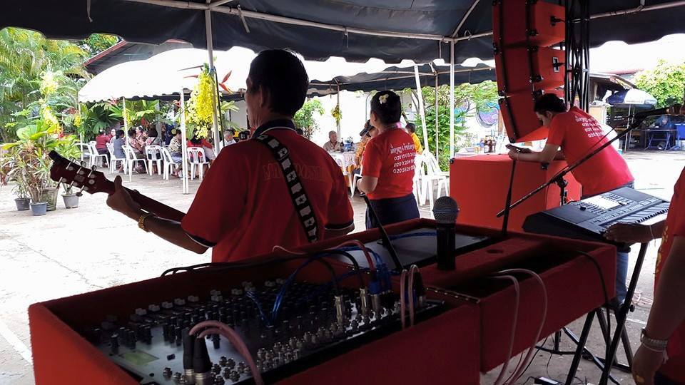

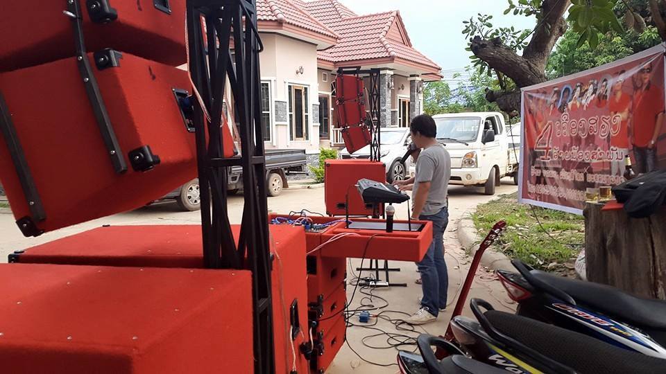

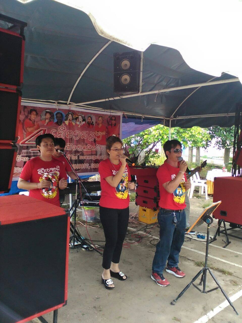

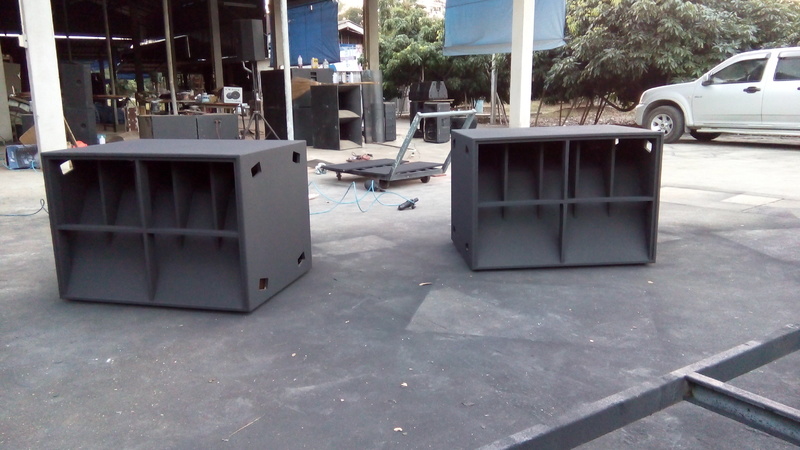

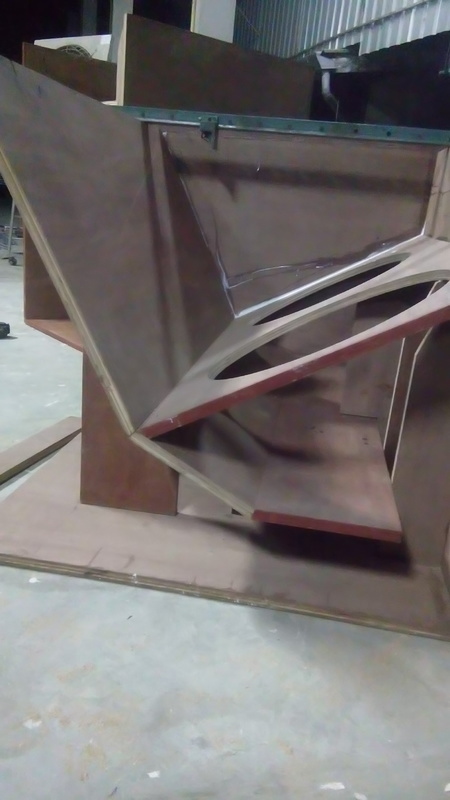

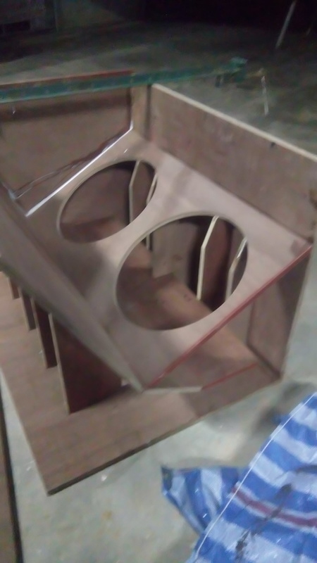

15 tha fhorn 70 played in laos

some fun videos in laos guys. they sing thai song.

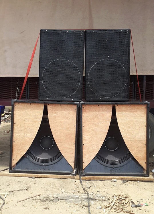

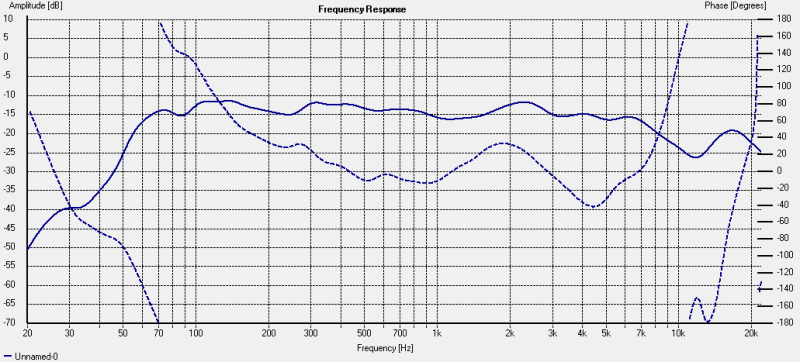

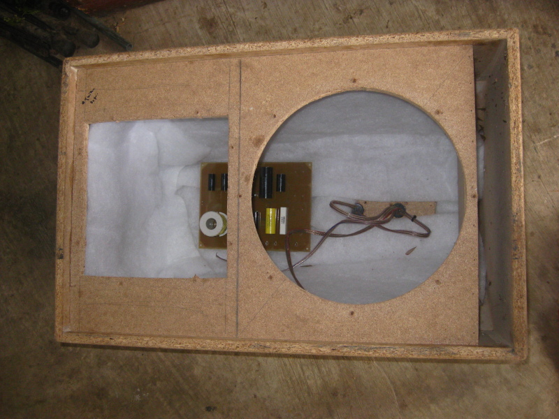

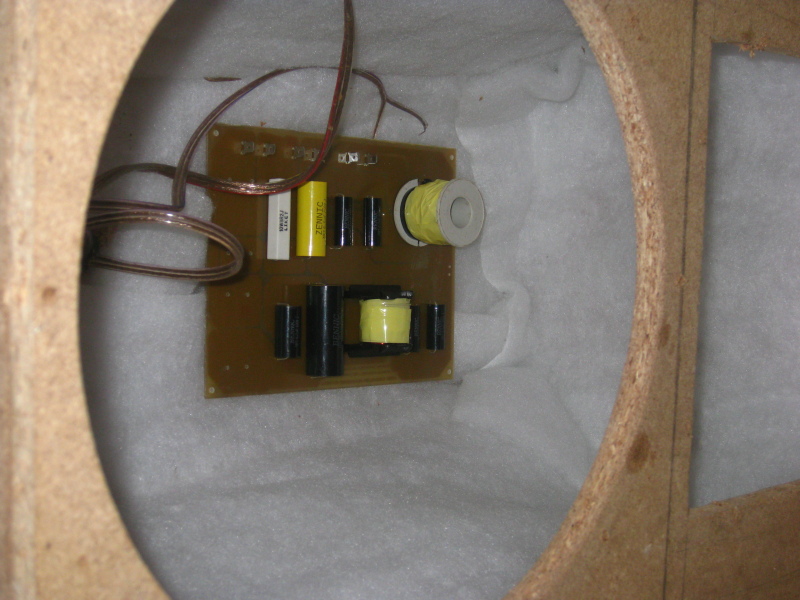

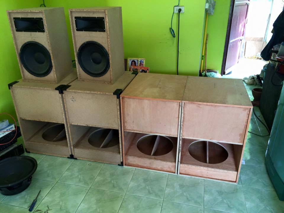

my fullrange guys
Interesting. What drivers did you use? What x-over points? Did you do measurements of the individual drivers as well? Is the 10dB drop @10kHz caused by the x-over or is it a feature of the driver?
hi Steele the 12" drv i use paudio e12-300s and nts compression drv. the measurements of the individual drivers i dint do. i saw the measurement of paudio on the pdf file. nts driver i saw a little specs from their website. its a cheap compression drv. the price is about 15 us. the 10dB drop @10kHz caused by feature of the driver. i didnt control anything too much. the point of xo is about 2khz. tq steele

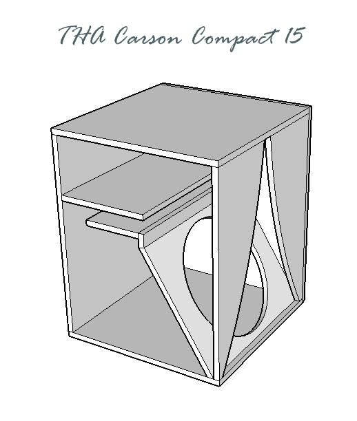

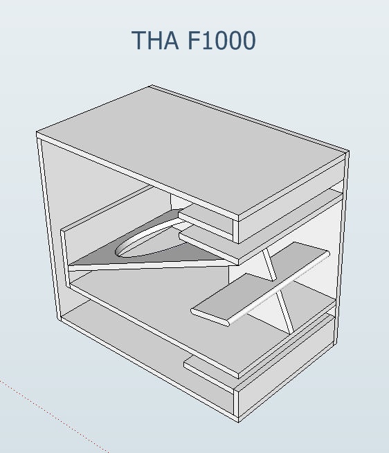

take a look at this one (post 831 also)
few people where/are planing to bild it,but none of them bild them sofar.
maybe you could take a shot at it(if you like it).
this model can be easeley tuned by simply making the boards shorter/longer.
