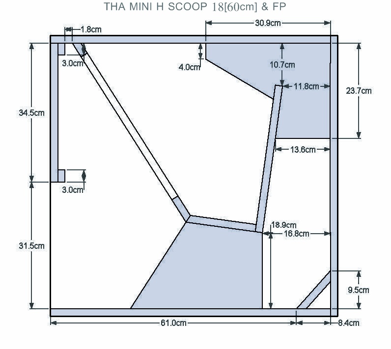

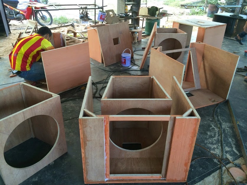

18u4 plan guys this cab i design for p audio hp-18w II the finished pics ill post the next time. 2 plans have already measured them.
First, thanks for the pic! Second, the tire enclosure is off the hook! Third, you are a sawdust beast!

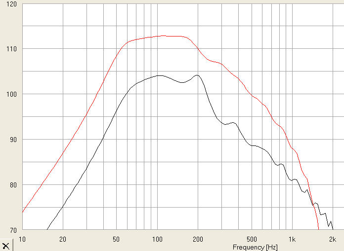

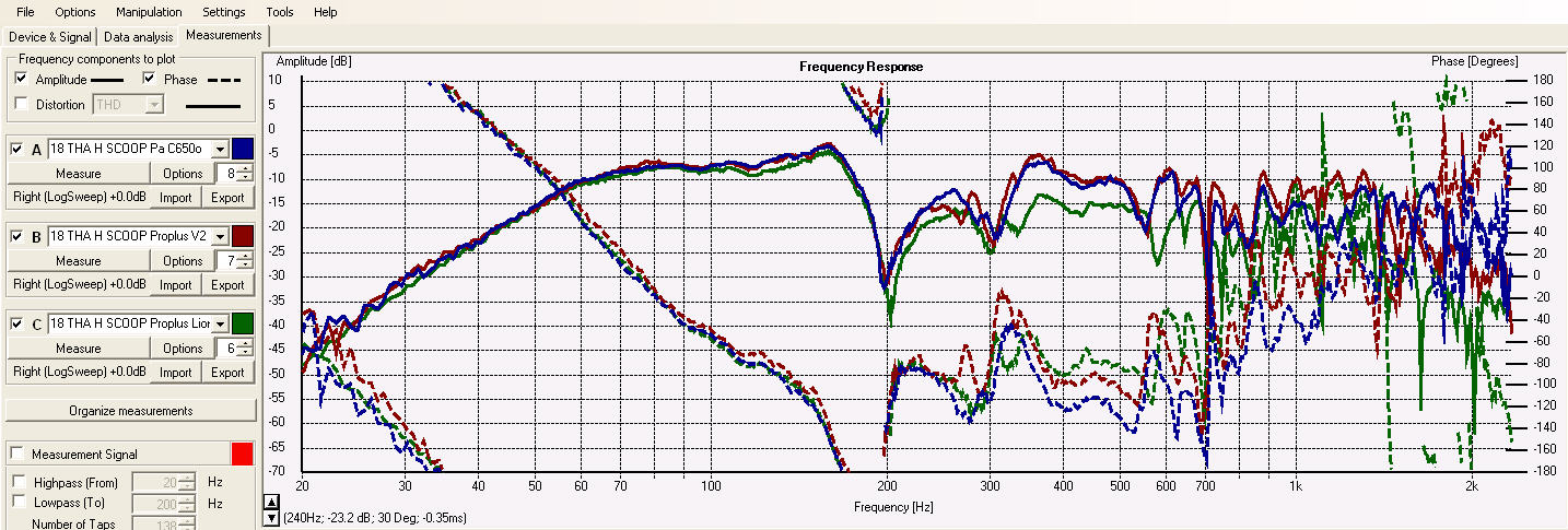

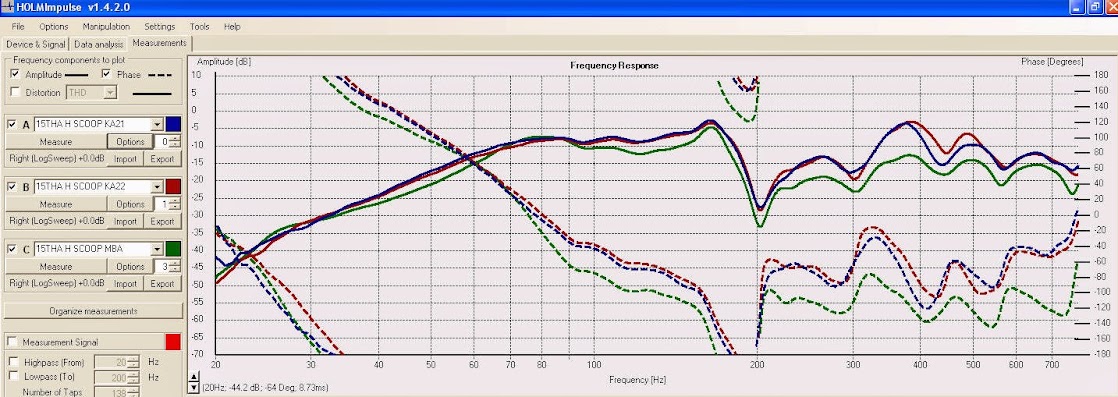

friends respond graph frequency. try to put c18-650el old series. its ok hp 18w series II dont have at the time.
the new plan will try to build. this plan i make the small chamber connect to the throat chamber. the first i try to draw exp in the front but its difficult to built. this will be easy more than. the cd horn i think will put in the front of the horn.
