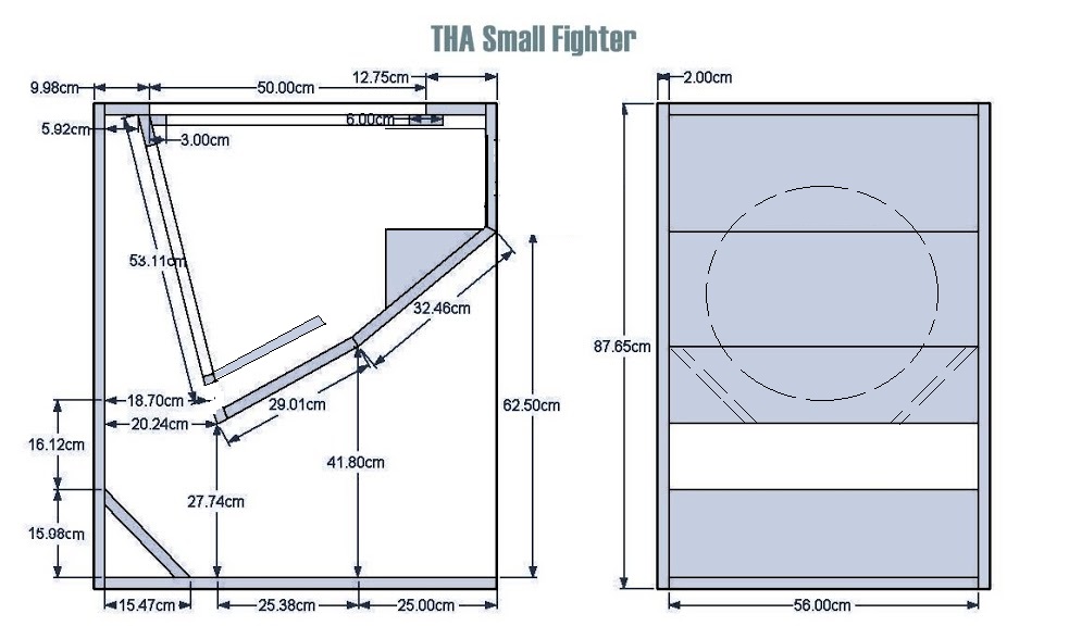

THA Small Fighter V
Thawach,
thank you for very nice pictures and you plans.
If you place the port in the throat instead of front, you will get additional 3db for the low part of the signal. It will boost the 45-50hz and equalize it with the 60hz and up.
So you will get all around nice sub with good definition. 🙂

mhh..i m interested in. think that the air presser at that location is equal the presser of a fan of turbosound. its about 25 psi. and if it s possible i will try the port location and may be small fighter v13🙂
