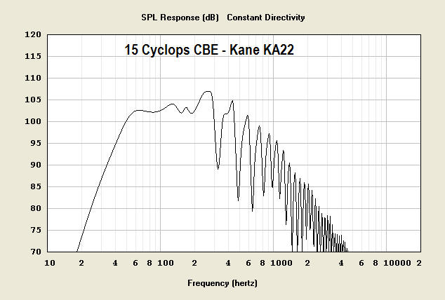

:hohoho:thanks epa all segment u are correct. the path length i measure many times ~245 cm. low knee is about 42 hz. the first thought made me worry. the xmax of the drv is 4.3mm but my friend wanted to try. a big fight die to die guy.
the pics after my friend was finish the frist one. he was satisfy very much. its yes that he looked for a long time. imagine like the ufo come to his home

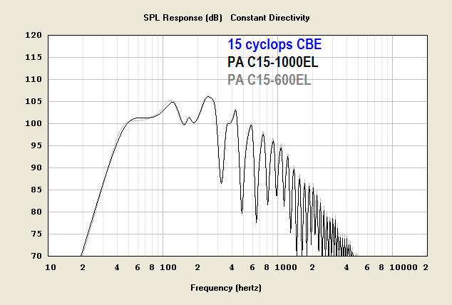

thanks BP1Fanatic for the reply. today i have the pics. a friend built a pair fullrange boxes. he used the new special material . the material for take a bath. all the things he he designed by himself. he practice win isd. after finished the sound will be ok. very good and best performance. please see the pics.
the graph i sim with p audio c15-1000el that i got the parameter from the p audio. its a new drv my friend bought 2 drvs. its expensive more than e15-300s and the cone is better than e15-300s. and i sim the Kane is good as the same

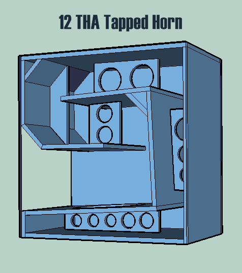

@ 26 jenny month have the pa meeting 2 place as the same times. the one place is in songkha province in the southern of thailand. it s near the phuket. and the second place is roiet province in the isan location. the location of big product tha f horn. the pics i wlll post the next time. in the south im not still getting the pics but on get the video. 2 days they built many boxes. most of the boxes that i designed. the other design hv the tham12 and tham 15 , hv a little joke when my friend built mistake plan. the words tham 15 it seems like tha 15 . that friend built tha15 that the plan i canceled last years ago because i dont like the path length of it. its not beautiful. the last day tha15 was finish one box. but when tested would be ok. after fininished many boxes. its very surprised when had the ratting the sub. tha comp port horn had the ratting more than the other.
