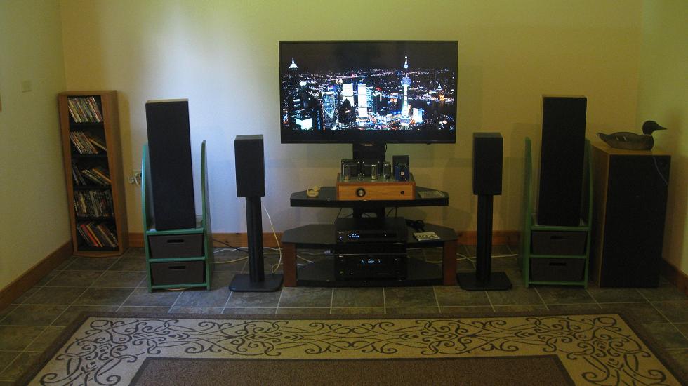

I embarked on a garage re-model project in November, after getting married in October. The man-cave has been a focus lately. (pic attached)
An adjacent work shop has been another part of that project. Still need to move more things from storage and organize both rooms. When will it end??!!!! 😱
Lots of projects like the 3-way/TL are still only ideas. 😱
