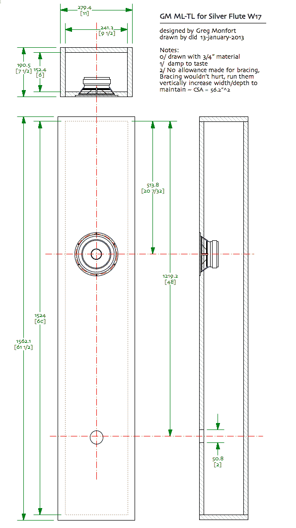

I stumbled across this thread last week and bookmarked it. I just got finished with a small bipole MLTL using the buyout tangband 3" and a rear facing helper tweeter.
I was going to use some of the specs on this thread to possibly build a bipole MLTL using the 4 ohm 6.5" silver flute with the same rear facing helper tweeter.
The gentleman that have used the 6.5 SF, can you let it rolloff naturally with out a crossover and just use a high pass xover for the tweeter?

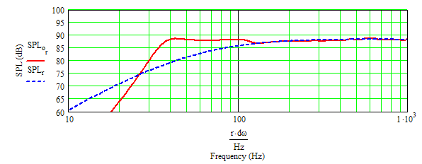

Here are the manufacturer's specs on the 6.5" SF wool cone 4-ohm
(my measurements were similar, IIRC)
The Madisound Speaker Store
There is some break up to avoid at 5 kHz, so no, it doesn't roll off nicely. Also, there is something going on at around 800 to 1 kHz. I used a steep slope to cross over near 800-900. Tuxedocivic uses his below 300.
Up to 600 or 800, the response is very flat. It's not very efficient, however.
hope this helps.
