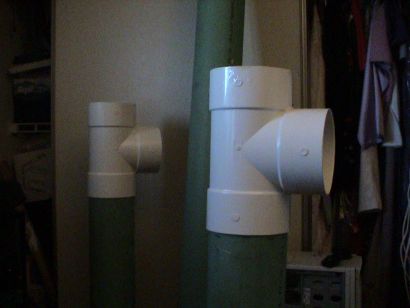

To begin with, have any of you guys actually tried cutting pvc pipe of this dimension? Not as easy as it sounds. I got a bug to make this same design about five years ago... Can't tell you how much PVC I went through while on this quest. I originally wanted to use the corkscrew idea.. I still think it would be a great idea. But much easier said than done. I ended up with many compromises, I basically settled on straight pipes within a pipe. I'll try to attach a picture of them... don't know how well that will work out. Anyway, some details... I ended up using 10 inch high pressure water pipe (the walls are about an inch thick) thinner pipe produced alot of resonance. The speakers are approx. 45 inches tall, and weigh approx. 135 lbs each. The drivers are scanspeak.. I'm pretty happy with the sound, the base is tight and deep, with no bloating. I've never been able to compare them with anything because they are just to hard to move.. should of built in handles.
I had alot of fun making them.. but by the time I was done..I was done..
Good Luck....
steve

steve said:
hi...
this is my first post on this site.. but I couldn't resist putting in my 2 cents on this one....
....I basically settled on straight pipes within a pipe. I'll try to attach a picture of them... don't know how well that will work out. Anyway, some details... I ended up using 10 inch high pressure water pipe (the walls are about an inch thick) thinner pipe produced alot of resonance. The speakers are approx. 45 inches tall, and weigh approx. 135 lbs each.
steve
A) Welcome to DIYAudio.
B) Thanks for the heads up on resonances using schedule 40 PVC pipe in a Transmission Line Enclosure.
C) I don't think those resonances will be a problem here with this design because the pieces are only 6 inches long, and joined at 45 degree angles. Your pipe-within-a-pipe design-I believe a
French inventor came up with that in the 1920's or so, he has been mentioned on this forum- utilizes pieces that are much longer, therefore have less stiffness. Short pipes, joined at 45 degree angles, are intrinsically more rigid than long pipes just as small wooden boxes are intrinsically more rigid than large boxes.
However, people deciding to use long pieces of PVC pipe in Transmission Line Enclosures now know to beware. 🙂
Hi...
I hope your right about your theory about reduced resonance with the short 45 degree construction, I doubt that resonance will be particularly reduced. The resonance peaks at fairly high frequencies, try tapping a piece of PVC with a hammer sometime.. it practically rings. I used mass to deal with this issue.. but there are certainly other options, the most obvious is to surround your pipes with a non-resonant material..
My other question has to do with constuction techniques.. cutting PVC pipe is really much more difficult than you might imagine. Cutting a straight slice out of a 6 inch pipe with a table saw is practically impossible without a jig, cutting at a 45 degree angle will be even more difficult.
My original plans where to build the speakers in stacked sections, one section for each turn of a spiral. Each section would include both the outer border of the pipe with an integrated spraled flute. Each speaker would then be constructed by stacking one section on top of the next. I
0ops... wasn't quite done when I accidently hit the submit key. I still think the idea of molding these fluted sections would provide considerable construction advantages. Actually, now that I think back on it.. I only thought of the segmented construction technique after I had given up on constructing the spiraled (auger) within a formed pipe, and already had most of the form completed.
I have one more small piece of advise to offer on this project.. PVC speakers are not for the married man.. because unless you really.. and I mean really.. disquise them.. they are going to look like sewer pipes. and unless your wife is much more understanding than mine, she won't be happy with sewer pipes in her living room.. no matter HOW good they sound. Trust me on this one..
have fun...
steve
