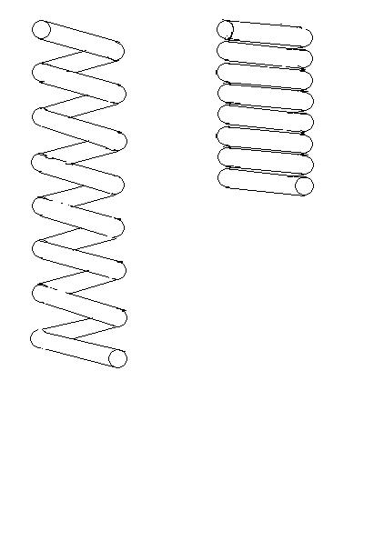

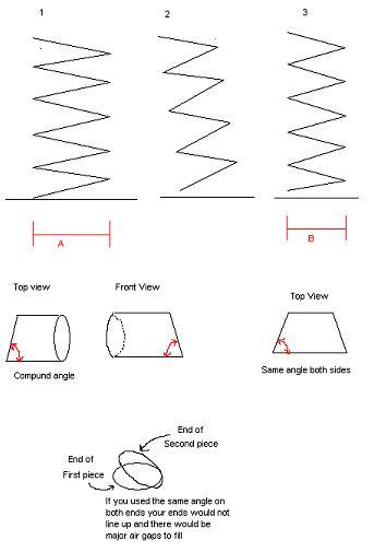

There are potential problems with cutting the pieces like that
When you cut pipe at an angle, the mating surface is now an oval instead of a circle, and when you go to put to two pieces together and then rotate the one to get your pitch for the spiral, it would leave you with an air gap.
Another problem would be that when you started to build and glue the pieces together it would start to slant and the diameter of the spiral would change. As in picture 2. This would be pretty hard to compenstae for.
The way you would need to cut the pipe would be to cut your first angle, flip the pipe around to cut the other end and then rotater the pipe to create a compound angle.
It would be pretty tricky but you would definatly need to make a jig, due to the large number of identical pieces required, and the tolerances they must be held to, to make sure the spiral is air tight.
I will try and draw up some plans for you when i get my cad up and running, Its driving me nuts without it.
Ms paint isn't too user friendly when it comes to trying to represent something in 3d but i gave it my best shot

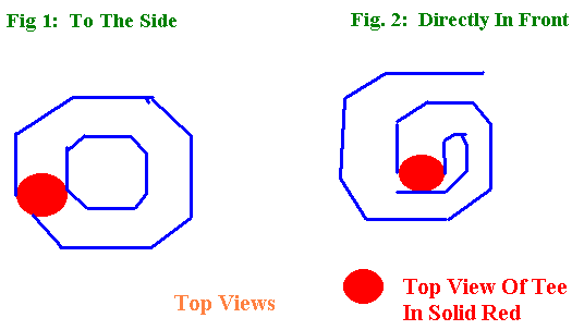

Yeah, that's right. When you rotate the joints, you'll get an offset. With thin-wall tubing, this could be a problem with anything more than 1" segments.
I suggest again drawing the lines on the pipe, but all the way around, like, one every 10 degrees or whatever is needed. Keep track of which one is up, of course (a tedious paper record would be helpful), and you should be alright.
This way, when you cut the segment, it automatically has the correct rotation angle built in.
BTW, may I recommend an octagonal shape? 22.5° each end of the pipe, and about 6" long at the long side should do it. You'd only have 13 segments?

Would you mind explaining that a second time? That way I can be sure I read you right. The first two paragraphs quotes, especially. It sounds like a good idea, but I'm not quite sure I get it.
An octagonal shape might fulfill the expectations, considering that this is experimental.

Just put a lengthwise line every n° around the pipe.
[Geometry]
Like...a circle...put a polygon inside it, where the verticies intersect the circle put a line down the pipe (like the circle is end-on of the pipe).
[/Geometry]
Then you use that 3 1/8" tall board to line up the pipe when cutting.
To get maximum use of the pipe, you can cut two segments with two cuts, this requires a 180° rotation of the pipe of course, so the cuts form an isosceles (whoops maybe I shouldn't have ended the geometry tag up there
) trapezoid.
But since we want a rotational offset on those two cuts, you'll want to rotate (for instance) 10° less, i.e. 170°, each cut.
The lines on the pipe are only for convienience, so you just line up the right line and pop out another segment.
