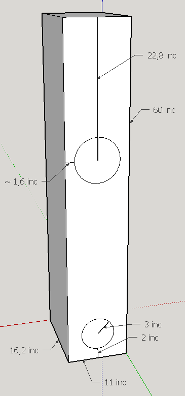

I have made a quick sketch about the speaker. Dimensions are for insides. My concern is the port length. I will be using 22 mm (0.866 inc) thick MDF. Should I change the port diameter and if yes then what would be more optimal? I´m guessing smaller diameter is the right direction, but how small? I would also be very happy to know how this is calculated for future purposes. :eek:
I think little bracing inside of the cabinet wouldn't hurt.
All notes and suggestions about the plan are very welcome and needed.
Thank you.

Vents are normally flush with the baffle face, so if you choose to mount it to the rear, then subtract the baffle thickness from it and if you do a large round-over/flare to the baffle face, don't subtract any length.
In your case then, either doing a 3/4" round-over to the face or backside will get you close enough, though the slightly lower tuning of just a hole will be inaudible in-room, so your call as to which to choose.
That said, I always do, and periodically recommend, that even with a simple baffle hole vent, it's best to go bigger and use a vent tube to adjust tuning in-room at the listening position. Since the next size tube in my locale is 8", the vent would obviously be quite a bit bigger/ longer, so normally I would start by cutting a hole to slide a 6"/whatever tube in and use this oversize for the initial tuning and if I want to tune it lower, then insert a 6"/whatever x 3" and if it's tuned too low, shorten it as required.
Note that there's no need to shove the tube in flush, so leave enough extended to both temporarily seal it airtight and be able to pull it out.

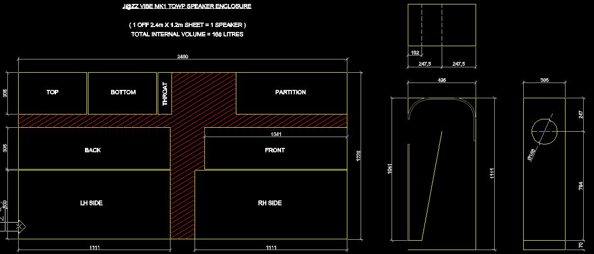

Well after an absence (last time I built some Tqwt's was in the 90's! re. the single driver site) I woke up with a hankering to built another pair. I always championed the "poor man's high end" approach so in tradition sought a cheap driver. After a good hunt I found the Visaton BG20 which from the knowledge gained looks a venerable and popular model. So here i am! Ebay to the rescue allowed me to secure a pair of drivers and thx to old pal and contributor Scottmoose for his kung fu will be building them shortly. I include a CAD plan for any other interest

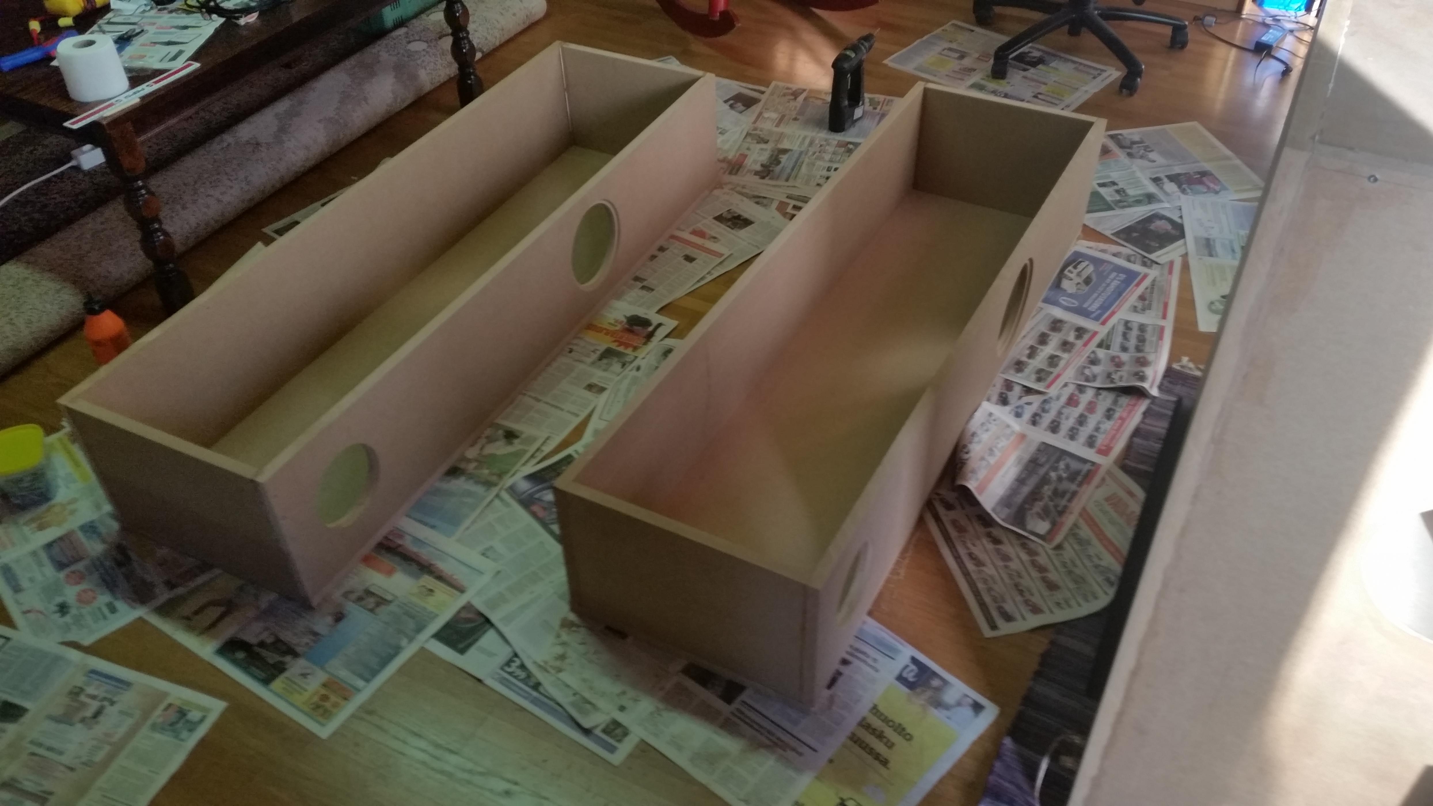

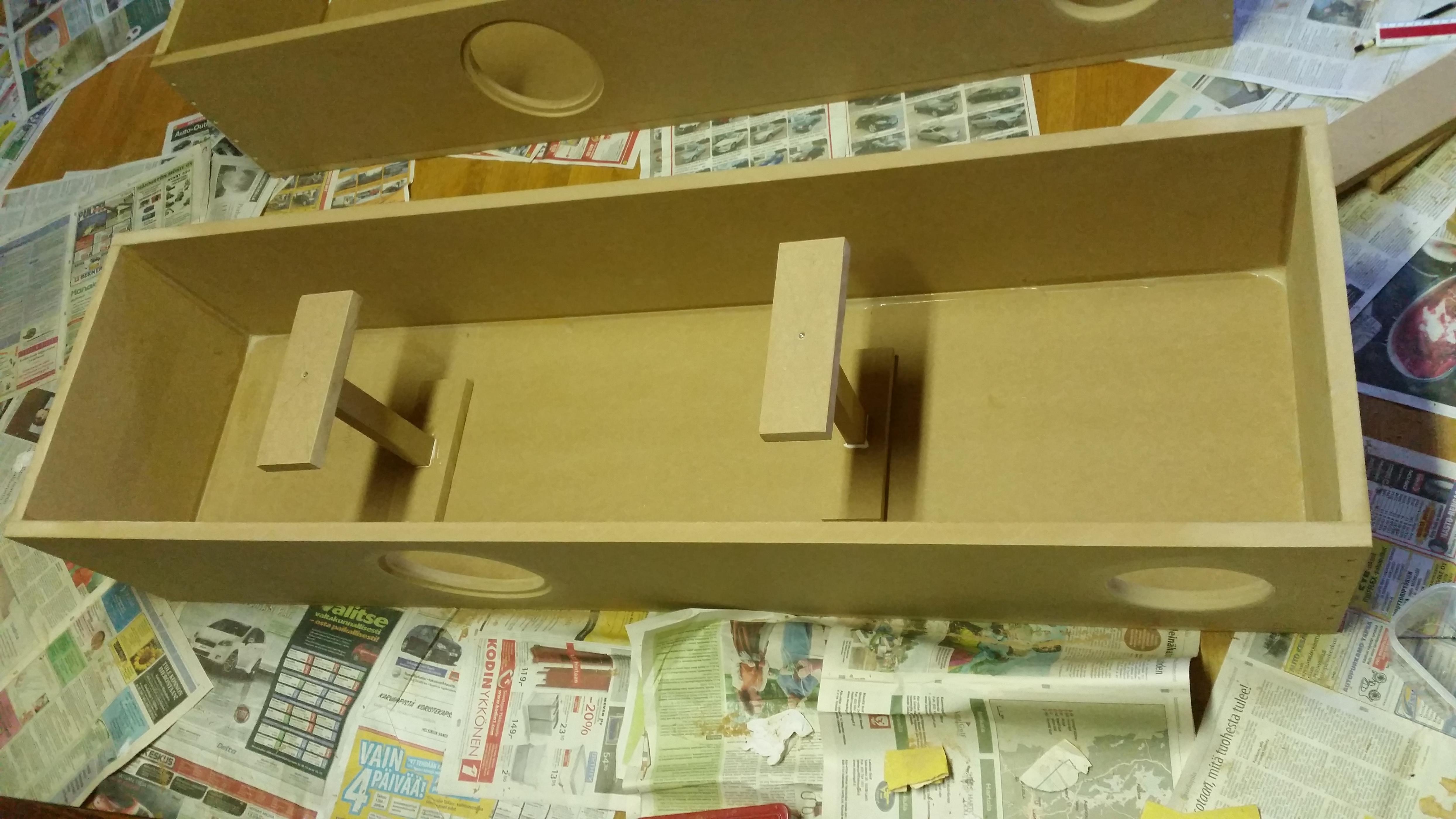

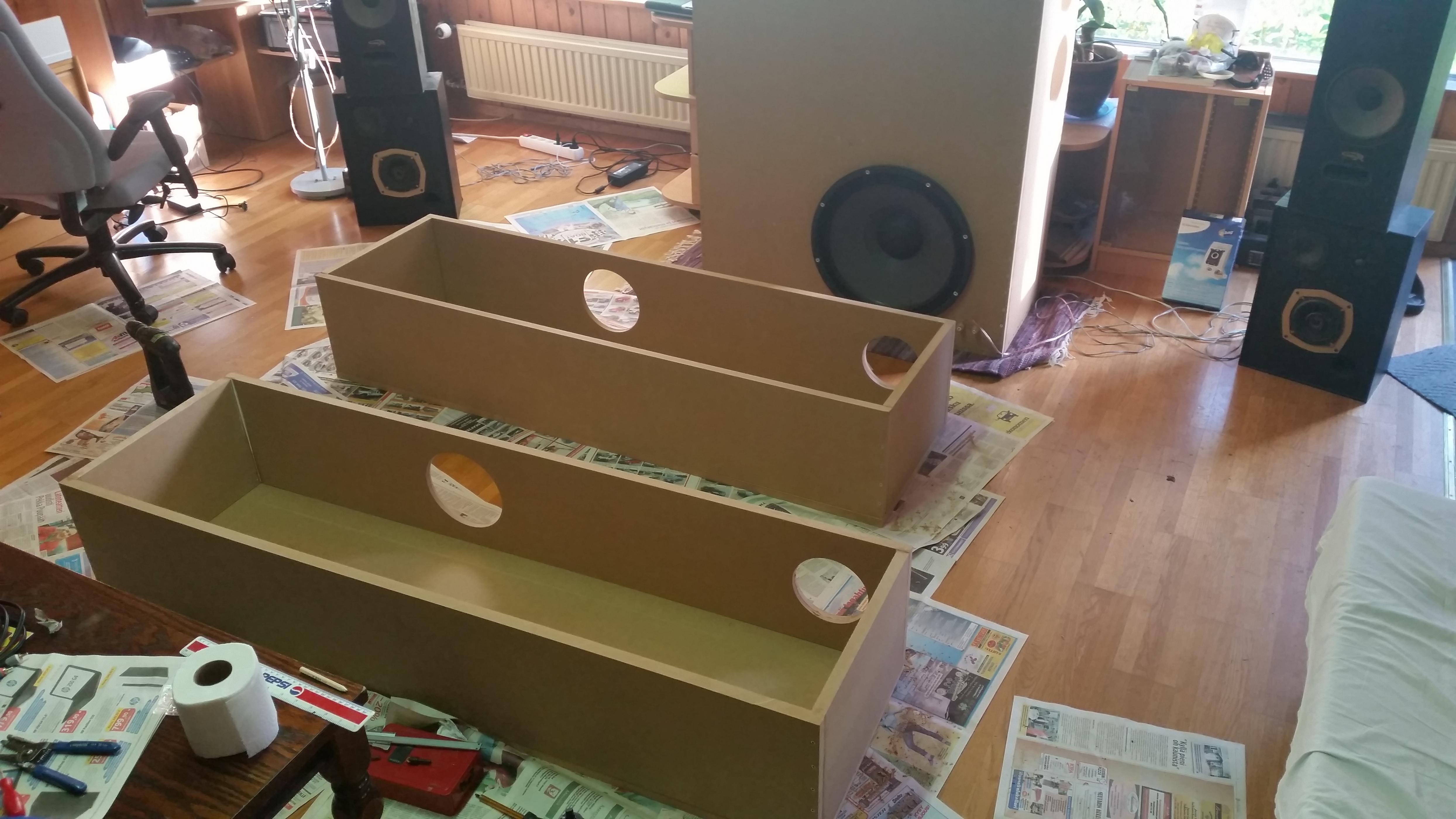

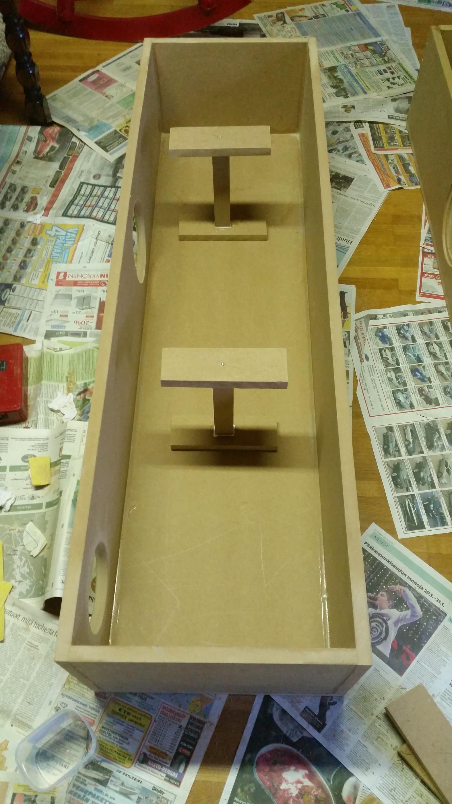

After a long pause the project is again moving forward. After starting the assembly I fully realised the size of the speaker boxes. :rolleyes: I truly hope bigger is better in this case.
I'm wondering how much do I need damping/stuffing material inside the box. Just a little behind the speaker element or gently fill the whole box?
Should I add some kind of bracing? MDF is 22 mm thick, so the boxes are going to be quite stiff and heavy as they are now.

I would think 2-3 "H" braces or "8" braces should be added. To stiffen those large side panels and brace them to each other to reduce their tendency to boom/move on lower notes.
I can confirm that MDF can be heavy. I'm building MLTLs in 25mm MDF. The cabs are now sealed and they weigh a lot. So much so that I'm considering adding carry handles and maybe wheels!
Thanks for the tip. I'm planning to add two braces. One would be 40cm from the top and the other would be 50cm from the bottom. This will leave bit over 60cm between the braces.

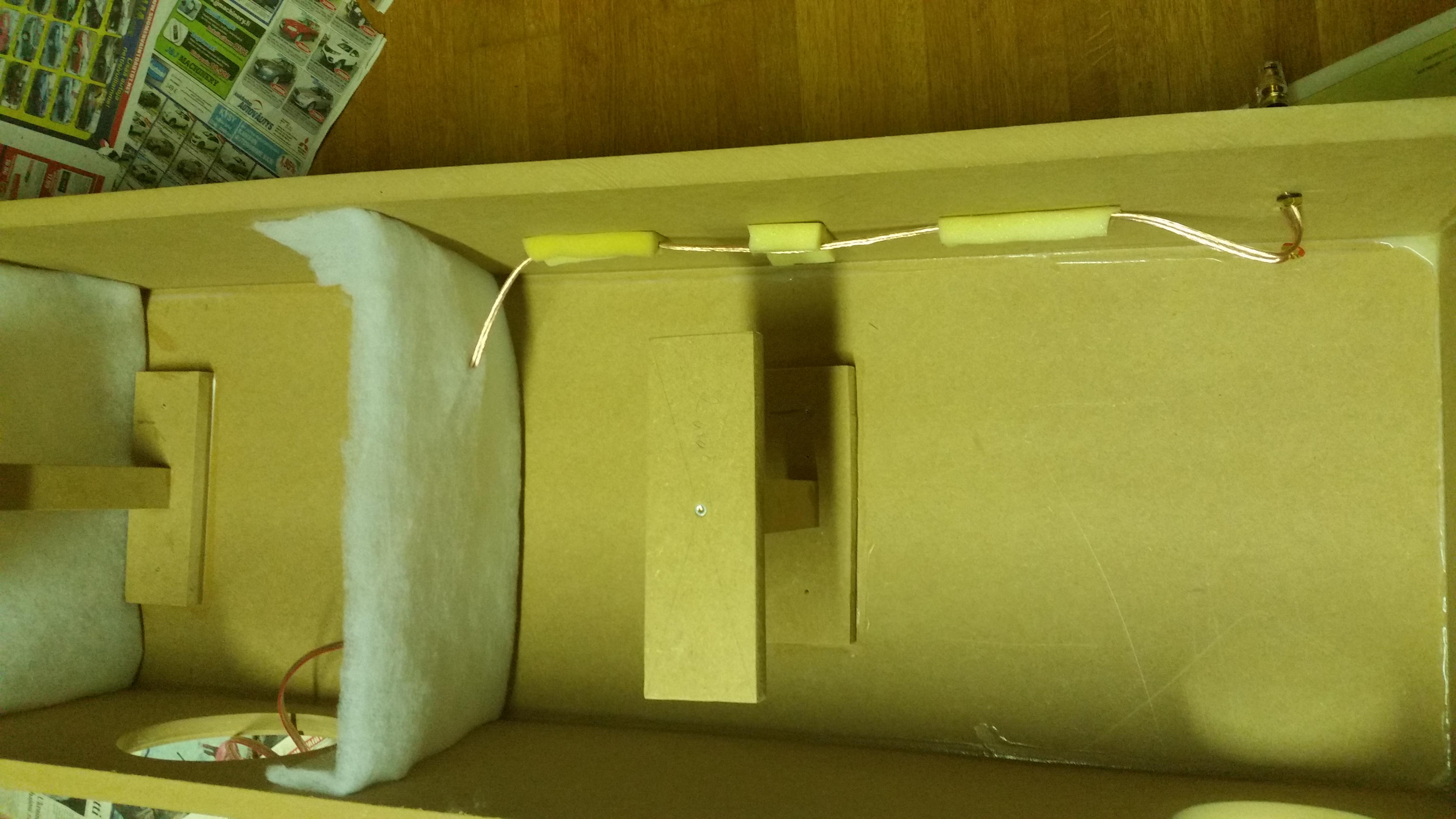

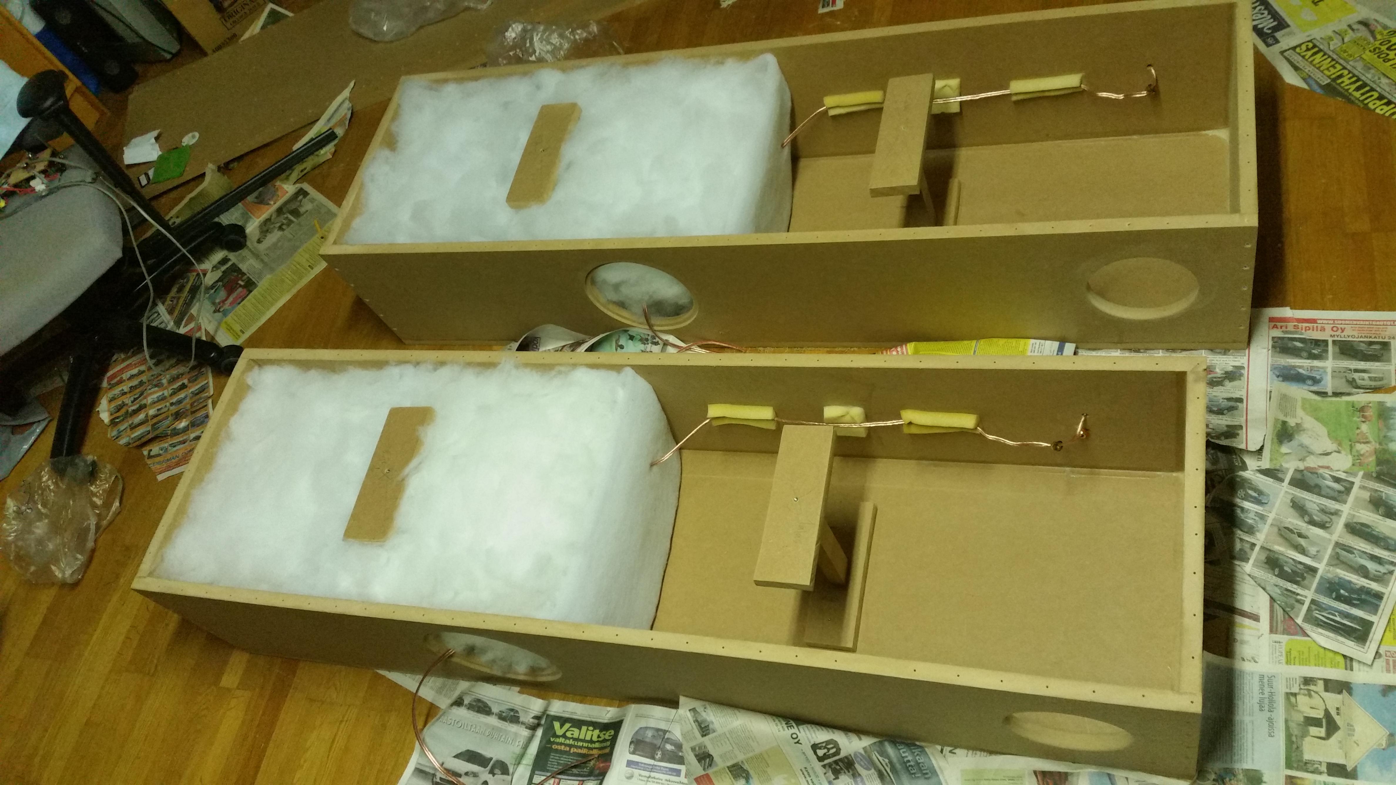

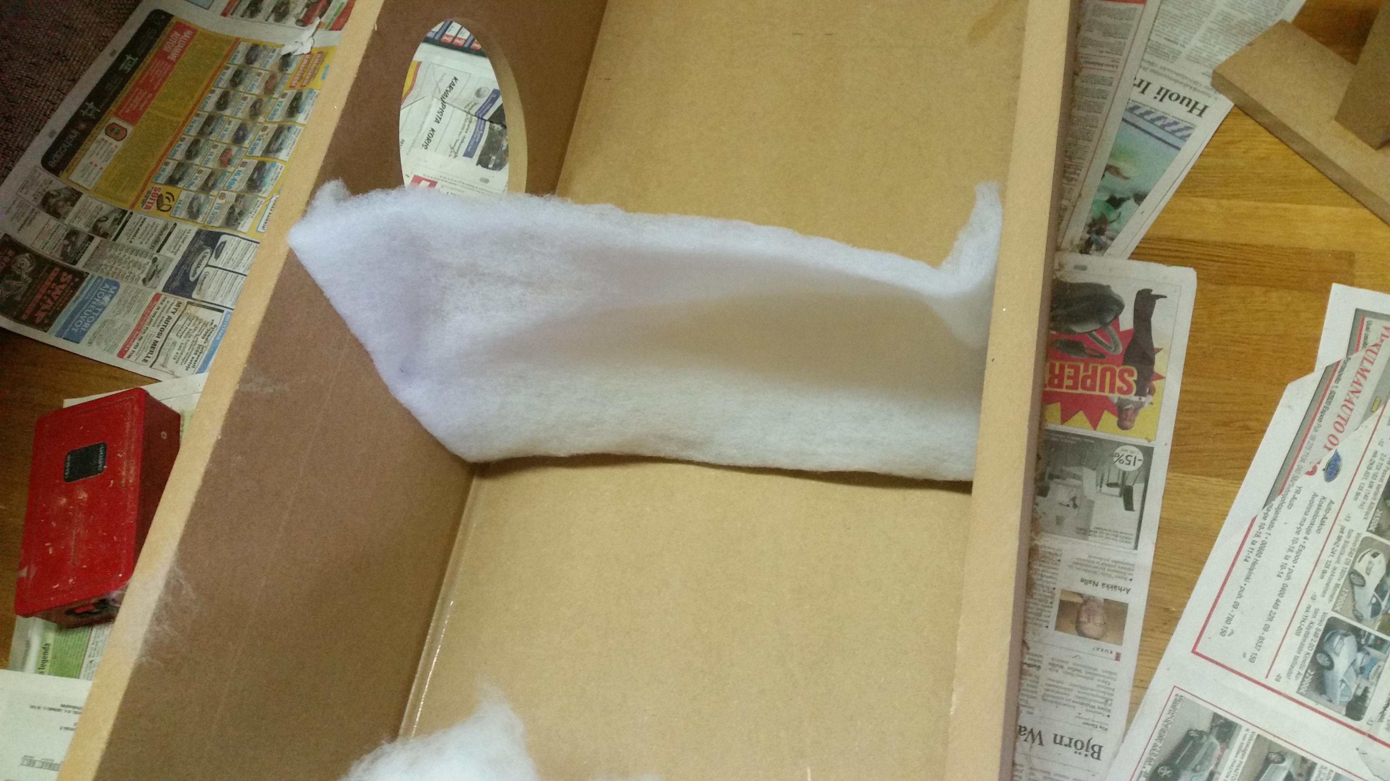

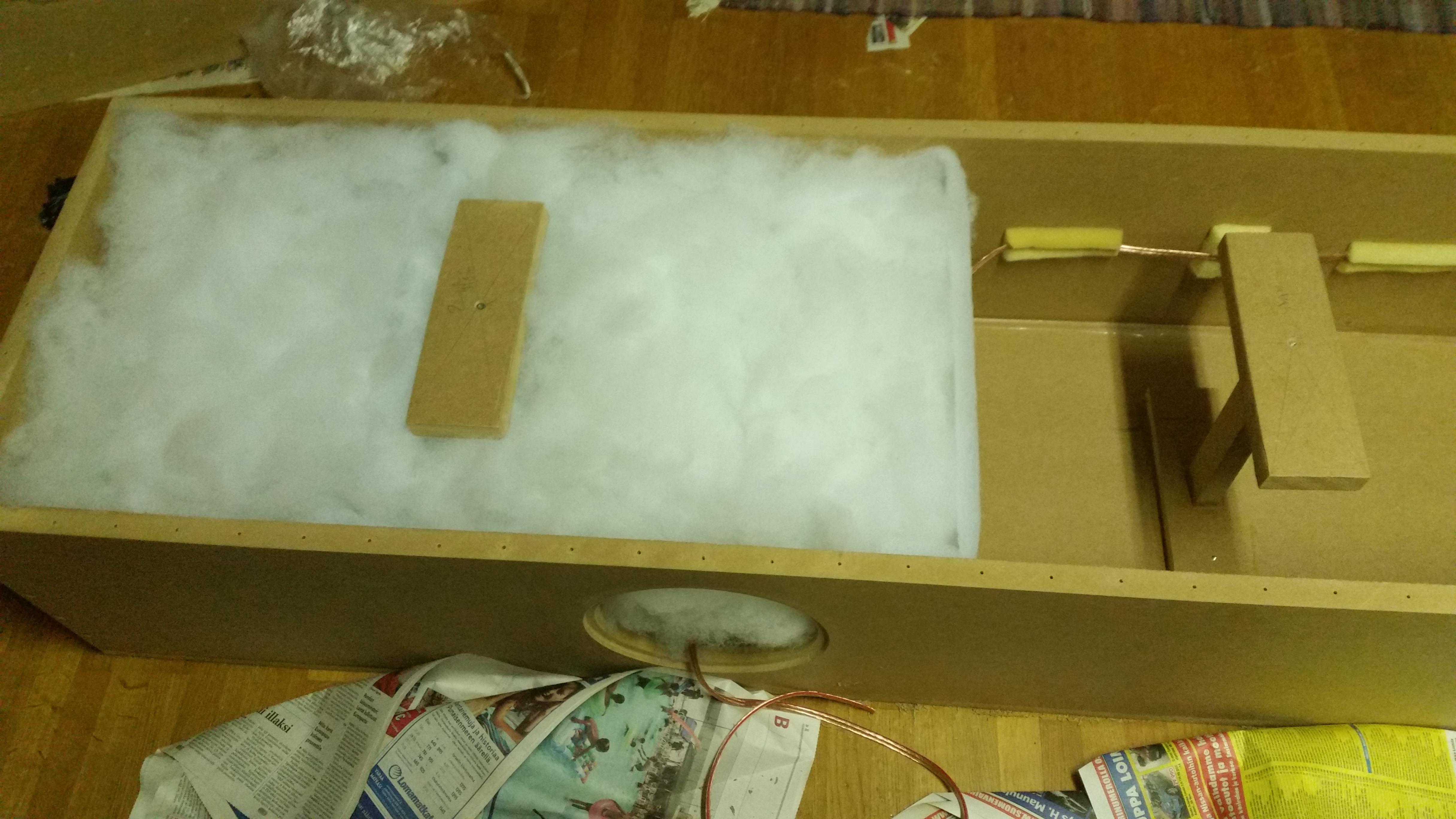

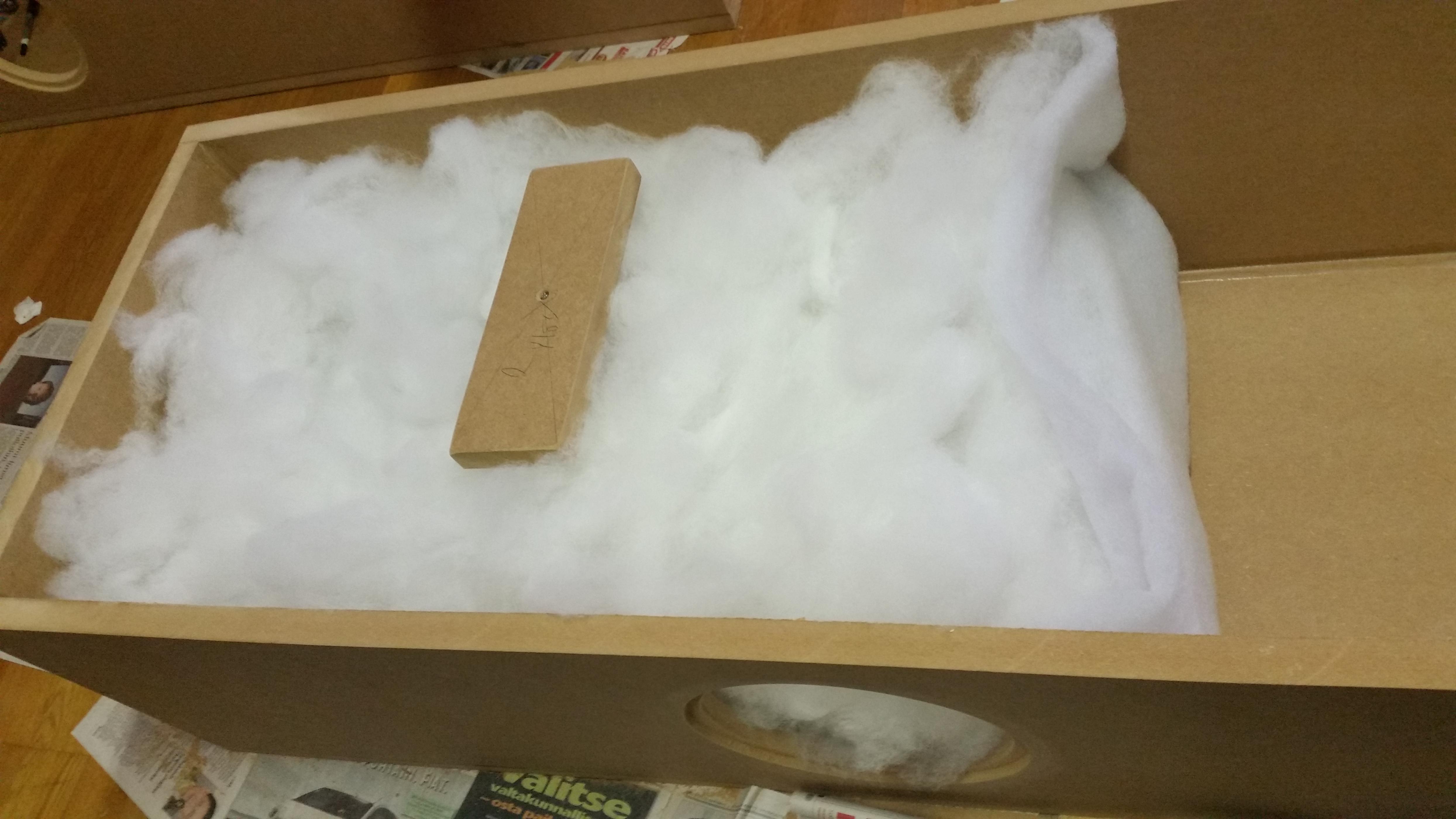

I read somewhere that stuffing should reach from top to few inches below speaker element. I used loose polyester mat to prevent stuffing from falling to the bottom part of the box. I think I will add an another mat and divide the space into two sections. Size of the section is about (70x41x28) cm giving a volume of about 83 litters.
After filling the section very loosely I weighted the used stuffing material. The total for one box was 250g of 100% polyester stuffing.
I really don't have any idea how much stuffing I should use, but my biggest concern is resonant with too little stuffing. After that comes damping the bass with too much stuffing. Oh what a dilemma. :rolleyes:

Based on MJK's work with polyfil, ~0.25 lbs/ft^3 [4g/L?] is sufficient to remove any 'hollowness', damp down any minor reflections above ~300 Hz, so if I did the conversion correctly, then @ 83 L you theoretically need at least ~332.37g.

Delays, delay, this project is taking forever. :(
Some updates:
Added speaker wires and I have now finished stuffing the boxes. I used total of 350g polyester stuffing for each box. I will wrap some polyester mat around the lower brace also.
I think I will be able to close the boxes soon (a week?).
All ideas and questions all always welcome and thank you for all the help.
