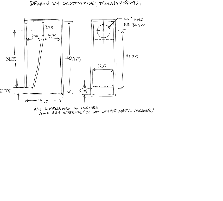

Hi xrk971!
Is it should look like this box with these dimensions or something needs to change?
What is the value of X and Y?
Or box should look like the second picture (Figure 1)

Gost22,
I will try to assist you one last time. Like I said, all the information you need is in post 14 and it refers to the hand drawn sketch you posted in post number 12. The pdf's you attached can't be opened - all I see is black. It doesn't matter we are talking about picture you provided. I guess you want a drawing labeled with dimensions as you cannot transcribe the words in post 14 to the corresponding dimension in post 12.
Here is what Scottmoose provided in post 14:
" -Cabinet height = 40.25in -Width = 12in -Total internal cabinet depth = 19.5in -Throat depth = 4in -Taper ratio = 1:4 -Height of vent = 2.75in -Zd (distance of the centre of the drive unit from the throat) 31.125in -Top of internal baffle centred equidistant from the internal top, back and front -Line the front and top of the box around the fold with damping material. This should be continued for 10in down the back of the enclosure. Adjust to requirements from there. A removable back to the cabinet would be useful to allow easy stuffing adjustment."
Translated to easy dimensions: x, y, z coordinates with x for horizontal dimension, y for vertical dimension, and z into the page dimension (width of cabinet viewed from front).
1. Make cabinet 40.125 inches tall in y dimension (height)
2. Make cabinet 12.0 inches in z dimension (width)
3. Make cabinet 19.5 inches in x dimension (depth)
4. Make the vent gap at bottom (terminus or horn output) 2.75 in in the y direction
5. Make the vent length in the x direction 4.0 inches
6. Make the internal divider panel equidistant from the front, back, and top, meaning locate it 9.75 in from the front in x direction, 9.75 in from top in y direction, and 9.75 in from back in the x direction.
7. Attach the bottom of the internal divider to the end of the 4 in long vent piece at the bottom.
8. Make a round hole or cut out for the BG20 driver at a location 31.25 inches in the y direction from the top edge of the vent.
Those are all the dimensions you need. I saw you asked someone in the photo gallery what the dimensions of their BG20 cabinet was. I would not be surprised if it was very similar to this.
We are all trying to help you, and spending a lot of time at it too. Please try to read this carefully and make an effort to write the above dimensions down next to your picture (provided sketch below). If you continue to ask for assistance but do not make an effort to use or understand what is provided to you, it is a waste of everyone's time.

Definitely happy end. The following procedure for making boxes and making the cross-over to align the frequency response.
See ultimate drawing boxes.😱
Cheers!![]()
Gost,
The drawing looks good. I hope you build it - we are looking forward to the photos and first impressions of sound.
Good luck!

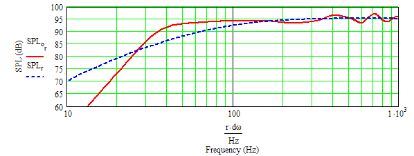

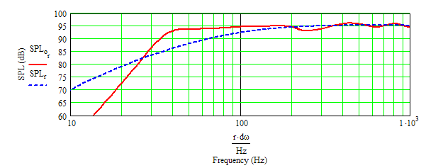

Interesting! This cab has less net Vb, but a larger footprint due to being shorter than my 60" MLTL, so mine has a marginally better LF response, yet in theory the Voigt pipe doesn't have as good an HF response, hence transient response due to being an expanding MLTL with a larger, longer vent.
Once again proving that in the majority of cases a simple MLTL is the best overall alignment.
Both sims are stuffed identically and latest revised driver specs used.
Voight pipe on the left:

For the other, I'm guessing he was asking which of the two graphs in your post was which. My suspicion is that he doesn't speak any English at all and is going through some kind of on-line translation package, so the majority of what we're saying is lost, even some of the simple stuff like that. Let's see if this works:
'TQWT' (Voigt pipe / ML horn) on the left.
MLTL on the right.
MLTL on the right.
