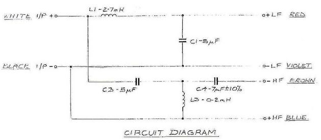

I was wondering about that huge 2.5mH coil with a straight 12.2uF capacitor. With a 1.55mH Le CA22RNY driver, that looks very peaky in the midrange to me. Also the big coil would strangle the life out of the bass unit.
I just couldn't get it to work on phase either. I could be wrong, in which case I've learned something, but bass units like that do 24dB/octave rolloff without much filtering at all.
I managed to get something modelling very well with a 2.8kHz crossover and 3rd order negative polarity tweeter.
I think the bass shunt was about a mere 4uF and 4R with a 2.5mH. Not sure.

Of course we aren't going to be using waveguides, so have to be creative. Dissi dug up this Kef Celeste 3 schematic which does phase well. In practise you need some resistance in the bass shunt arm with high inductance woofers.
I can assure you that the filter works very good, and the 2.5mH is just right with the correct amount of stuffing which I adjusted slightly to my taste.

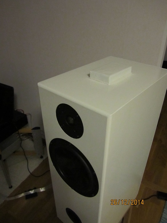

I added this to get rid of some vibrations, it is a box made of a thin aluminum plate and filled with clay, works very well. I think I have reach the limits of the "tired2way", maybe a better power amp can show even more but who knows. It sounds great with the new pre-amp and the amazing Vertere Pulse R cables.
Maybe it could work when stuck from the inside too. Without the benefit of gravity rest maybe not so effective on the other hand though.
Well Salas, while not exactly pretty 😀, it was the best way I could think of. As you say it is just pressed on the top plate (the clay sticks quite ok on the paint). Since I made the cabinet with no experience of how to put things together the most effective way, I got some problems I needed to correct afterwards. I think the box on top works so well that I can live with it.
