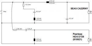

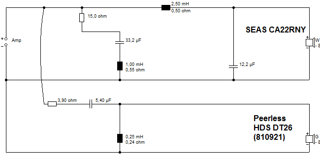

Can I use Seas CA22RNX instead of the CA22RNY? For tweeter Peerless HDS tweeter I think is not available is there a substitute for this?
I haven't looked into alternatives. You got to compare still available or newer from same lines and pick closest in charts and basic parameters. It will probably take crossover values tweaks also.
Ok thanks I will try to look for closest parameters or look from other dealers maybe I could still find it.
"Alternative" for Peerless HDS 1" tweeter is Scan Speak D2608/9130. They are the same. Can't remember the whole history, were they originally manufactured by SS or something. Anyhow, it is the very same tweeter.
That is correct, same tweeter and same price, maybe eaiser to get hold of. From what I know Peerless was sold to Scan Speak and they decided to continue with the HDS tweeter but with their name.

Ok good but the CA22RNY is difficult to source. Any alternative?
Thanks.
Just one google search and I saw it on offer in several places across Europe from UK to Russia. Its smooth in the transition band and the speaker is built around it, better import it.
I'm going to check it. Thanks
I got mine from Europe-Audio, just be sure they have it in stock before you order or it can take a long time to get it if you are unlucky. Available in Sweden too but slightly more expensive.

Tell me Starre, how did you arrive at the 2.3kHz crossover? I think it's the one below, isn't it?
