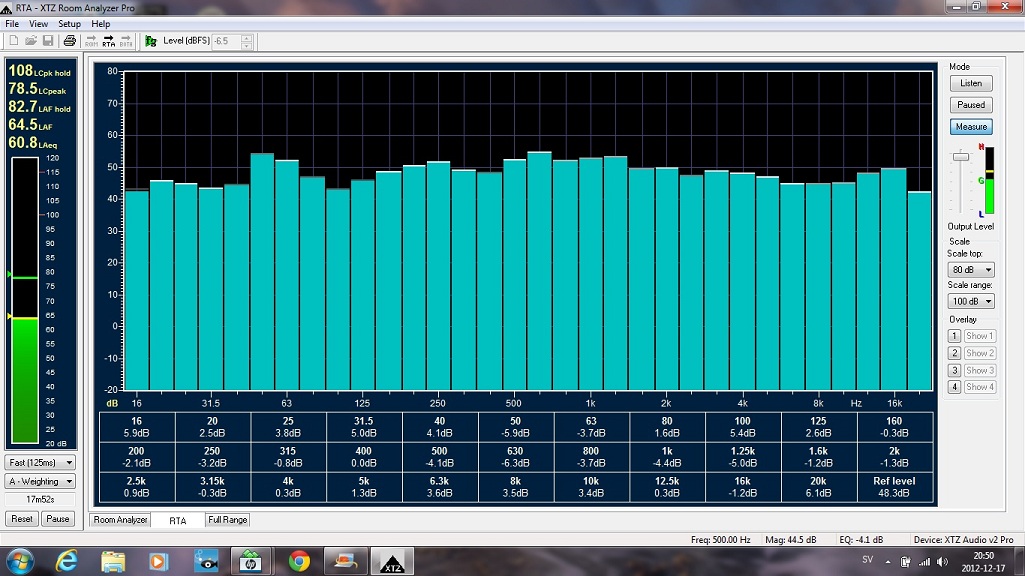

I doubled the amount of stuffing behind woofer and measured like before but I have the speakers a little less toe-in than I used to (since it almost looked the same in my post yesterday).

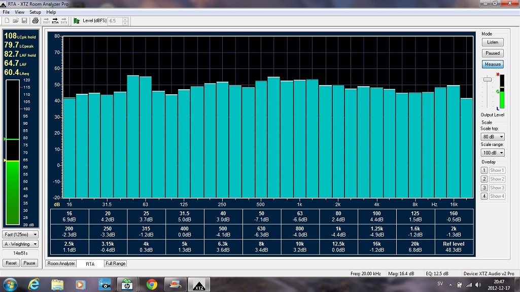

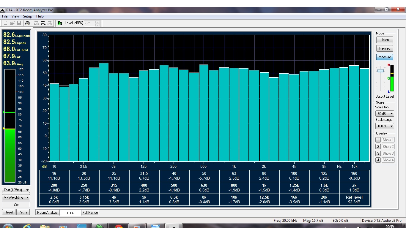

First pic is as mentioned above, second I opened the door to my sleeping room (watch the bass peak) and last a close measuring just between tweeter and woofer at 0.35m distance.
Well it sounds very similar in my ears but it is better when I open that door since that bass peak is less. Maybe maybe a little calmer in middle range but I am not sure. I will try one last thing: trying to dampen walls with all stuff I can get on the walls and measure again, brb.
