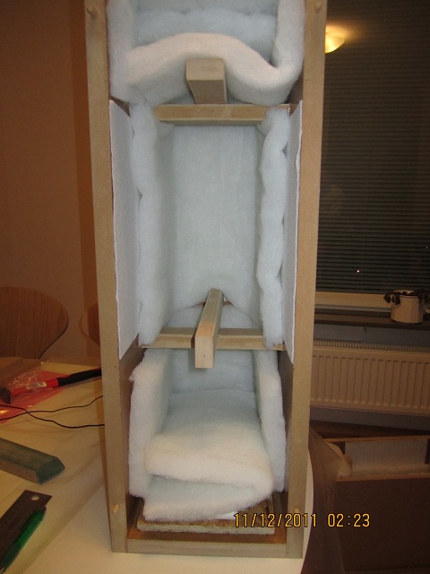

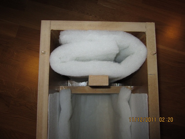

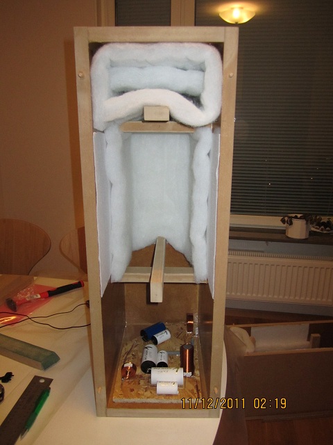

I made a compromise, I put some plaid (2mm) near the woofer going all the way from side to side. This way I have no surfaces without any damping near the woofer, maybe the difference is too small to notice but I hope it will do no harm at least. The first picture show alternative damping with a little less at the top, not sure what is best. The filter is not fastened yet.
Since you need the most nice bass possible, you can start with #3, listen, if not content then through woofer hole reach can go #2 but with just one layer at the bottom, since the proto did not have a big crossover down and the damping wasn't coming up that high near the reflex with two layers. For top stuffing #2 & #3 look fine.
Ok, yes it gets a bit crowded at the bottom with 2 layers, the reflex tube is in contact with the damping just fitting above it. Maybe I should go with the alternative with more top stuffing to compensate for only one layer at the bottom which I think I will start with.

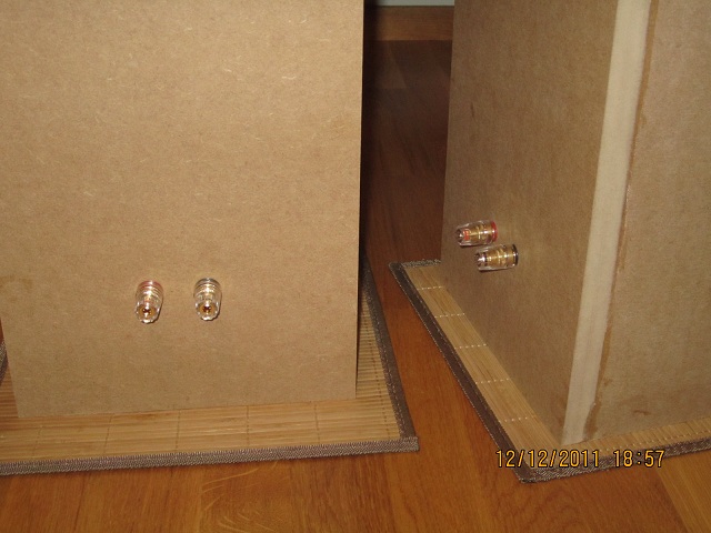

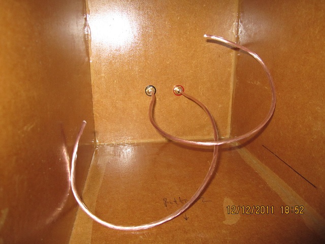

I have installed the speaker terminals today, it took some care since the diameter is not the same from the inside and outside. But it worked out well, see pictures. I am sick at the moment so progress is slowed down, but now the only thing problematic is the choice of color, I have a test colored bit picutre taken with a mobile phone, I will try to post later. When ready to paint I will just pop the terminals out a little to get paint under them, and then secure them from the inside. Using this method with the bass reflex tube too.
Got the flu? Wishes to get well soon. As we humored before, the color is gonna be the only issue in the end. That's when the important stuff went smooth.

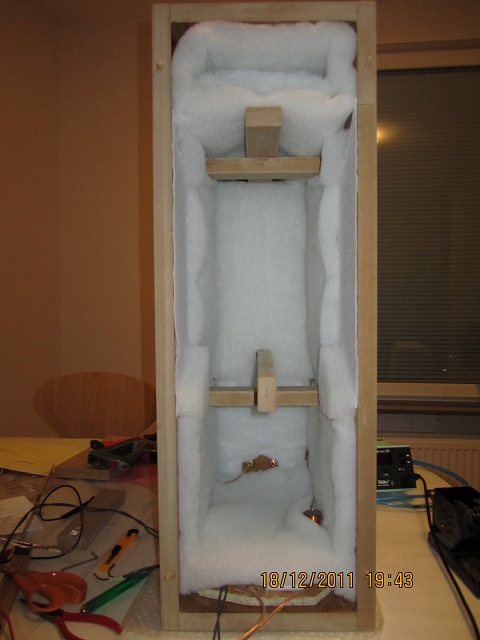

Ok, I did not notice any strange nasal sound when I listened so it is probably ok. I however noticed one annoying thing with my polyester filling/stuffing, it has different thickness, sometimes it is 2,5 cm and sometimes it is 3cm, and I noticed that the filling used behind the woofer going from side to side is now a little thinner than before (I used a different sheet of it when I finally stapled it into place). Maybe I should have an extra 2.5cm piece of filling at the back panel (not including the sides) just in case, I could have it put into place without stapling (it will stay in place without them) to minimize the risk for back-bounce and if it dampens the middle range too much I can remove it later.
Now it is ready I think, there is a little air space between the bottom damping stuff and the bass reflex tube. Should give good circulation around the tube.
I only have one layer at the back behind the woofer, I will start like this.

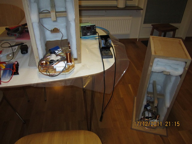

I have to make sure everything is as it should with the crossover since it will be stuck and can´t be removed later. If I build another speaker later I will probably have the filter in a compartment of its own that is easy to access if you want to, but I hope this one will live long and no need to get the filter out for whatever reason.

This is how it looks right now. I only have one solder point left before i can glue the baffle so I am soon ready for putty and sand paper 🙂.
You might want to clamp it up and listen before you "finish" with glue.
